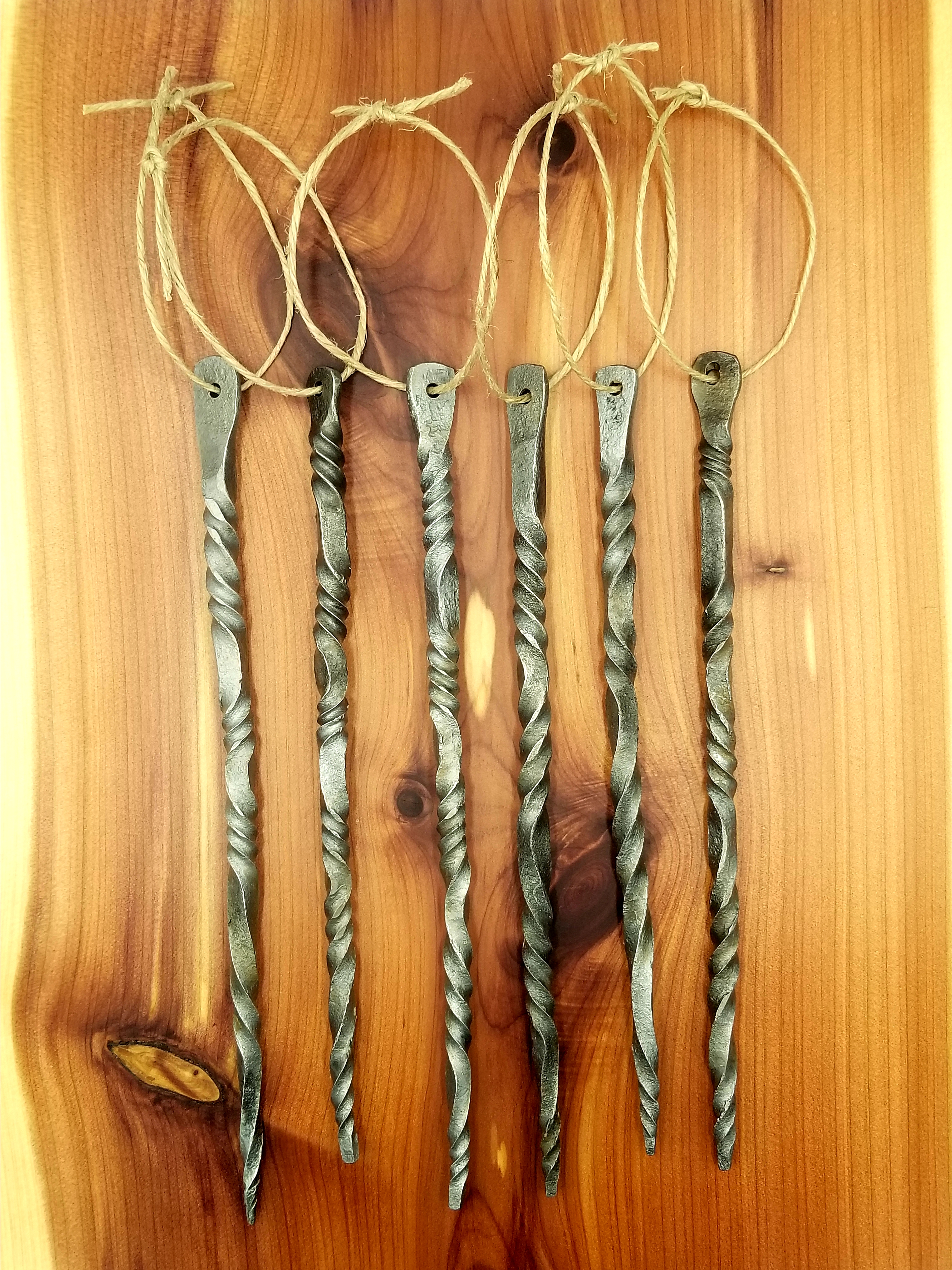

  1. I've been busy not forging much since I last posted. These icicle ornaments were pretty fun to practice longer gentle tapers and play with temperatures for twists - really evident how some twists were at a high yellow and others at an orange. Twisting the skinny points is tricky, as is straightening after twists. I probably could use a good stump and wood mallet, maybe that'll be an upcoming project. Santa brought me no coal, but did bring a box of 50 railroad spikes. I think I'll need to find a good use for those.

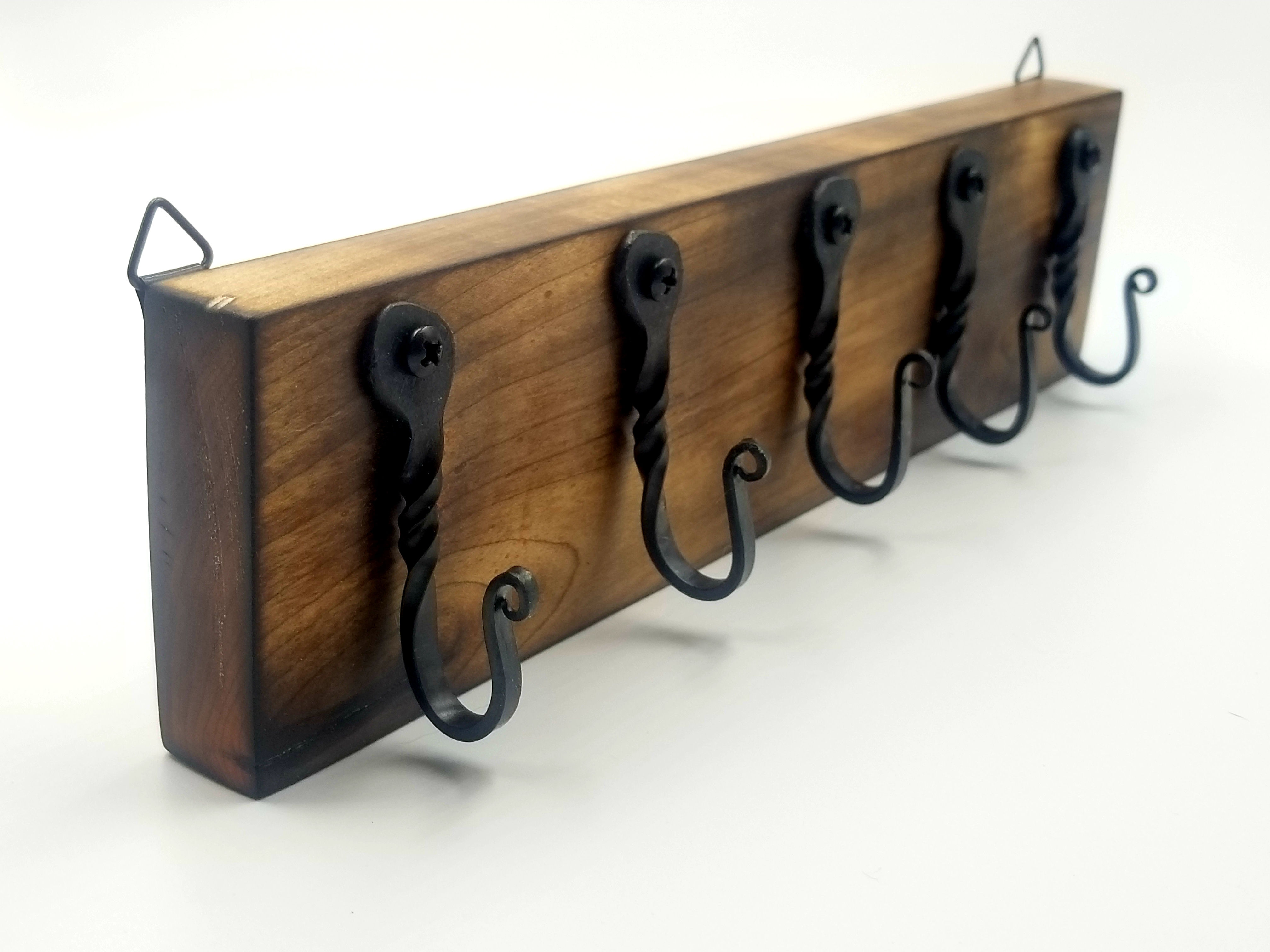

  9. Keys are the intended use. I was inspired by a set of hooks on a key shaped board I got from my wife's great grandma's farmhouse. I've started keeping keys, COVID masks, earbuds, a pocket measuring tape (on a keychain), and a small card wallet hanging right by the door - most useful thing I've put on a wall ever, so I wanted to make something similar in use. The boards are 10 inches wide, close to 2.75 inches tall probably. What I love about the hooks is that small hooks by the door don't accumulate a bunch of junk (like tables near an entryway do) from the household's comings and goings. Flat surfaces are the enemy to organization!

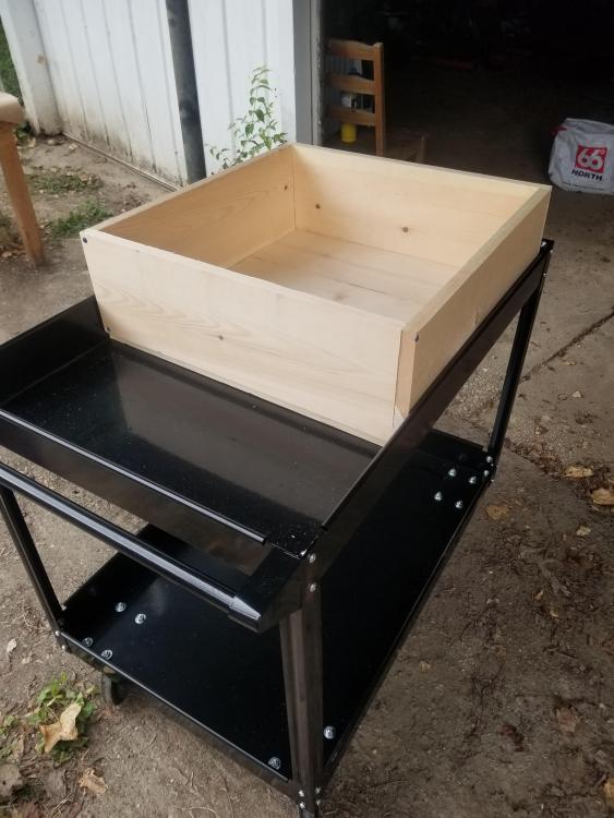

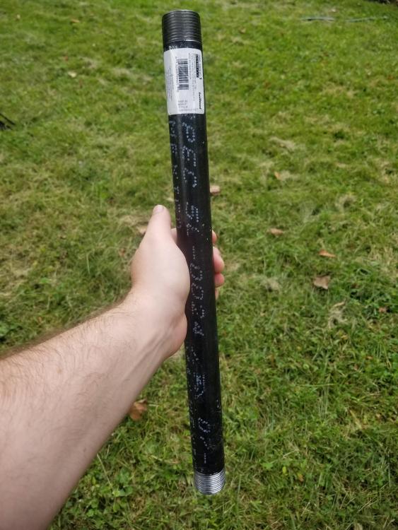

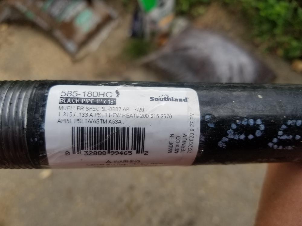

  11. I might not light a fire in it super soon, but I had some spare time today and decided to at least get the box built. Not far along, but I'm happy to share my journey. I'm going to use my utility cart to wheel in and out of storage, seems useful for that so far. The box is about 7.5 inches deep. Maybe more than I need, but using excess I had on hand was nice. I'm going to try to source some bricks if I can find some free ones before drilling a hole for the tuyere. Still scratching my head on substrate. Digging a hole in my small yard might upset my spouse. Also checking for safety - when I hear about black steel pipe as a safe tuyere material, is the below picture correct? It comes with a protective black soft coating of some kind, I think I want to remove that before getting anywhere near heat, right? Thanks to everyone for this website as a resource. I would have been doing something much less fun while waiting for local classes to start up again (probably not until next year) to touch a hammer to hot steel if IFI didn't exist.
  12. Thanks Thomas! The design was from the instructor (probably to keep class to the necessary length) and the hooks didnt swivel.. until I descaled them in vinegar (after riveting to the plate) and of course the joint was loose after losing that material. I had a scrap piece of steel rod that I beat and filed into something kind of shaped enough to set the rivets tighter. I'm glad to have a better solution for future hooks, thanks!
  13. Finally got a piece of cedar that I liked enough to do a burn finish and mount this pair of hooks to. The hooks were done by me (right hook) and my wife (left hook)during a 2hr intro class in February before the pandemic put a stop to pursuing more. I've been making more nail hooks and hope to have some mounted on maple and take some pics this weekend.
