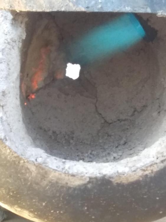

  16. Ok, and a couple more questions if you dont mind, you are helping a LOT. Do I need to by rigidizer for the wool, and if so, where cheaply? Also, I have heard about ITC 100 coatings, but they cost way too much. Do I really need it? And last but not least, at what pressure should I run my forge. Low, quiet heat or high throttle? Anything you have got to say I will gladly listen to.

  21. Hello, I am a beginner smith and have some work to do. I am not super educated on gas forges, but I did some research and built one of my own. It is made of a propane tank canister, 2 in. kaowool, and 1/2 in refractory cement (Meeco's Refractory Cement, from Menards). I know that the cheap cement isn't ideal, but I am on a tight budget, and am no expert. My burner is made from 8 inch pipe, a reducer, a coupler, and the propane end (with nozzle) is from an old weed burner. It has a strong regulator built in. I am open to any and all criticism, thanks for your experience and guidance. I can get some closeups tommorow if you would like. God Bless!
