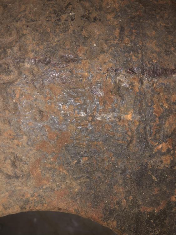

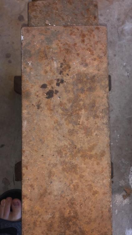

  1. Thank you guys! I had a buyer who was gonna come this weekend for 900 bucks but I’m gonna have to turn him down I think. Also, I want to make sure this anvil gets in good hands and I had an uneasy feeling with this buyer. I’m going to have to move this to the proper thread to list for sale... so is there minor pitting on my anvil? And if so, is there anything I can do to prevent it from getting worse ?

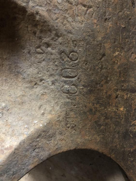

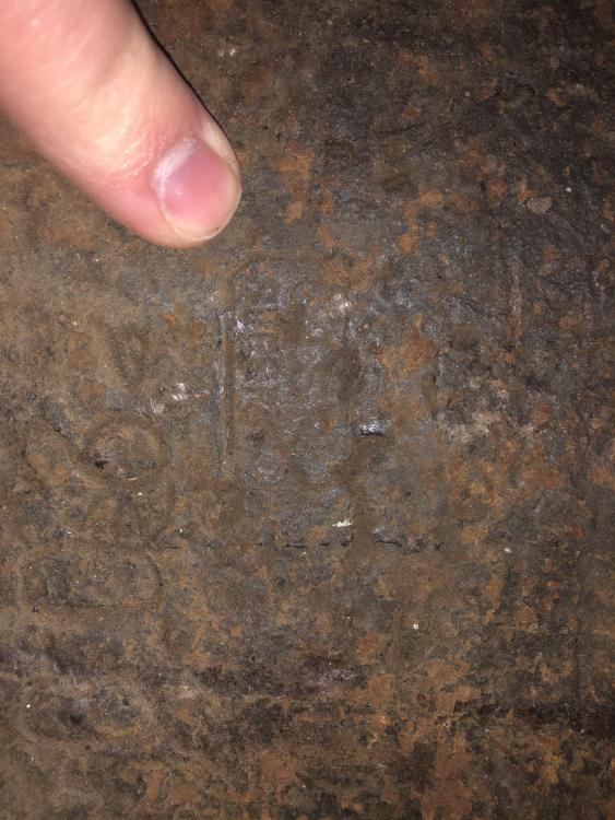

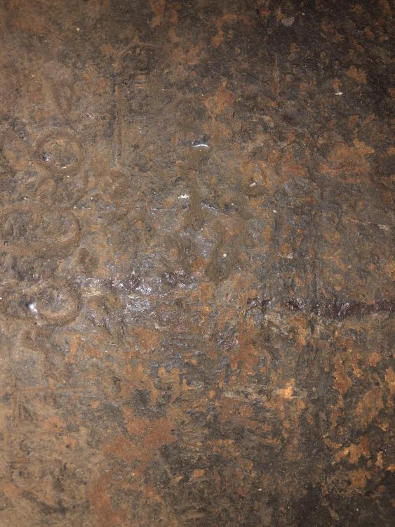

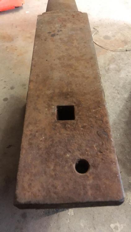

  2. I apologize for the delay, I finally had time to take more pics. I have been selling a lot of tools and other stuff my dad doesn’t use anymore. Supposedly we also have 3 old vices I need to find. The point light and flour was a great idea. The anvil very clearly reads 209 and superior under the right light! Unfortunately there does seem to be some pitting. I suppose the dog in the background is a good indication of size lol. The anvil is 27 and 3/8 long and 12 and 1/8 tall. the face is 4 and 3/4 wide while the feet are 10 and 5/8 at their widest point. In regards keeping the anvil, money is not the problem, the problem is just family drama. I am thinking at the very least trying to convince my dad to sit on it for a while longer as these will only become more rare. My younger brother also wants to keep it so we will see. Aside from that, do these pics help assess the worth?

  5. I am about 20 miles outside of Chicago. Solid 30min drive.
