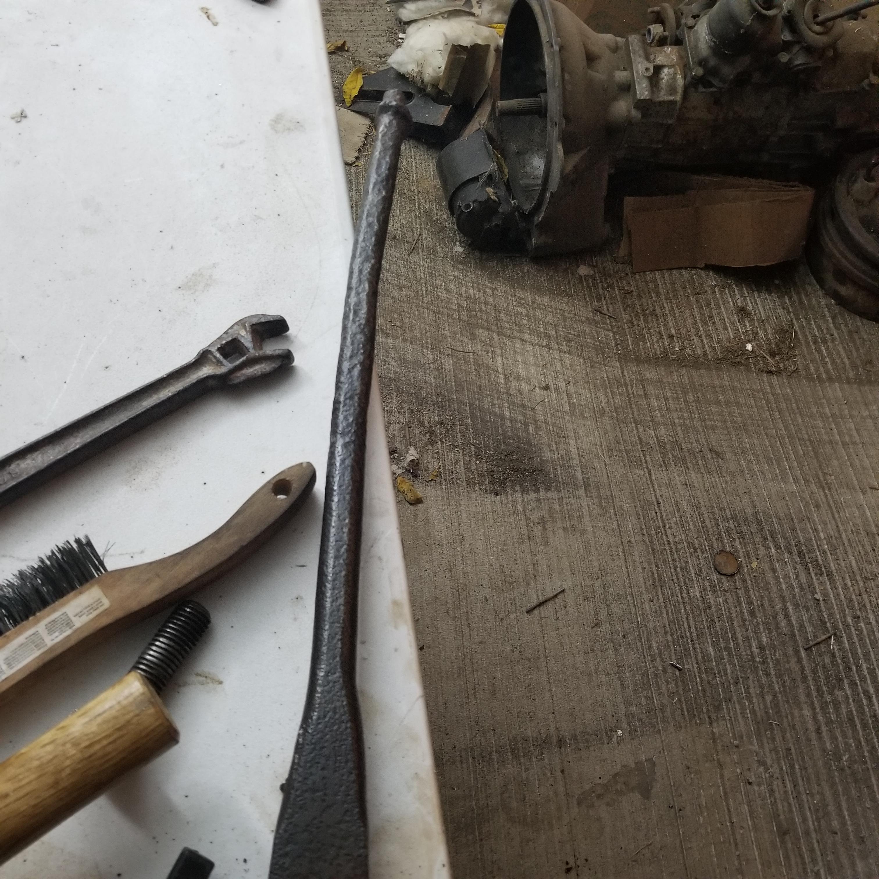

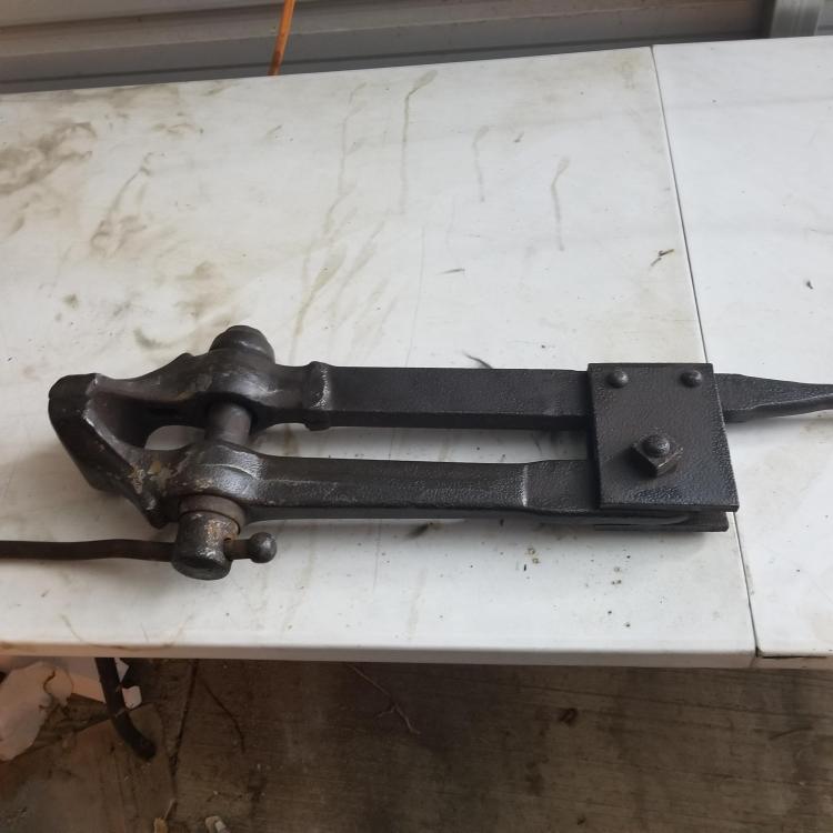

  9. BIGGUNDOCTOR: Good looking vise Wrickm. What is the trans on the floor for? I have a 1978 Landrover (Santana) 109 with a 200tdi conversion. That's a broken transmission and transfer case. ThomasPowers: Makes sense. figured it would be a help in identifying the vise. I think maybe Columbian. Would like to know approx how old it is. Sorry if i offended anyone with my potty mouth. . . .
  10. ThomasPowers, perhaps i should have said distinctive rather than unusual. BillyBones, that sounds like a big honkin pain xx xxx xxx to disassemble lol I straightened the leg, adjusted and welded the pivot plates so the jaws are even (a touch of flap disc grinding to finish that up), greased and reassembled, and it looks pretty snazzy. Need to create a spring and get it on a stand.
  11. Got this post vise for $80. No markings on it other than 50 so we got the original weight. Acme screw and nut seem in good order(maybe short?) . Jaws do not line up. About 3/16 off. Some of that is the pivot bolt. Leg is a touch bent, so going into need to work on that. Unusual features are the square head pivot bolt and square nut, amd that the pivot mount plates are riveted not welded. If any of you fine folk have guesses or info about it let me know.
