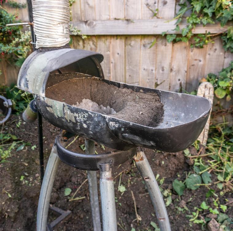

  1. I had a problem with the same thing three times now, to the point where i`ve been redesigning it, this time i am going to try to put the clay a little further forward , proud of the pipe end.. by around half an inch or a little less, I am also increasing the depth of the fire pot in the thinking it will allow any molten crud to drop down below the tuyere pipe, also, my problem seemed to of come from the back side of the fire pot, the bit where the tuyere pipe came in, being too slanted, this seemed to help build up clinker around the top of the pipe and helped to melt / plug up the air pipe...so in making that back side flatter i am hoping it will help drop that material into the bottom of the pot rather than collecting around the tuyere.. fingers crossed...

  3. Now i see what you meant! yes good idea about using it as a "dam" gives it a bit of structure actually good call... This is the problem! im forgetting to add material in front of the steel! ok, ill try lining a good bit of clay in front of everything and trying that next.. cheers..

  5. Hey Goods, do you find you have to rebuild the clay around the pipe a lot?.. what your saying makes sense totally, i dunno, im still scratching head a bit atm, maybe a water cooled setup may be something to look at... hmm more thinking needed, thanks for the input though ..helping me a lot.
  6. Well, i want that big flat face to be the thing facing the fire rather than a bit more tube sticking out, sort of thing... feeding the air pipe through the hub.. hmm, got me thinking now.. I could weld that hub in place and as you said, feed a sacrificial pipe through but wouldn't I run the risk of the air pipe welding itself to the hub? just thinking out loud here, before i move forward on anything lol...
  7. Dug the pot out today, think i spoke too soon, the tuyere melted on me, I know what happened though, it was me, before starting last forge session, i neglected to rebuild the upper portion of the dirt above the tuyere, thinking it would be ok, I will take it as experience and it makes sense now upon reflection as to what went wrong... if I had taken more care in rebuilding before using it again, i think it would of worked out fine. my fault.. so let me recap todays events, dug out the fire pot.. found this... the big old 30mm thick piece i attached to the pipe half melted away, So I have learnt to be more aware of those clinkers building up and eating things! lol... I now have to rebuild this front face, im thinking something a lot larger, not for the thickness but more to stop any clinkers building up or under the face of the tuyere.. I will have to keep on top of cleaning the stuff out and rebuilding the earth/clay etc.. For now, i think i will try this hub i had laying around, with a bit of modification tomorrow i think it can work for what i need, ill probably fill the little holes in with weld and cut that front lip off flush... I will use this at the right time to also cut into the sides of the bottle and make my modifications for holding the work at the right height and level etc.. I shall keep you all posted !.. Mikey
  8. Large truck brake drum? as a tuyere?.. I just used a bit of pipe and then used the thick threaded part from the gas bottle, seems to be holding up so far!...

  14. That is a good idea pnut!!.. I love that extra stump next to anvil for punching and holding work steady! I will keep an eye out for some stumps in the forest i could use thanks for that idea..

  17. Thanks pnut ! .. Its just a matter of using what i could get and making it work as close as i could to the JABOD side blast, Ideally i may need to add some lining to the bottom, but so far, so good!... Mikey

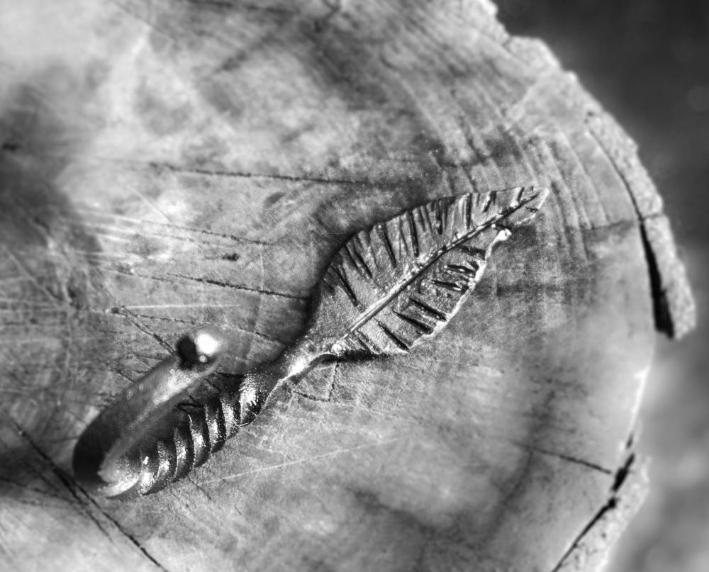

  19. Hi guys!! So I finally got around to registering and making a side blast forge, I had the original tuyere melt on me, so today added some bulk to the end of the pipe, you can see the general idea in the video i took of the process today - Forge modifying... I then used dirt and a bit of clay mixed in to build up around the end of the pipe and back wall which seemed to of worked with tonights test burn! we shall see how long it lasts though.. I will add some pics of the forge itself tomorrow when its light..I will also be keeping a diary here in this thread of my journey into forging but for now here is the first project i made (before the tuyere melted and blocked which got sorted today) and the last picture is the modified tuyere end after a test burn tonight. Mikey-out
