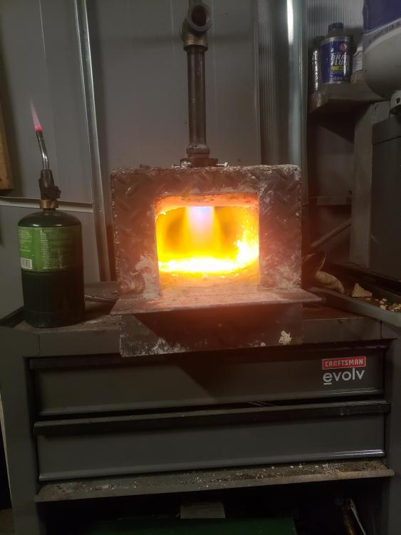

  6. Ok guys new problem I thought I had welded the saw blades turned out I was wroung so I had my steel up to a yellow color and thought that would be wielding temp how can I tell if I'm reaching hot enough temp

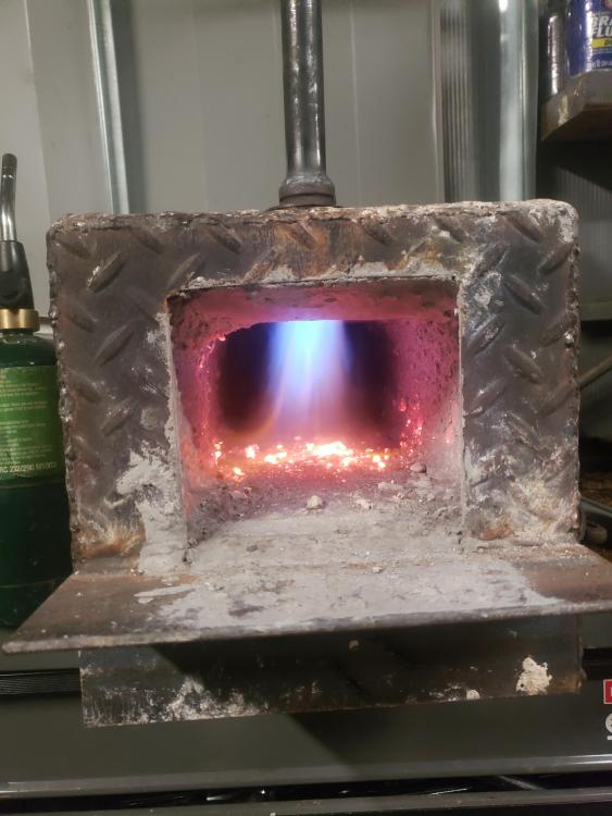

  7. No I haven't forgot about the bricks just didn't have them in the picture lol thanks iron dragon . Frosty yes I welded a couple of 16th gage saw blade pieces together

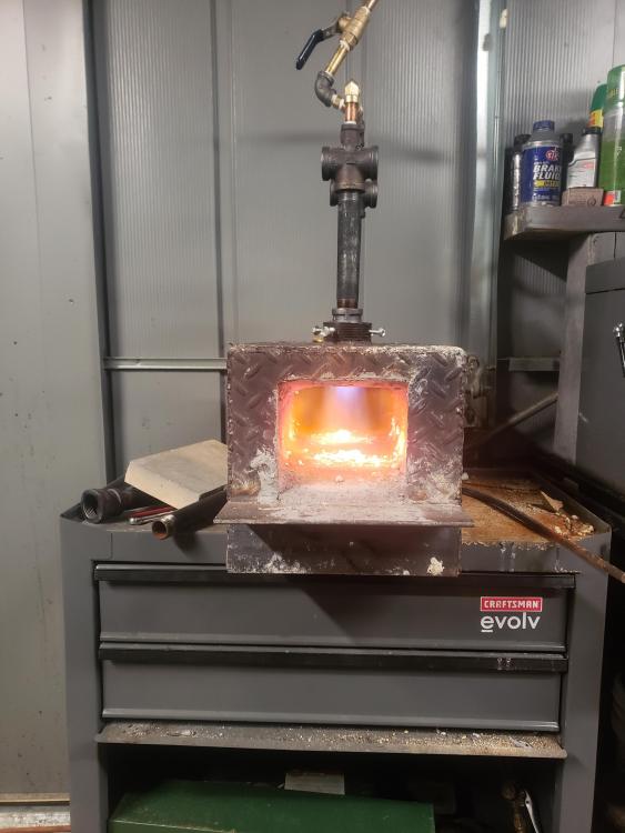

  8. Reach forge welding temps tonight with both burners running awesome again thank you frosty and mikey for all the help.... What would be the easiest material to make my first blade from?

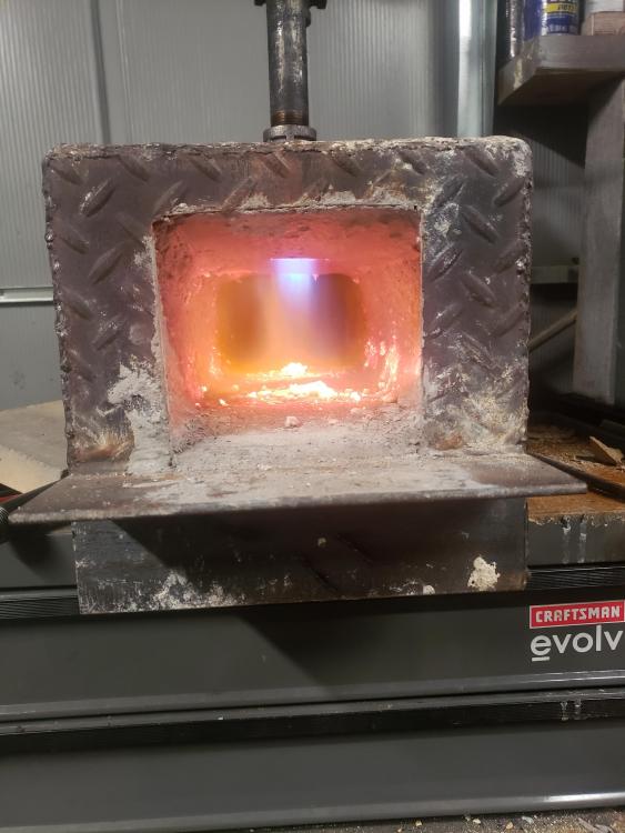

  9. Awesome I really appreciate all the help guys I cant wait to share pics of the future projects I get to forge thanks to you guys
  10. And I thought I messed up lol thanks mikey know I have to finish the second tomorrow and seal the gaps between forge and burner thank you all for all the help will post pics of my future work out of this forge
