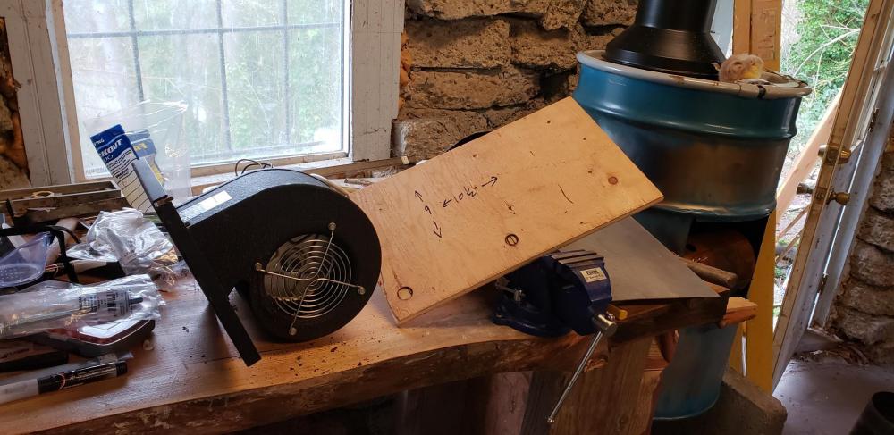

  1. Thank you all for the copious amounts of advice! This new set up works, without a fan even. I still need to extend the pipe outside the building a few more feet, but adding the larger tank as the initial piece of the pipe seems to have done the trick.
  2. Okay, time for an update. BLUF: After reading through all the posts, following Glenn's math and a healthy dose of whiskey I've learned that my current smokestack is not nearly close to capable of handling the forge. Also, I don't have enough material (or money) to go get more pieces of stack. ~~~ Working with the material and equipment I do have, I've mocked up a prototype blower fan exhaust system. It works wonders. Even with the gaping holes in the system (I didn't bolt anything down since it was just an experiment) there wasn't an ounce of smoke accumulating in the workshop. Solved the old problems, now to deal with the new ones. I was able to get the steel (very thin bar of mild steel) to a red/bright red heat. It hammered just fine, but I couldn't achieve anything hotter than that. Conclusion: The exhaust fan is too powerful, and in addition to the intake fan, creates a vortex of moving air that burns the fuel faster than a snowball in the Sahara. Next modification will be to mount the exhaust fan on the roof. Originally I was going to mount it in the rafters, but I don't have the proper mounting hardware at hand. I'll run a straight pipe from the forge to the ceiling, install a 90 degree turn to connect it the fan and attach a spark catcher to the output pipe. Alternatively, there is another idea I've mocked up but don't know how well it would work. Instead of running the exhaust through the fan itself, creating a cut out in the 90 degree bend and blowing across it to create a draft pull. Along with this, I need to find a better input fan. The shop-vac is simply putting air in too fast. If I'm understanding it correctly, the air should be max volume/min speed. The shop-vac seems to be quite the opposite of that. Any thoughts/advice on the new ideas?

  14. While it breaks my heart to hear my first project is probably not anywhere within my grasp (cause I'm still a big dummy) I know I must hold my head high and carry on. I'll take a look for those twist tongs you mentioned. Before I can hit steel I need to get the smoke figured out. Lit the forge and smoked myself right out of the shop. Back to the drawing board on that one. Just started what I thought was a small fire to see how it works. Air blower worked great, fire stayed contained. But as you can see, the smoke stayed inside too
