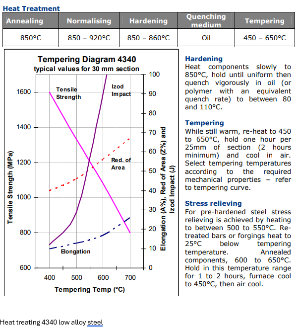

Thanks for the input Goods. Although I asked for a consensus of how hard people recommend power hammer dies I got no specific response. I started a new thread hoping I could focus on the question at hand so I will keep my response in line with that. 4340 only gets to 60 HRC max, if I were able to process it in some very advanced ways. So If I heat treat it at home I will only be able to get it into the range of 45-50 HRC Which from some research I have done online is the right hardness for dies. That is what I mean when I say I want it at the upper end of it's hardenability. is your concern that the 50 HRC would make the 4340 too brittle, or that the 50 HRC is too hard?

I have been working on getting help heat treating a set of power hammer dies I have made. The Dies are roughly 2x3x4 (one is slightly larger). I did some research online and read the posts in heat treating. The following is the process I have come up with that I hope will yield the best results. If there is anything that you more experienced heat treaters see that might pose an issue please let me know. Step 1. Normalize the material to relieve stress. Heat dies to 1000-1022 degrees F for 2 hr. Furnace cool to 850 degrees F at 50 degree drop per hour. Then remove and place in vermiculite. Allow to cool completely. Step 2. Heat dies to slowly to 1550 F, hold until uniform. Quench in oil (I will be using warm vegetable oil) to 200 f. Step 3. While still warm (200f), reheat to 850-1200f. Hold for 2 hours then air cool. The biggest question I have at this point is what temp. is best for tempering. I want this material to be on the upper end of it's hardenability. It seems to me I would want to temper at the lower end of the spectrum. Is this correct.

Duly noted. Sarcasm in response to Snide remark, bad. Calling into question someone’s intelligence because of sarcasm, perfectly acceptable. Threatening to ban someone because Steve doesn’t like sarcasm, good Moving on… The topic at hand is heat treating 4340. To answer Billy’s question I will not be forging it. I picked up a rem of the right size for power hammer dies. I had read that 4340 can be a good choice for that. However there is some question about whether 4340 can be hardened to where it should be for dies. From what I can tell 50Hrc would be acceptable for dies. This would mean I have to get the material to almost maximum hardness for 4340. I am looking for the best process to do this. Thank you for any help.

Thanks for the reply Swedefiddle. Yes I can't rename the topic. 4340 is a heat treatable low alloy steal containing Nickel, Chromium, and Molybdenum. The steel is supposed to have great fatigue strength over time. It is also supposed to max out around 60 HRC. I miss quoted earlier when I said Flame hardening. Being as that I don't know what xxx xxxx I am talking about and came here for help. What I should have stated (thanks Steve for being so helpful, yes that is sarcastic) is Flame hardening can get up to 50 and Nitriding can get you 60. This is taken from Techsteel.net: After tempering, flame or induction hardening will produce material with Rc 50, while nitriding will produce Rc 60.

Patrick, thanks for the information. I have read online that I can harden 4340 up to 60HRC. Some say I can get 45 HRC with quenching, Then flame harden up to 60. Do you think this is achievable?
