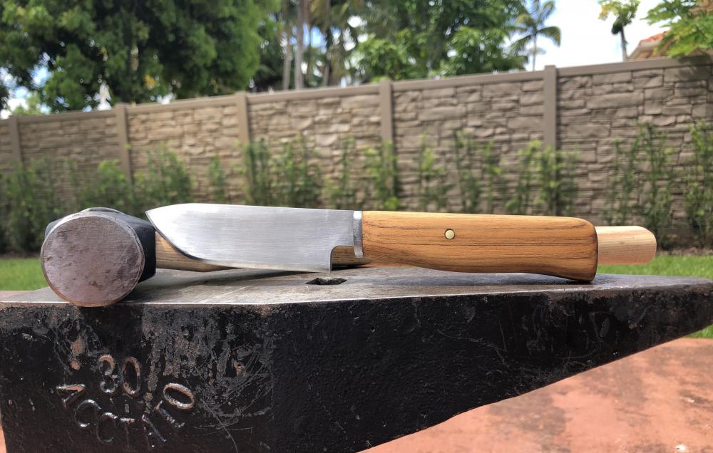

  1. I quenched in vegetable oil at nonmagnetic and then put it in the oven at 400 for two cycles about 3 hours each. Thanks for the suggestion on the grinders I'll look into some of the 4x36 grinders. I've been trying to look at some 2x48 grinders but most are fairly expensive.
  2. Hey everybody, I just finished making my first knife. I had an awesome time and learned a lot along the way and am looking forward to my next build. I’d love to hear what you guys think, what you like or don’t like about it. And especially how you think I can improve it. It’s 1095 steel with a brass pin and teakwood handle. PS. This is my first attempt at making a knife. It was a lot of fun and learned a lot. Still have to bring the edge up to a fully sharpened but I’m awaiting a sharpening stone. I used a small 1x30 inch belt grinder and is severely under powered and I could only source 80 grit belts, so it was chore to get any significant scratches out. I would love a suggestion for a more professional belt grinder, that would be suitable for my needs. Which will probably be smaller knifes but possible a sword in the future? Thanks in advance.
