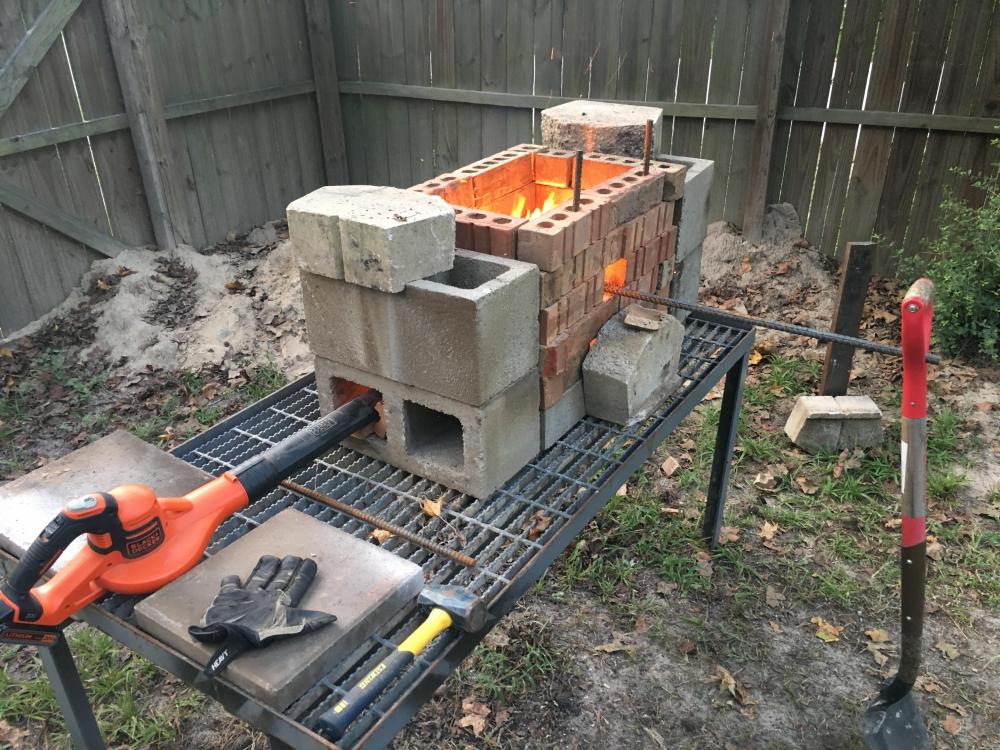

  5. Here is a pic of the interior of my brick forge. The larger circled part is my coal bed area and the smaller circled part is the side blast hole that goes under my coal bed grill. Hopefully this gives y’all a better idea of what I am working with.
  6. I am forging knives from schedule 60 rebar and some older scrap from tools and car springs usually the pieces are around 7” long at max. I use an electric leaf blower that honestly puts out a ton of air and yes the fire is HOT. The coal bed is inside a brick housing on a wire grate and the air comes in under the coal bed from the side. This one is made of an 80d nail
  7. I run a side blown Brick forge using solid oak lump coal. For every 3 hours worth of work I use about 10 lbs. is that too much fuel? How much would you say is a proper amount of fuel, as I can rearrange or rebuild my forge to be more efficient?
  8. Fire beast!!! This was before I narrowed the forge interior with blocks down to workable size of 4”x6”

  10. Thank you all so much for the feedback! I admit I go through cowboy coal rather quickly. I built the interior of my forge to be changeable by removing certain bricks my fire can go from 4 inches wide by 5 inches long up to 16 inches long and 4 inches wide. The air flow goes in through the side under the grill part where my coal sits. I plan in the next month or so to build a propane forge with fire bricks but wanted something I can work with on a budget. So far the only thing I’ve paid for is a few bags of lump charcoal, and an ASO. The blower, the bricks, the table and the tools were all scrounged for or given to me by friends. Thank you again for the feedback. If you have any ideas on where to find cheaper fire bricks that would be great. $40 bucks for 6 thin blocks seems ridiculous.

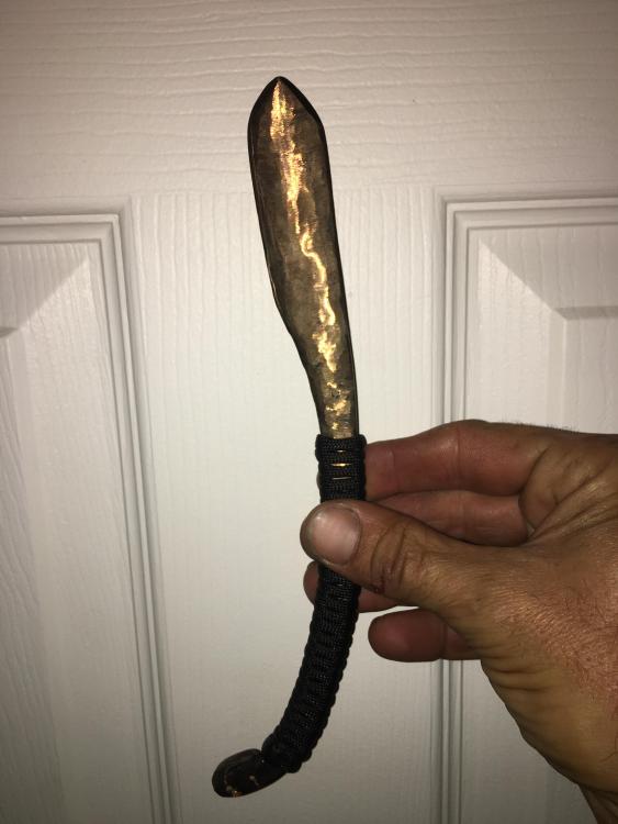

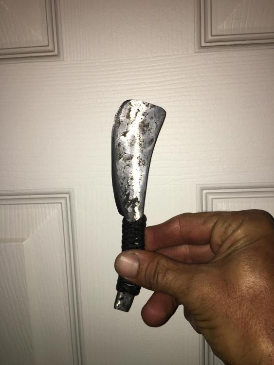

  12. Hello all, I’ve been wanting to build my own forge for about 5 years now and finally moved to some property where it’s not forbidden. So I bought an ASO and grabbed some Bricks and started trying my hand at this fine art. So far I started small with a few knives. Here is a mini cleaver I made to practice drawing out and squaring it’s made from some 1/8 inch 60 grade rebar. And here is a blade I made not sure what you’d call it but it slices well. And last is a pic of my humble forge. Any feedback would be well appreciated. Thanks
