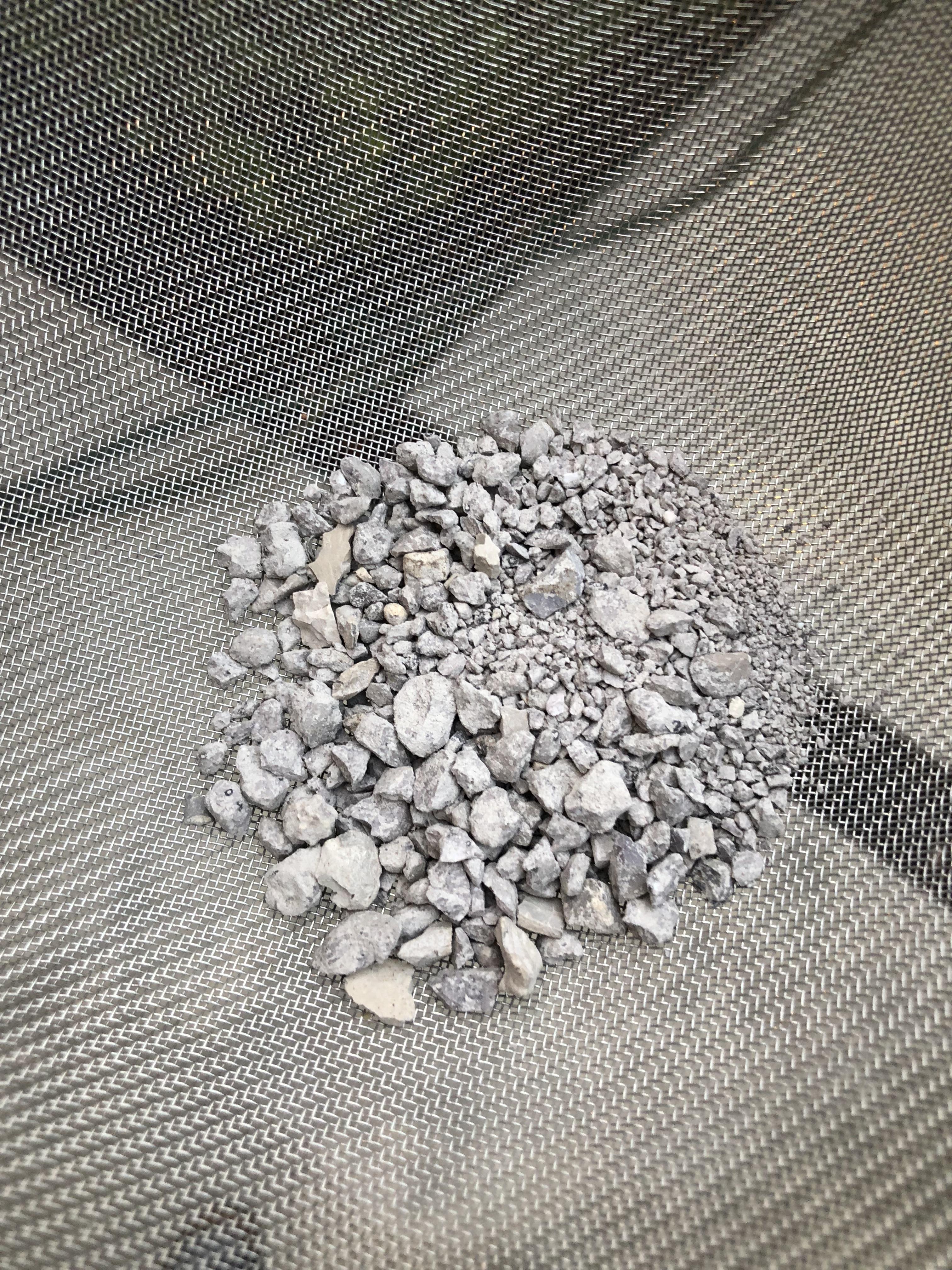

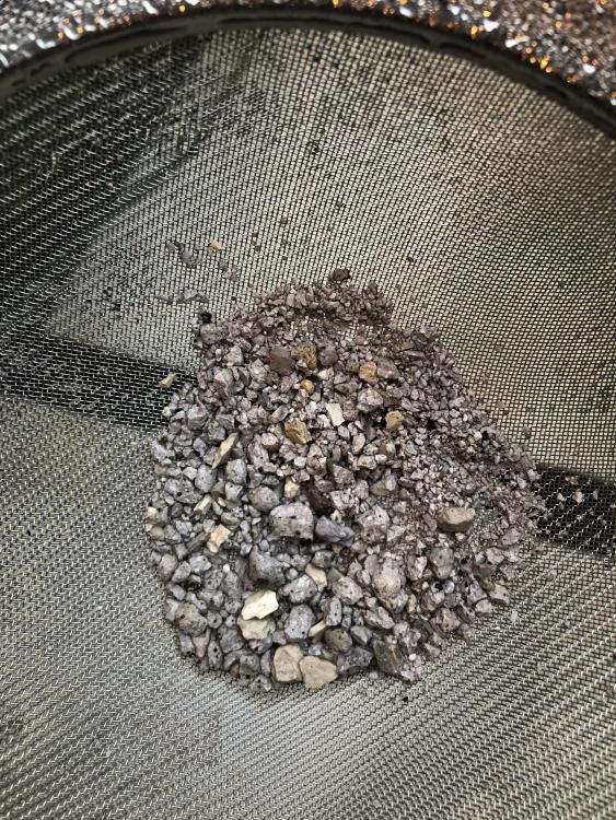

  3. UPDATE! Looks like it isn't grog. Here are some photos of the aggregate sifted and washed.

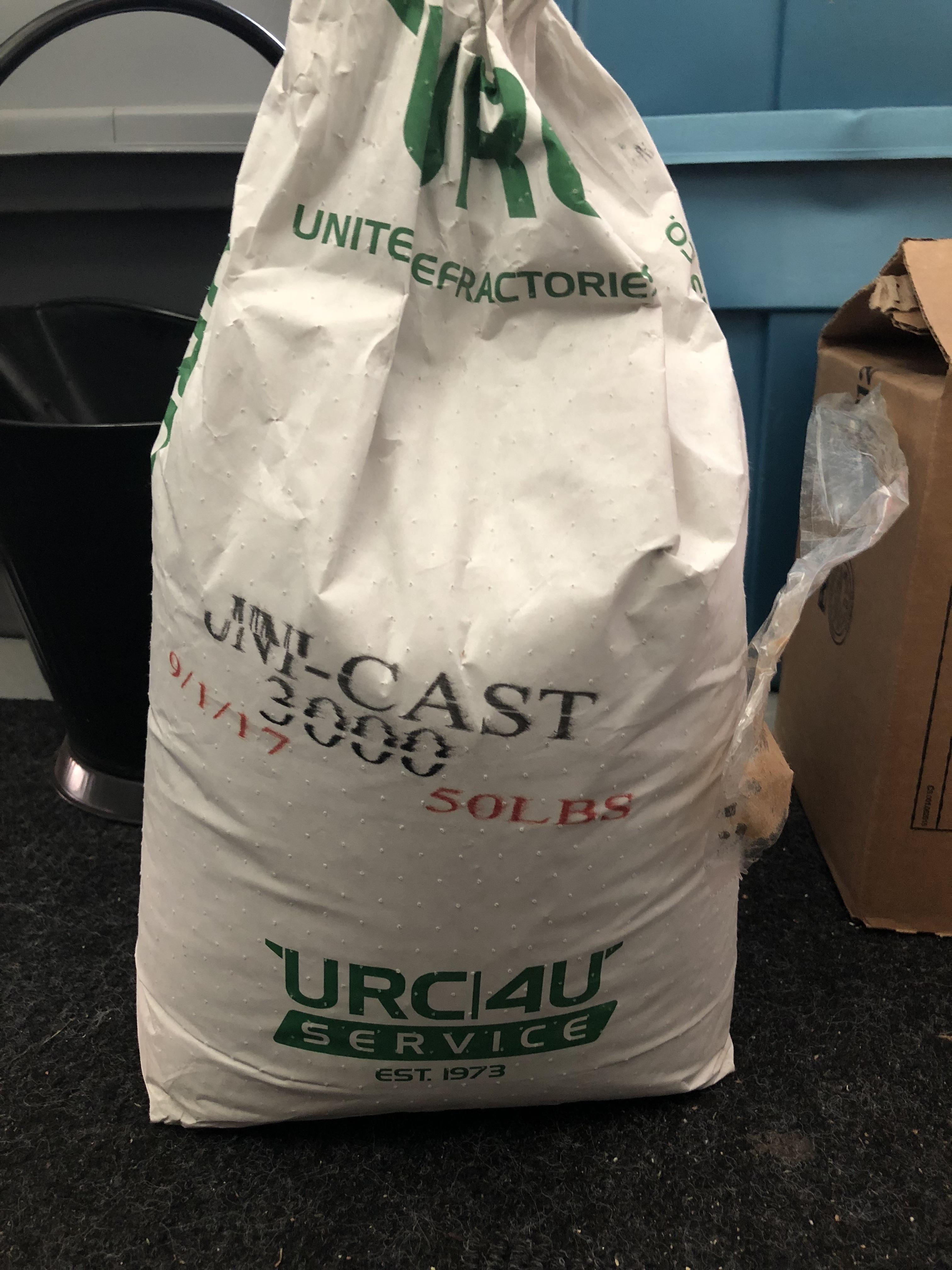

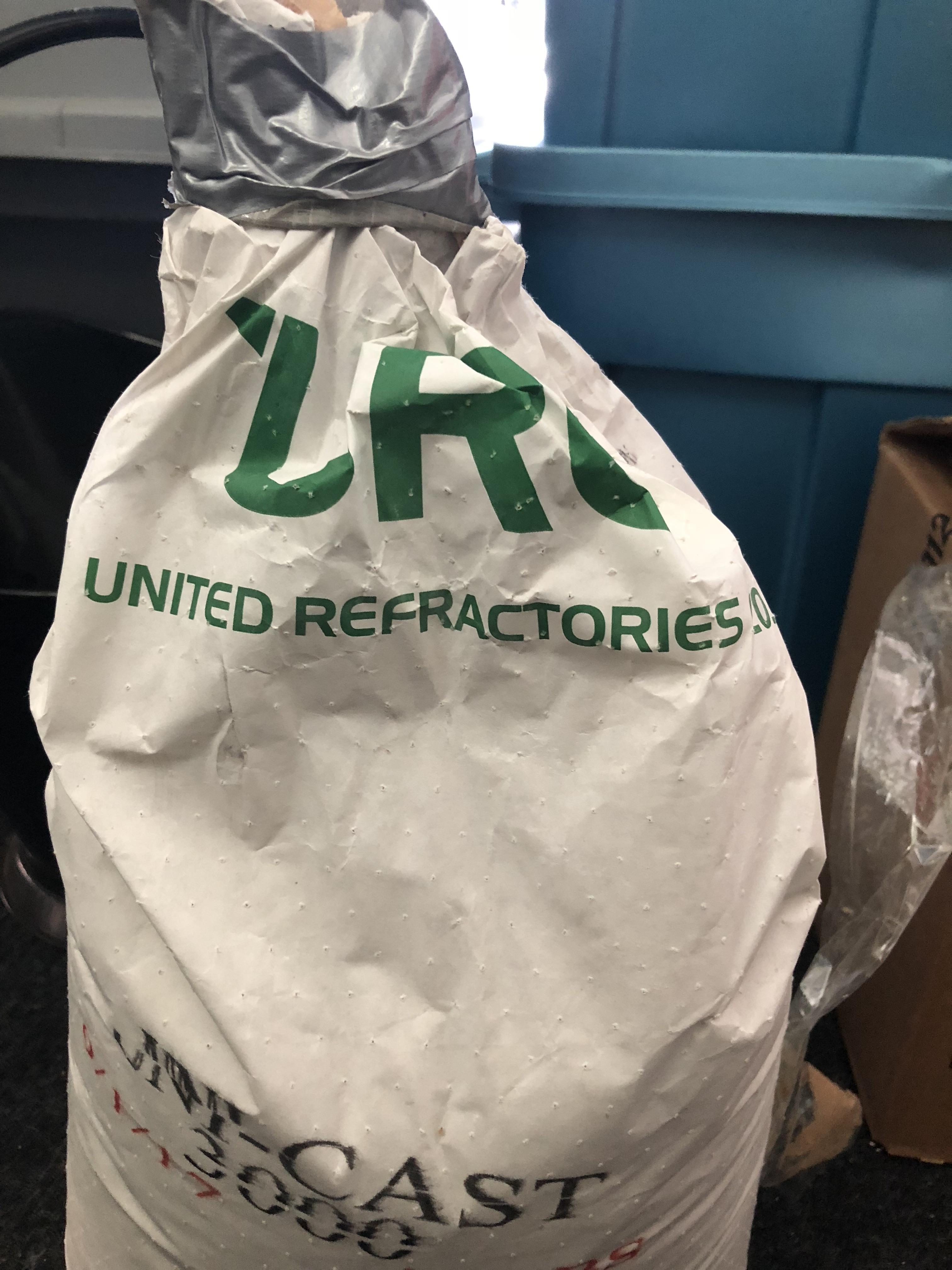

  4. The guy seemed to be pretty convinced he knew what he was doing. Said he had helped many people build forges before. That, coupled with the fact that this guy ran a company that specialized in this stuff, is what initially gave me the confidence to take his word. I hope I wasn't too wrong haha. The stuff is called Uni-Cast 3000 and it's made by a company called United Refractories Co. I tried looking up information about the company and the product but their website just lists the product and no real information on it. All I really know about it is that it's rated for 3000 degrees (as you could guess by the name) and how it is currently working in my paint can forge -- which is actually pretty well. I know it's not a long time, but I've ran my forge for a total of about 20 hours and the refractory seems to be holding up great. There is a crack in it but that's because I had to chip away at it after not putting mold release on the glass bottle I used to form the inner chamber. As well it has taken on an ashen grey color since the first firing. Other than that it looks the way it did when I cast it. The only problem I have with it so far is that gravel. Here are some photos of the packaging--
  5. I haven't seen anywhere online that people have castable refractory like mine, but the stuff that was recommended to me by my local refractory supplier and I inevitably bought comes with gravel mixed in to it. I imagine this is to increase strength much like in concrete, but I wonder if this is needed. The gravel makes it much harder to cast and work with, essentially removing much of it's structural integrity while wet and can fall apart easily without a mold to tamp and pack it in to. Perhaps the gravel can help with thermal properties as well? I suppose it must be there for some kind of reason, the question is whether or not that reason is beneficial to me.
