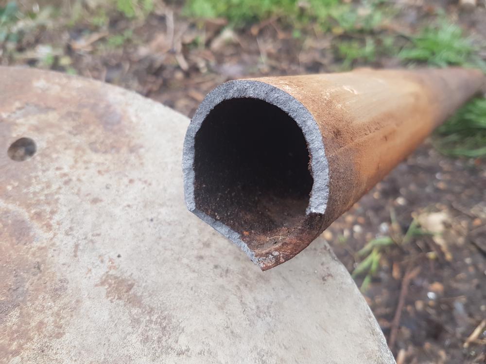

  7. i think i have found a section of drain pipe, that is cast iron to use for a tuyere. is cast iron a good material for a tuyere? how can i test it? it has been outside for some time, it has some paint and rust on it. if i clean it up should i protect the surface or let it gently rust?

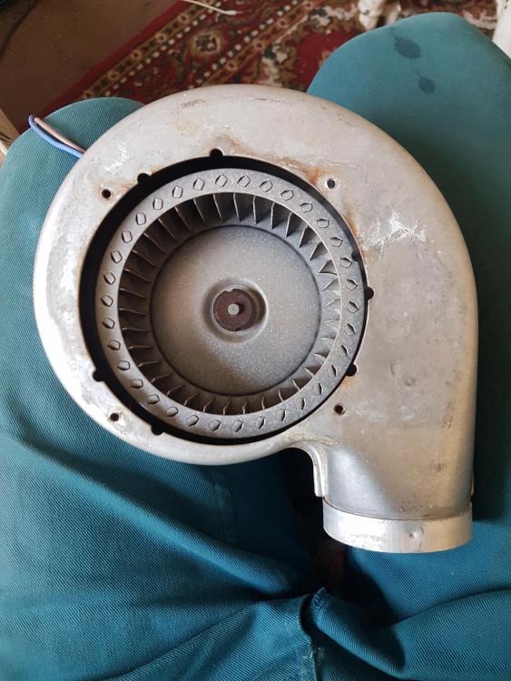

  8. yeah it is a shame the fan got broken. im hoping it is not going to be a problem, i think it will be ok because it used to be running in an elnclosed box inside the boiler, where there is little air circulation. i will be running it in the open air with more air moving around it. i will test it to see how it does. i wish i still had the cover plate. i have no idea what size the hole needs to be. i could make somthing out of plastic or ali, but i dont know how to test it other than just feeling the output with my hand. thanks for all your advice guys! much appreciated. i have mounted the fan, wired it all up, and tested it. it worked fine. its all safe with rcd, earthed cable, and insulated crimped spade ends. i want to add a foot switch when i find a suitable one. an electrician friend down the pub said i can easily fit a speed controller. would this be a dimmer type switch, or a specific "speed controller"? anyone have a rough idea as to the tyere diameter i should go for? my intuition says just use one the sameish size as the fan output. is there any befenfit to reducing it down?

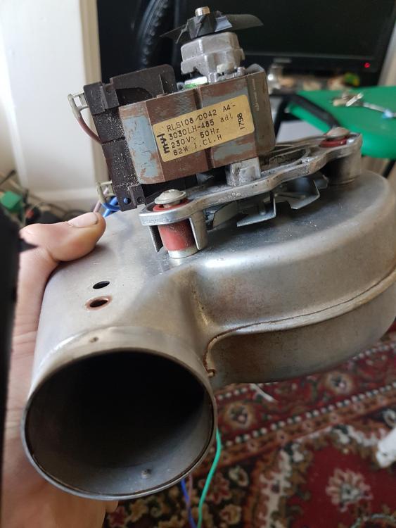

  9. hi marc, yeah im in the uk, we have 230v 50hz mains here. thanks for the info

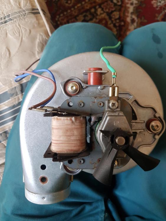

  10. you guys are getting way to hung up on this. look im even doing the research by asking here. my issue is whether this motor needs a transformer or if it can just run on mains. i dont have any experience with motors. if it needs a transformer i will have to go down a diffrent line if enquiry. if it runs on main its just two connections over an inch apart. where is cross wiring going to happen?
  11. i really do understand your concern but i am going to do things safely. i am going to run it with an RCD, all wires will be soldered, secured, and shrink wrapped. i have some brackets to mount the fan to a log so it wont move around. theres not really any chance of cross wiring. if it works out being useful i would build a housing of some type.
  12. i dont really see what there is to be scared of. im not going to touch live parts and all connections will be solid. electriciry is safe as long as you are careful.
  13. yeah i searched the serial number which identifies the fan model. sadly not really any info just suppliers. i also concur that motors of this style i have seen have been wired directly. i dont want to blow the motor trying without knowing. i have messed around with quite alot of basic electronics and i know how to be safe, but i appreciate the concern. i will probably have to put a housing over the motor if i end up using the fan. yeah i searched the serial number which identifies the fan model. sadly not really any info just suppliers. i also concur that motors of this style i have seen have been wired directly. i dont want to blow the motor trying without knowing. 230v 50hz is mains here in the uk, does that mean the motor can be direct wired with no transformer? i have messed around with quite alot of basic electronics and i know how to be safe, but i appreciate the concern. i will probably have to put a housing over the motor if i end up using the fan.
  14. i have aquired a blower from a central heating boiler. i dont know the cfm but it looks like it will have enough power. however my knowledge of electronics is very lacking, and i am not sure how to wire it up to power. does it need a transformer or can it be wired directly to the mains? cheers!
