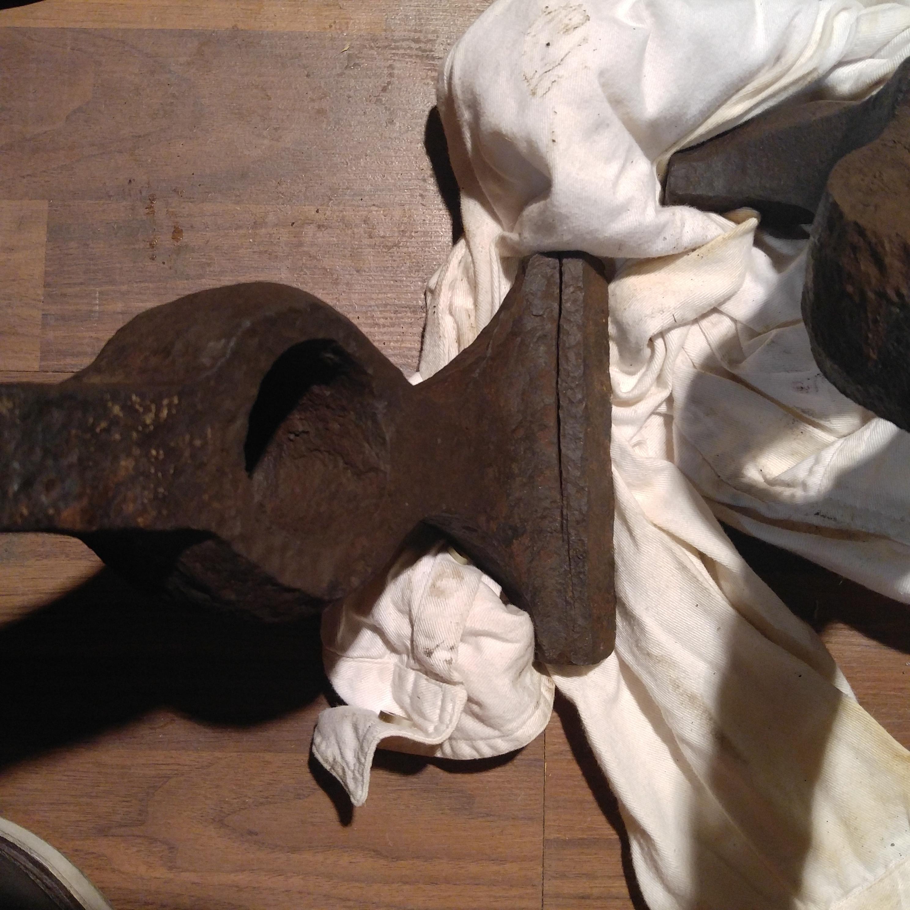

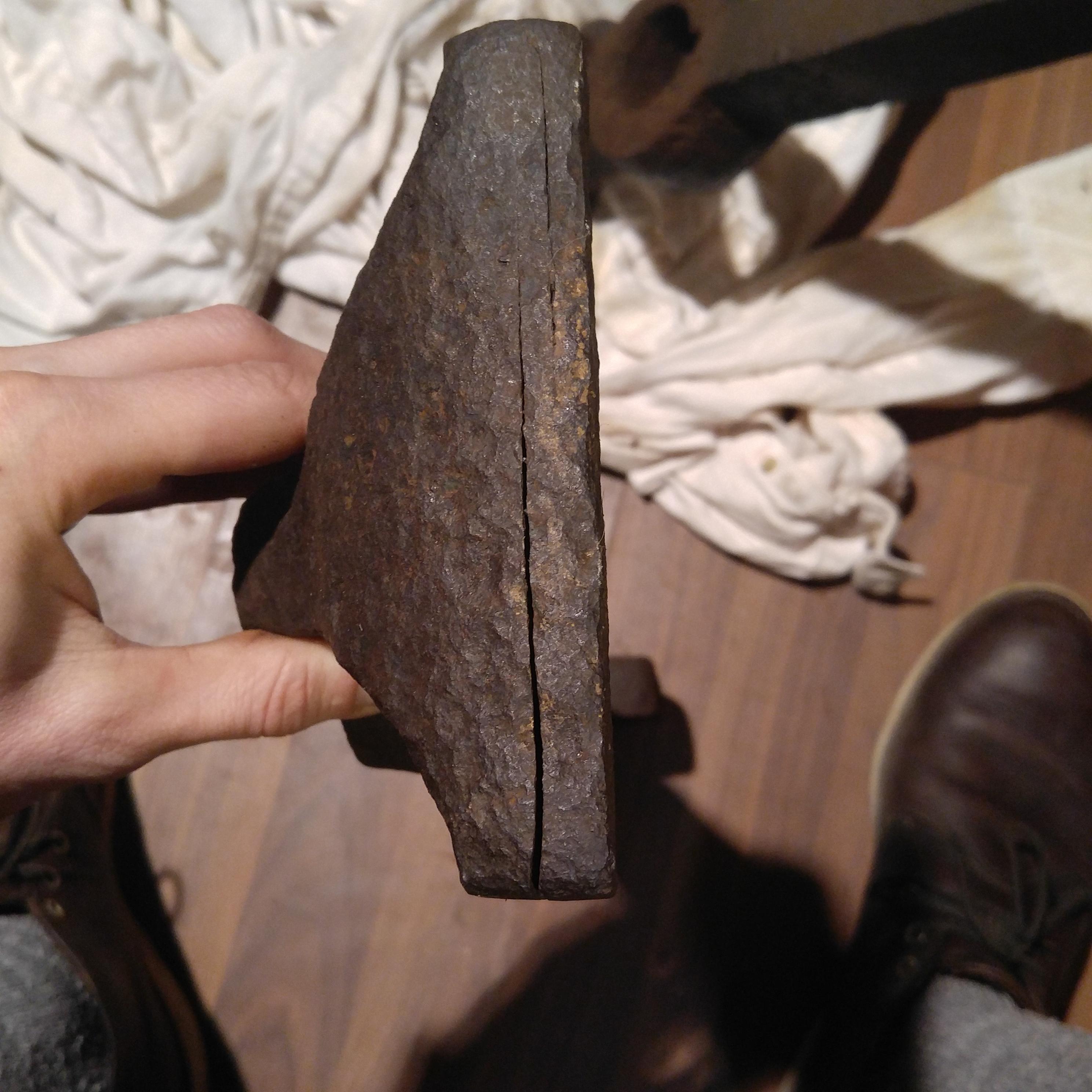

  3. That was my first thought. In this case would you suggest drilling holes through new jaw faces and plug welding or taking another route? Also could you elaborate a little bit for me on "if so use more rod/wire as the silicates get vaporized"......still learning all this terminology haha. Thanks

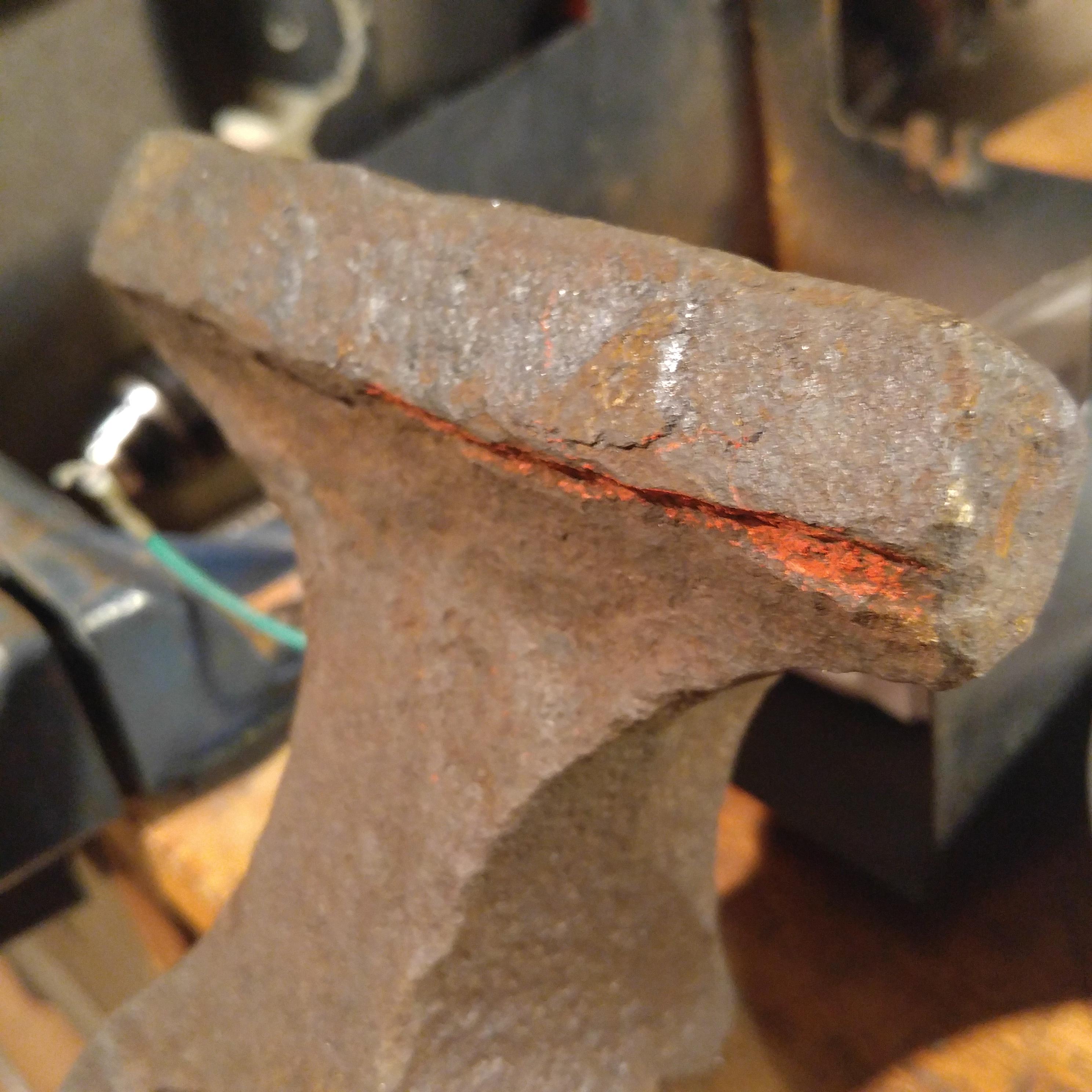

  4. Hey Billybones. I am new here as well and have to say this is a great forum so far. Your vise is very similar but I do see a few minor differences, nonetheless thats a good lookin vice you have there. As Lionel said, the leg or post should meet and be stabilized to a mount on the floor. Okay so to give you guys a little update on my original post.... All of the parts are in pretty good shape and I am working on getting rid of all the rust before re-assembling this thing. My biggest concern about bringing this thing back to life is one of the jaw faces. As you can see from the pictures the one jaw face is nearly separated from the jaw. The other seems to be okay except for maybe a small portion of the jaw face being chipped off at one point in time (area colored red) but doesnt seem to have a split. but I am more concerned about the one that is actually split. I am interested in hearing if anyone else has had this issue and what you did to repair it. I read a few things on other sights about making (i guess drilling and tapping?) removable jaw faces. I also read that that might not be the best idea unless I was to incorporate some type of rabbet joint or something to accomodate for the shear force this thing will experience. Excited to hear what knowledge will be thrown my way. Thanks in advance. Cheers

  12. I agree with not making it look new. The reason I say fill in divets is because it was literally underground for god knows how long with just the smallest part of it sticking out for me to trip on so some are a little deeper than normal patina and maybe would help strengthen the leg because of that? The one fall on the way home from a bar that I was happy about. Depending on how deep some really are after getting rid of rust I will consider leaving it as is and mabe just do moving/touching surfaces. Ahhh okay that's great to hear about the casting. Not a big fan of cast stuff in this type of application. Yes the reason I thought cast is because of what looked like a couple tabs or lines like you mentioned. I'm thinking a 1/2 steel plate big enough to give me good side to side and back and forth pulling without wanting to topple and a 6x6 post. And a couple raised casters to tilt and roll. Thanks for the input Beaudry
  13. The jaws are 5 1/4" I am thinking Columbian from what I have read through and seen so far on the interwebs. Does this sound about right? I am still very curious as to year it was made because i noticed a lot of Columbians with not so decorative or as curvy a screw end (Columbians, as far as i know, are supposed to have curvy ends) which I'm assuming got lost with mass manufacturing techniques. Also it seems like parts of it are cast iron which will break pretty easily if I were to use it for a lot of hammering. My plan is to sand blast it, do a little grinding, torch weld as many divets as possible and give it another finish grind/ polishing then keep it looking good for as long as i live with coats of oil. Still looking forward to everyones thoughts and opinions as to whether or not I am on the right track identifying this thing. Cheers
  14. Hello all, New to the forum and using forums in general for the most part so go easy on me. I am currently working on restoring a leg vice and thout id ask for yalls help trying to identify it. I found it buried in the ground in Monmouth County New Jersey and finally got the darn thing apart today. Excited to see what everyone has to say. If I can add any other pictures to aid in identifying this beast please let me know. Cheers
