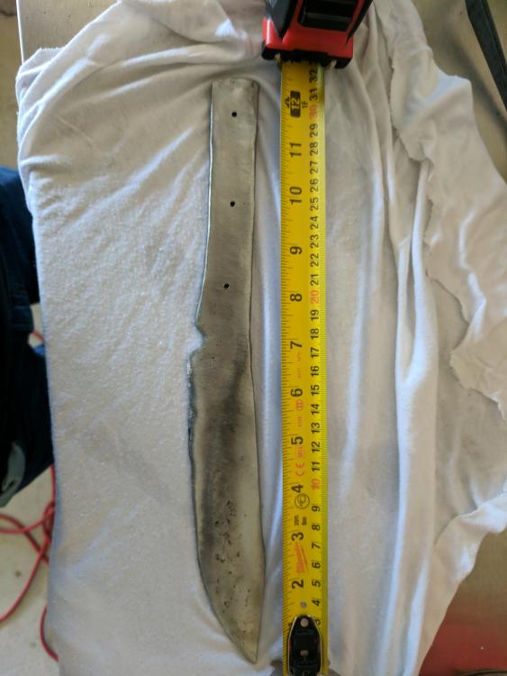

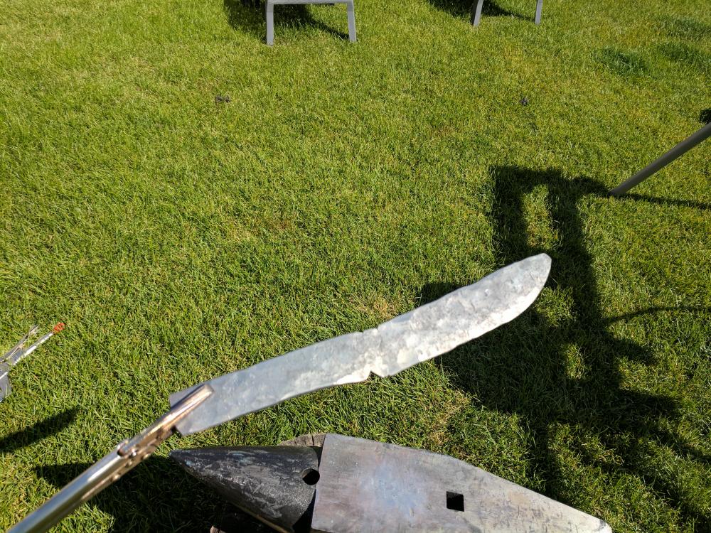

  10. Hi everyone! I just started smithing literally days ago. Never hammered on steel or knew anything about it. Being obsessed with the show Forged in Fire I set out to build a propane forge and start practicing. This morning I lit the forge and placed in a piece of 3/4" round (no idea of the grade but it does weld easily???). Took me about 4hrs but I got a rough knife shaped object out of it. I kind of let steel do what it wanted too until a shape appeared. I found it fairly difficult to move the steel and make a flat from the round bar. Any suggestions to help improve? Maybe ways or places to strike that you have found to draw material out more easily (width I was able to figure out but lengthing was almost impossible). Many thanks and I hope to participate in this forum more often as I grow as a Smith.
