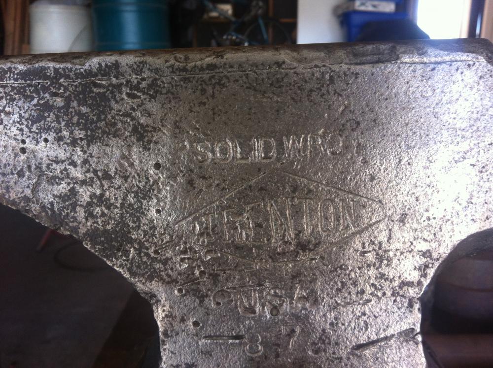

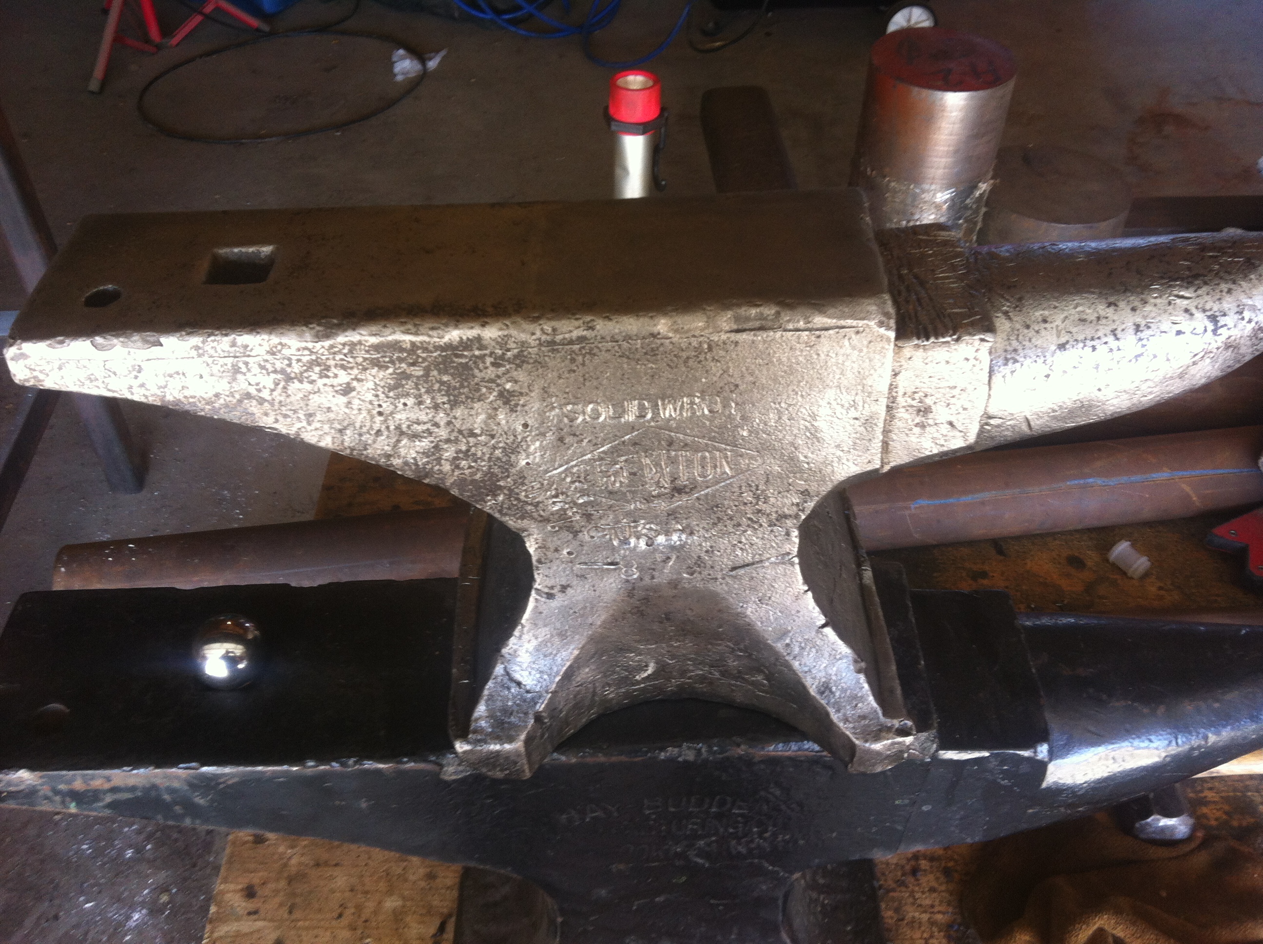

  1. haha yup just some WD40 will do a boiled linseed oil soon it says ''solid wrot'' ''Trenton'' ''USA'' ''87'' go to walmart and buy 3-4 gallons of vinegar and a big rubber tote put the anvil in there add the vinegar then water till you cover the anvil. let sit 24 hrs take a wire wheel to it, then wash it with baking soda to kill the vinegar so it dose not keep eating it. good luck. take some pic's before and after
  2. man i love that stump looks like it belongs to that anvil, with the square bolts and everything
  3. before and after vinegar bath and a wire wheel / brush, no sandpaper or grinders used. it's a 1898 87# us made full forged base steel plate. did a 1 1/2'' BB test looks to be about 90 - 95% rebound same as the 200# HB under it.

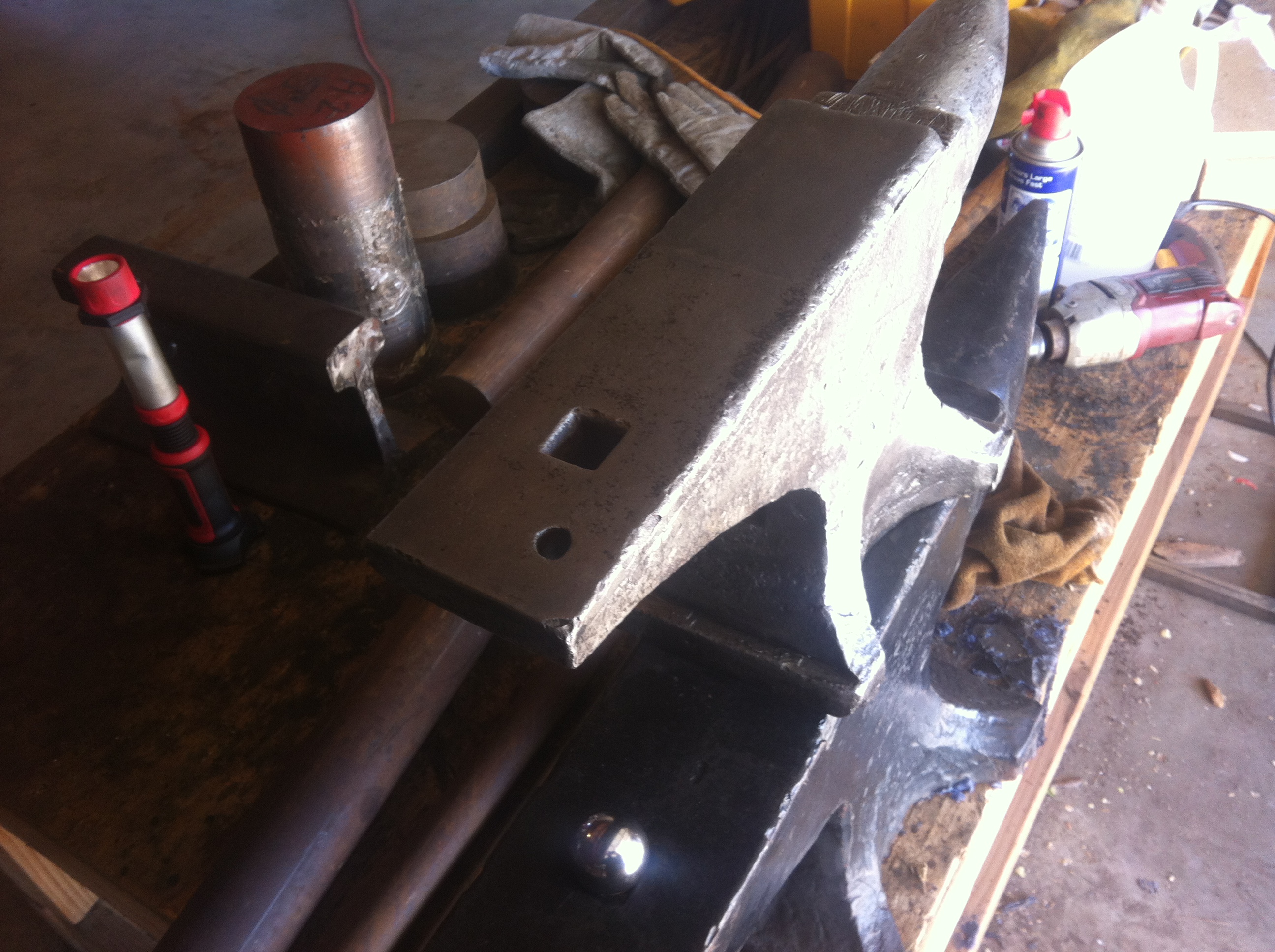

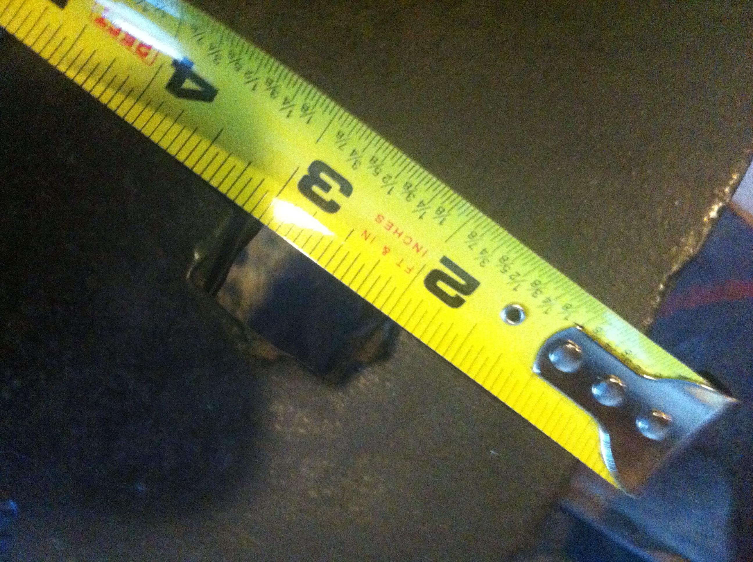

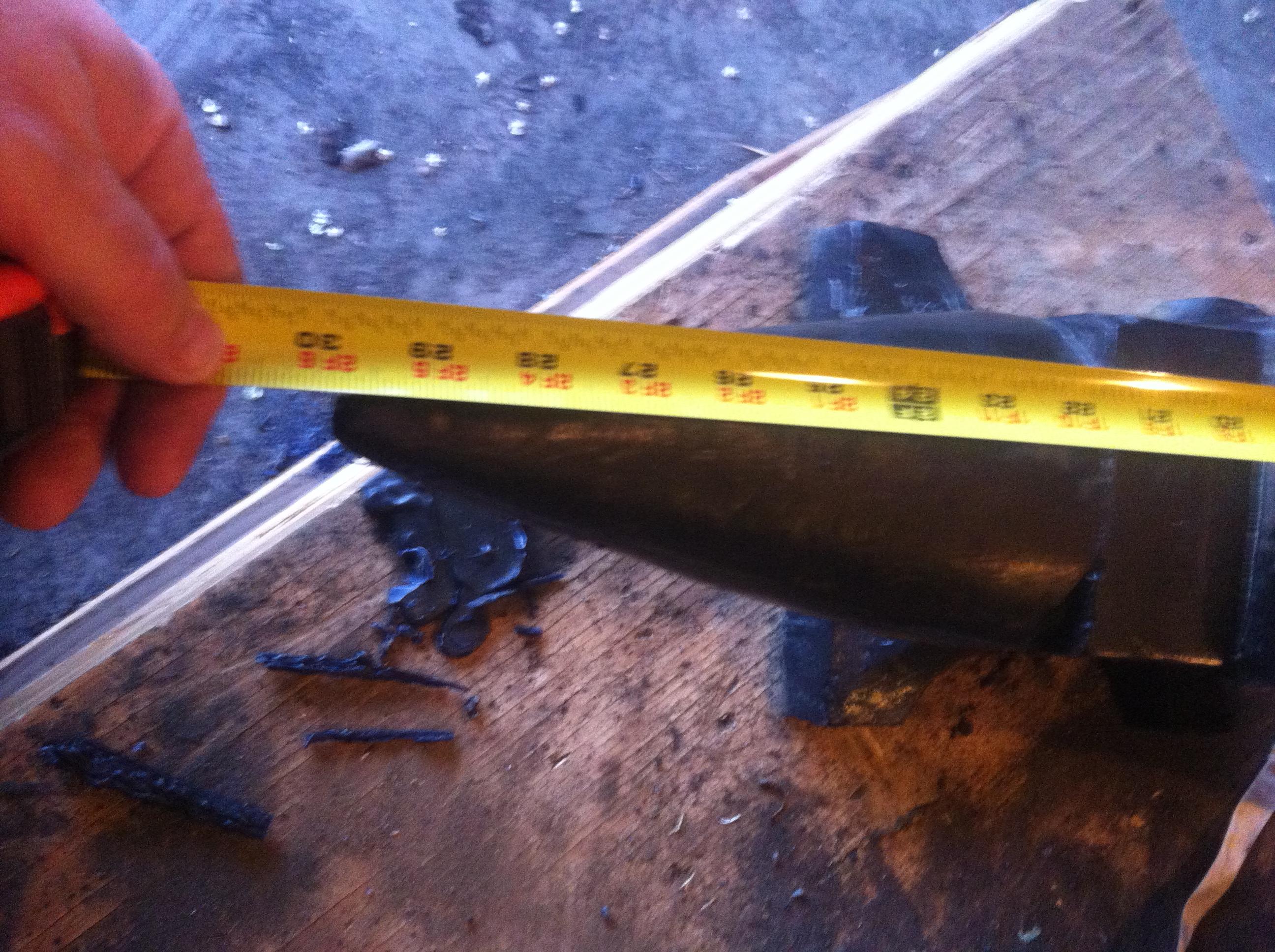

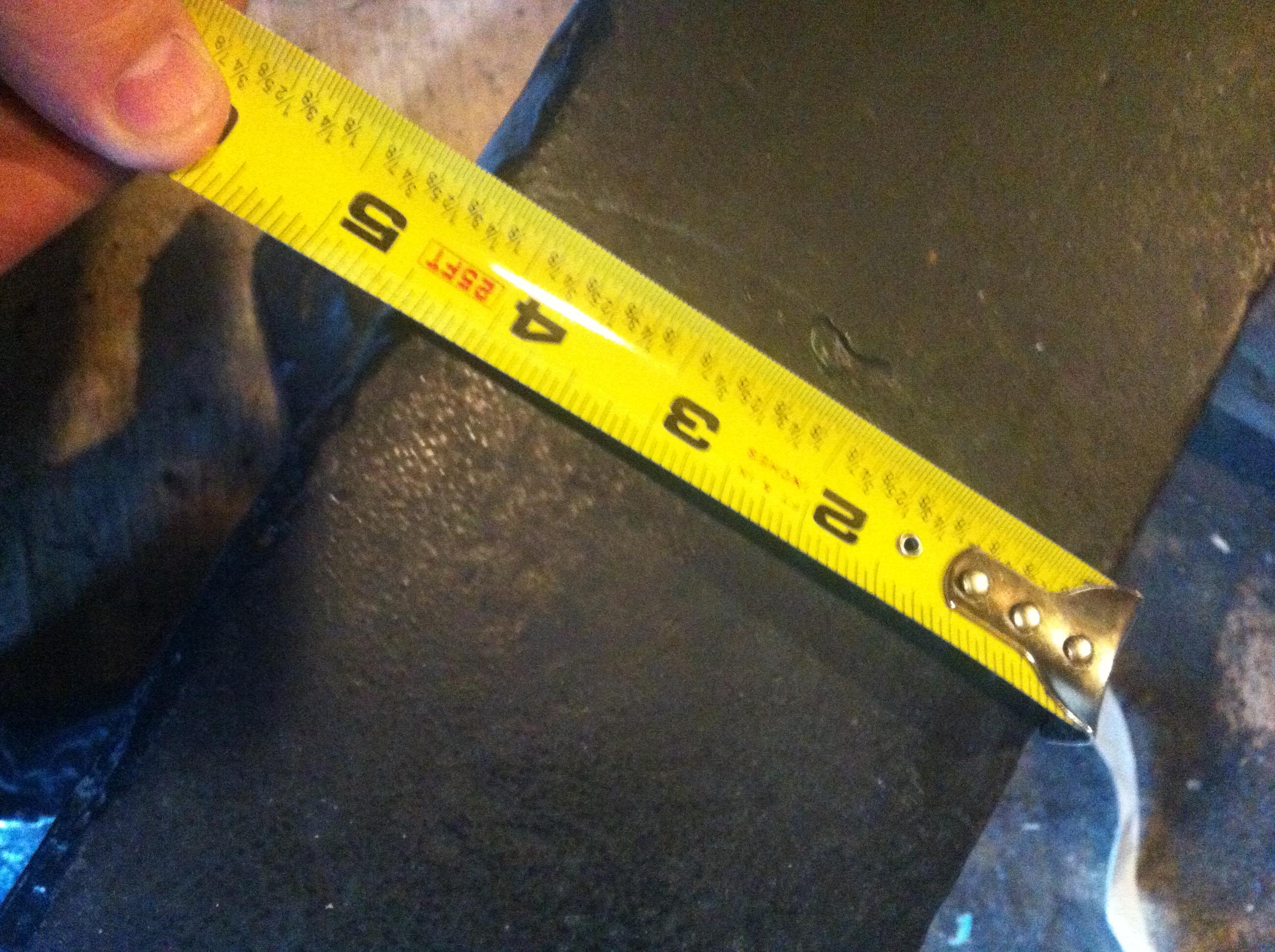

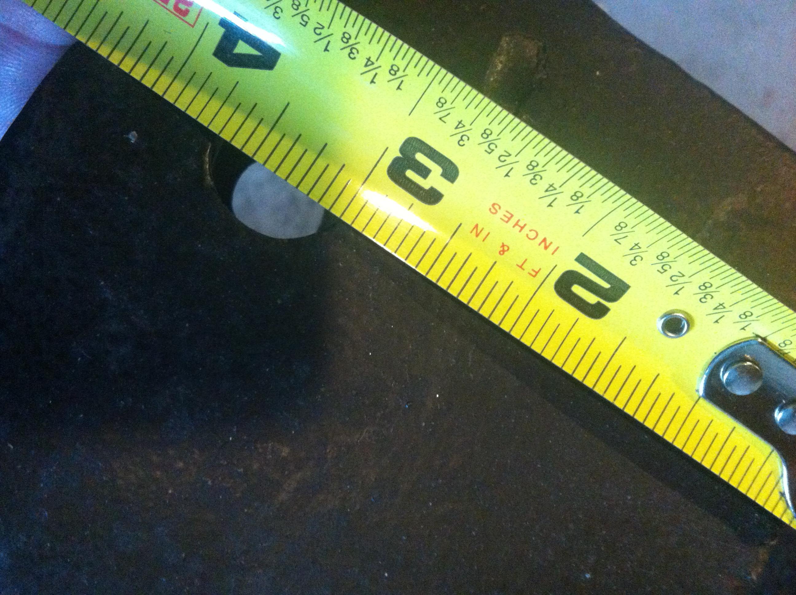

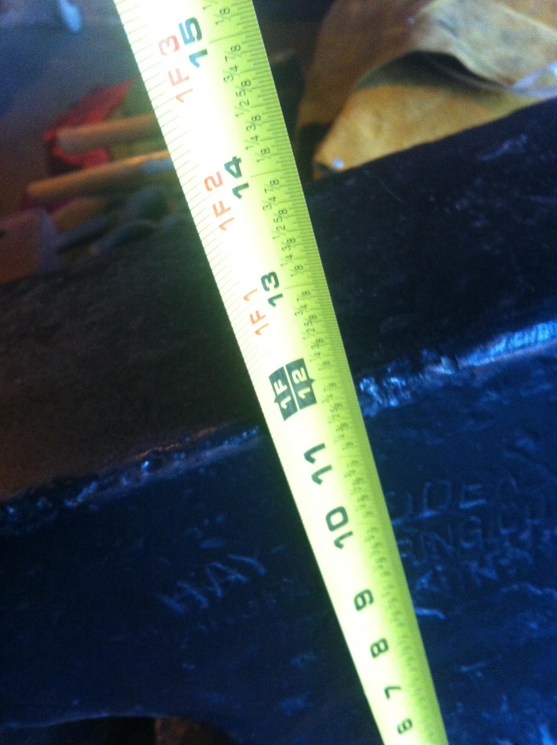

  6. so i woke up today with zero anvil's and im going to bed the proud owner of 2 anvil's my best guess it that it is 260# as i saw one on ''e@ay'' that looked about the same size. EDIT well i put it a crappy bathroom scale it read 193.6 LB and after looking all over i found a ''95'' on the foot, so this may be a 195Lb. it's super nice no sway the face is super flat. a few small chips on the side's of the face but over all it's like new. here are some pic's not sure where to find all the stamps. my trenton has then on the foot, where are they on this hay budden? it's 29 3/4 long 4 1/2 with of the face 1 1/8 HH 3/4 p hole 12 tall hope that help's

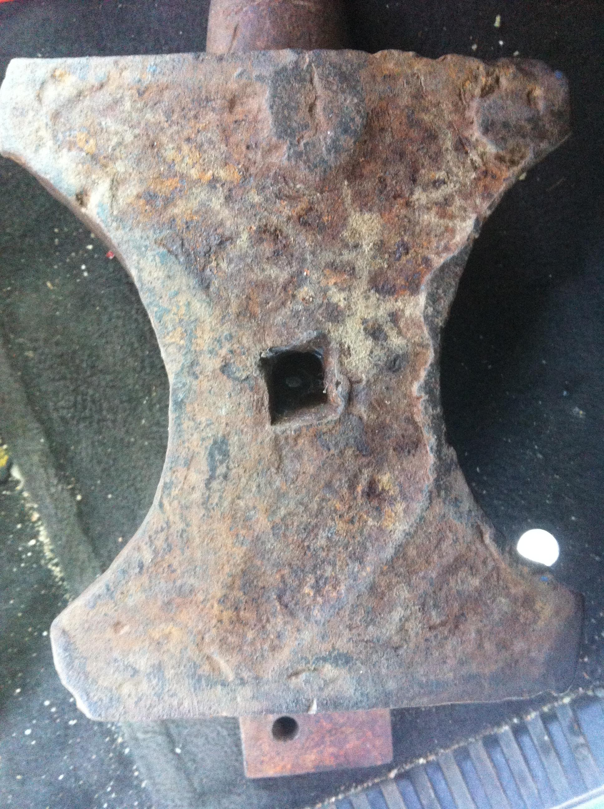

  7. oh just saw your request for a pic of the underside of the base so here it is. it has a hole in it that is about 3/4'' by 1 1/2 deep.

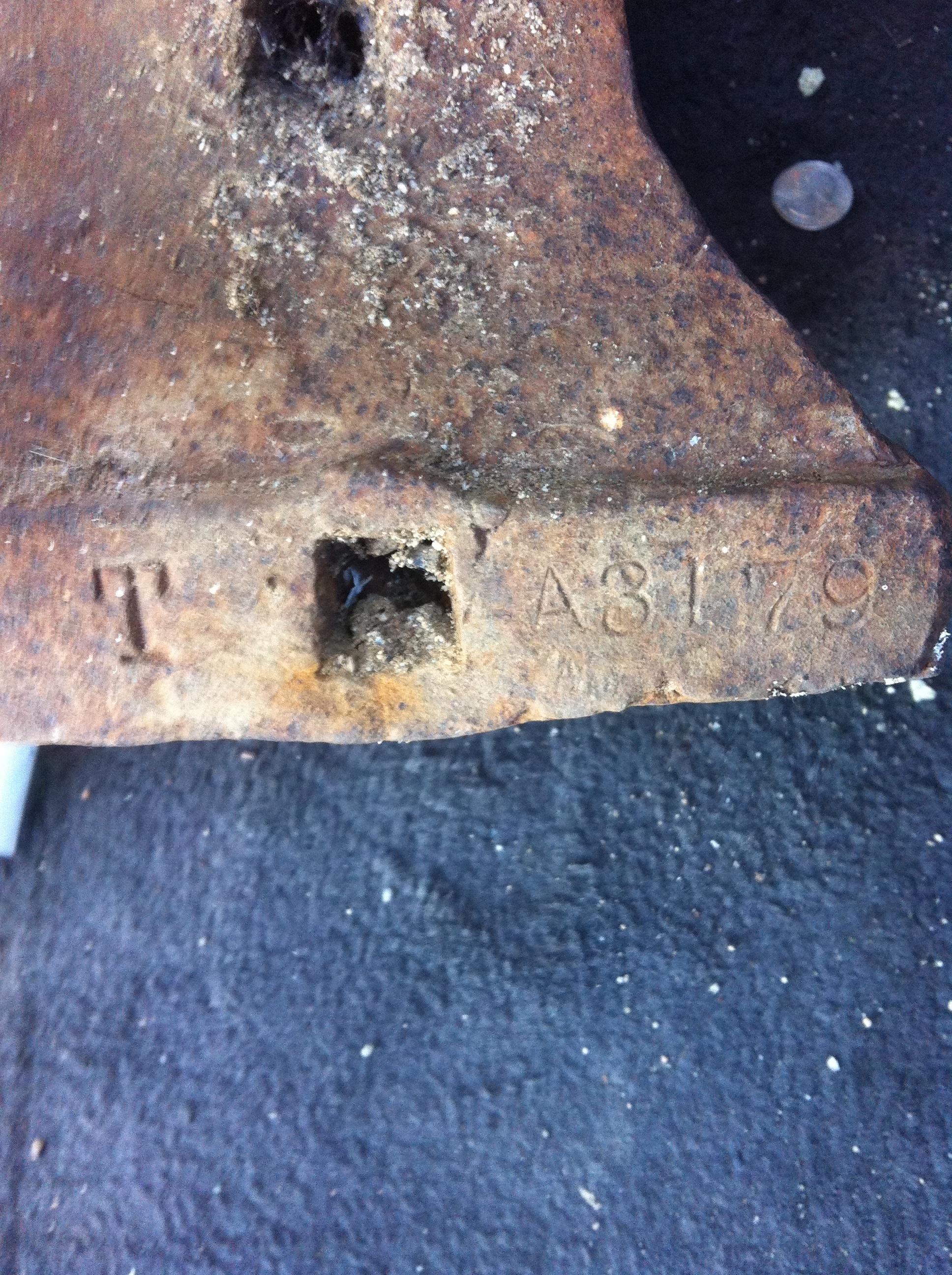

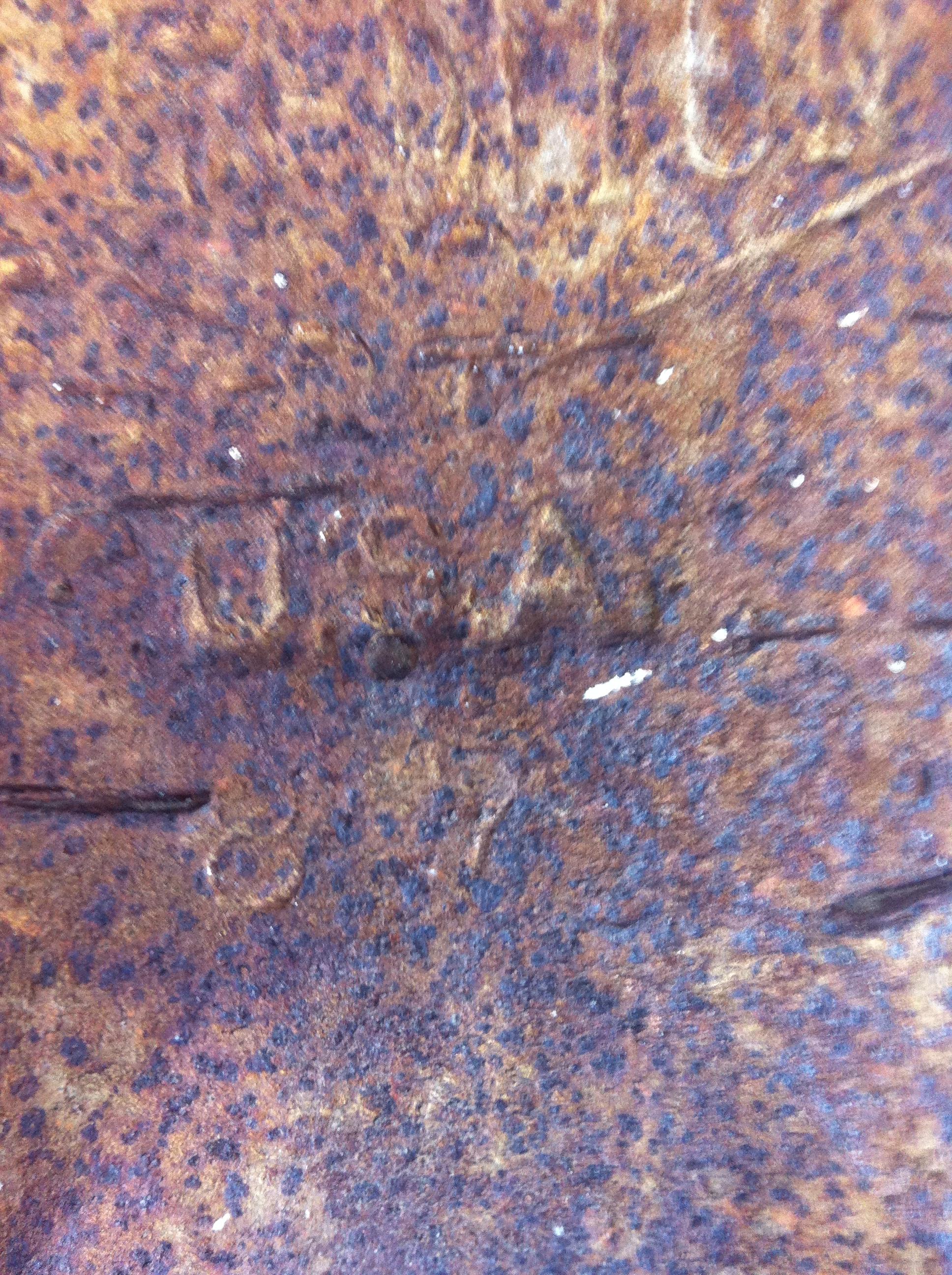

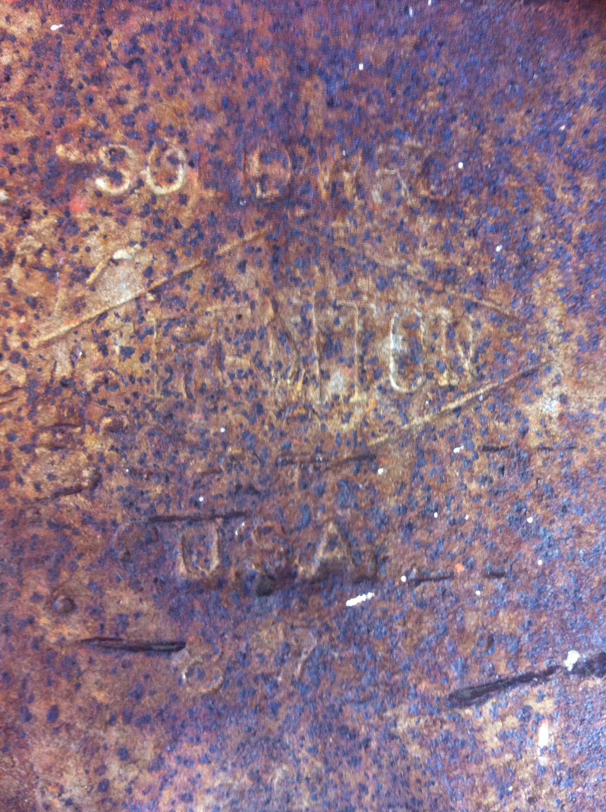

  9. im new here so ill start with hi my name is jason. i live in so cal im just starting to get in to forging. just got my 1st anvil its a trenton. was sold to me as a ''75#" paid 250$ going from what i can see here in socal this was a good to fair price. ill post pic's but ill list what # i can read as well on the foot there is a ''T A3179'' on the side ''solid wrought'' <--- I THINK HARD TO SEE ''TRENTON'' '' USA'' ''87'' i was guessing the ''87'' on the side maybe the weight or the ''79'' at the foot. thx for any and all help.
