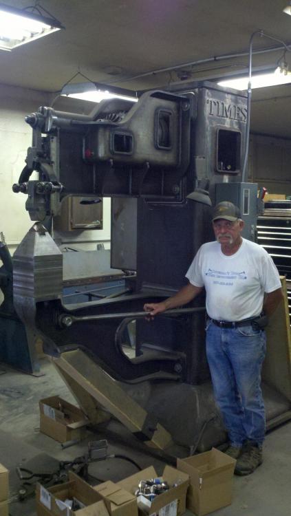

  12. Hi guys. I'm new to the forum. The vast majority of my work is in sheet metal shaping, but we occasionally have to do some forging. Anyhow , I thought you might enjoy seeing our shop-built power hammer . My dad and I finished this machine in 2008. That's Dad in the picture. After the design was nailed down, we had 580 hours in building the machine and machining the dies from S-7. It's designed for sheet metal shaping so it's built far too light for forging and that is why the working height is so high (so you can "sight" the surface of the panel you're shaping). The heaviest marterial I have shaped with it is 1/8" 304 stainless steel, but it'll move 16 ga cold rolled sheet like butter. Since most of the panels we shape are .040" steel, it's more than enough hammer. We built two sets of arms for it but currently have it set up as a single hammer . Anyhow, I hope you like .
