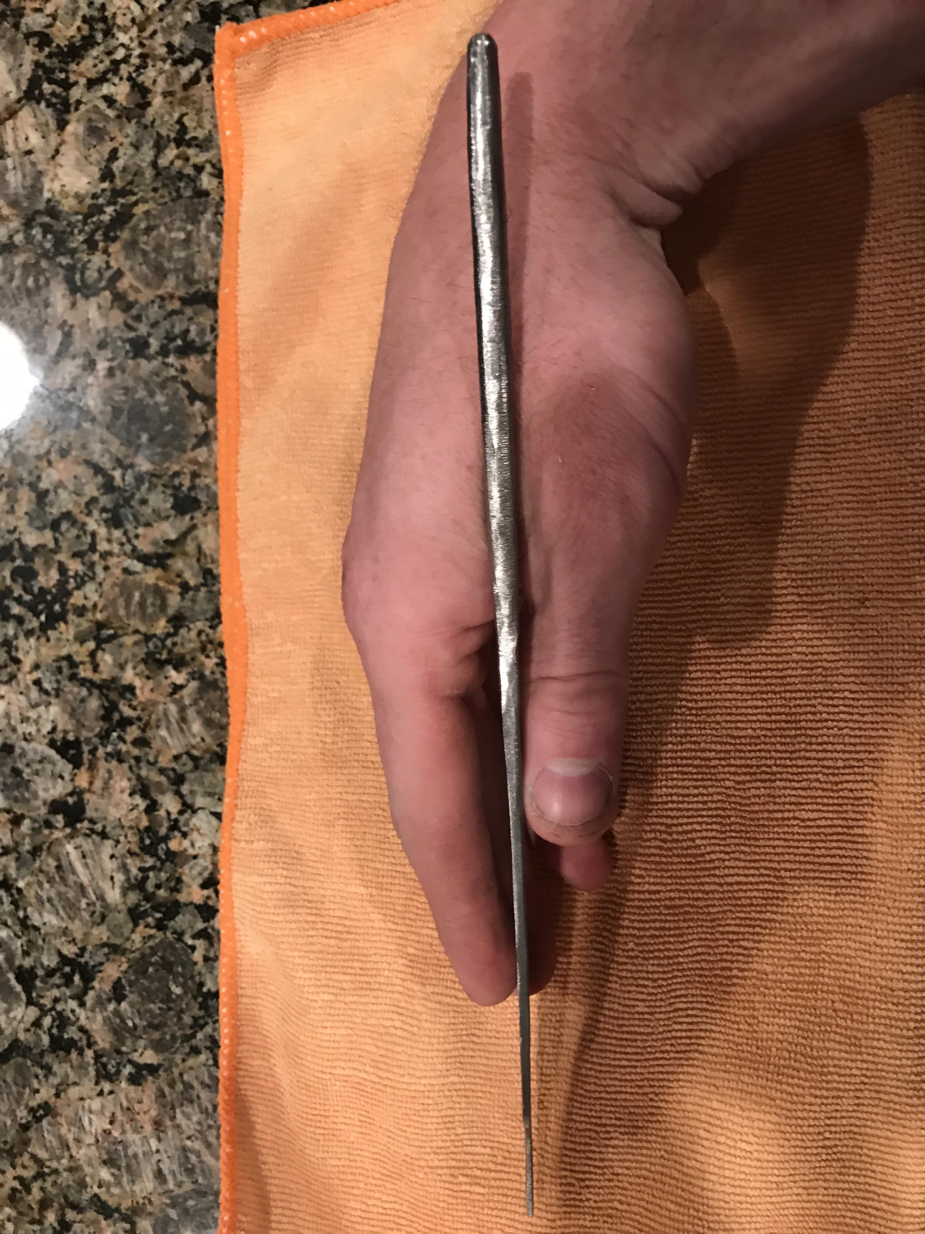

  10. First large blade, successfully hardened (file tested) tempered in the oven to a dark straw. Approx. 13 inch blade. Went for a Kukri but had trouble widening the stock, made from spring steel. Lemme know what you think! All it needs now is a handle!
