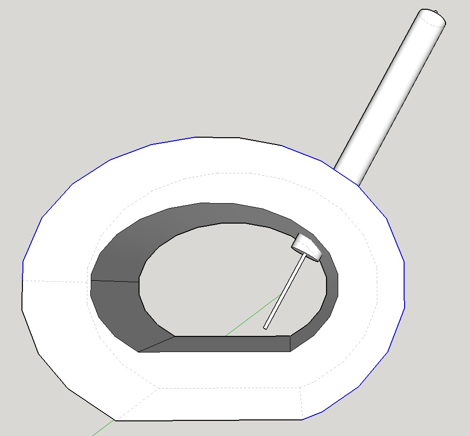

I appreciate you folks sharing your insight. I take the point on the strength of slightly thicker cement on the floor. I will do that. It is an interesting flow dynamic, almost a balancing act with flame/gas speeds. Sadly the morning ends the last of the freezing and my leg is all about reminding me that its been opened (!) so I suspect I will be stuck on couch driving my wife nuts for at least this one day. What I can do is brush the dust off of Sketchup and see if I can do better than a cardboard cutout. Is this the angle you are suggesting Mike? Or tighter to the wall? I will happily adjust the model based on your impression. (small thin tube represents center of burner) -

Here is a sketch of new forge profile showing all elements and some dimensions. Does the firebrick work in this configuration? Its surrounded by 2" kao-wool plus a thin layer of castable refractory cement. -

Thanks for the feedback folks. Wider mouth. Done. I am drawing up a 'slumped' oval shape 8" wide by 5" high More Volume. Done. I am extending length of working space to 8" (12" external frame) gives 322 cu in. Do not use firebrick for floor. ? I thought firebrick was a good sacrificial material assuming it takes the brunt of the wear of objects placed inside the forge dropped borax flux from forge welding direct flame hot spot Am I off the beaten trail on this? -

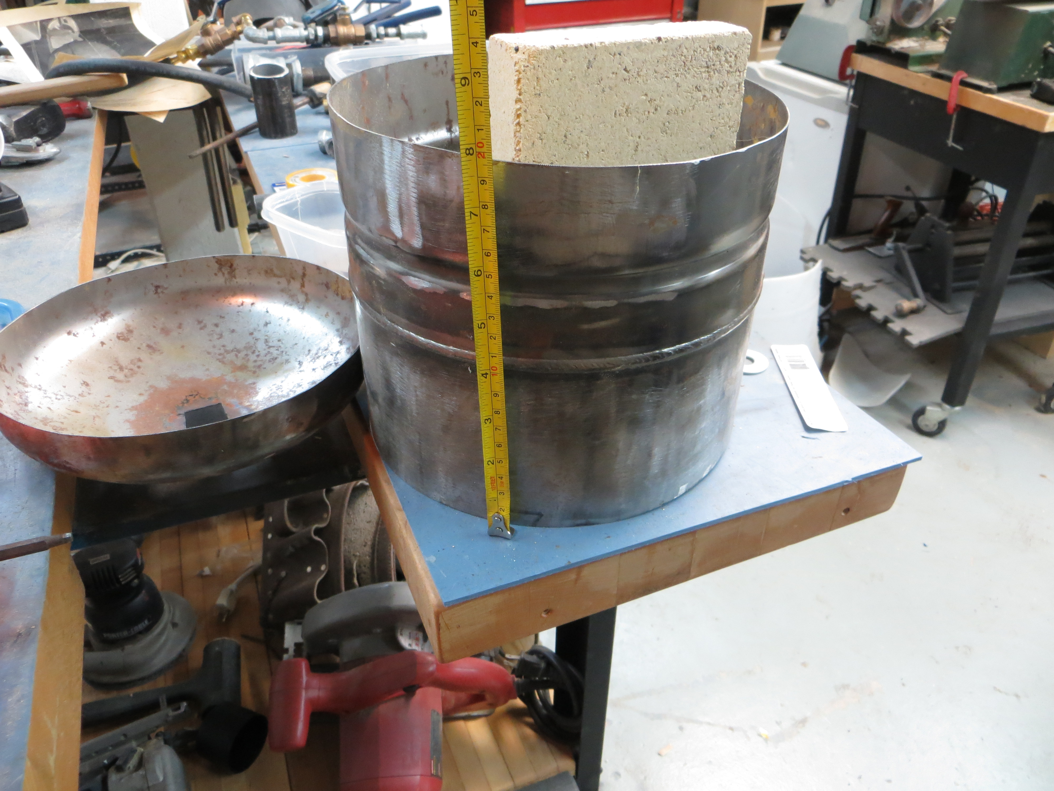

Hi Folks. Mike H here. In the interests of posting build stuff in the right sub-forum (instead of my Introduction) I thought I would share my progress so far. I have so far cut open a small water pressure tank measuring 9" high by 7.5" long. Assuming 2" kao-wool plus ceramic refractory I am NOT looking at a lot of volume in the forge. (147 cu in") I have now also have a (mostly I think) working 3/4" Mikey Burner. So I have concerns that a - the burner is too big for the volume causing extreme back pressure. b - the mouth of the forge will be a major obstacle to getting things in. ie coil springs for reforging, armour bits, curved s hooks and such. I can roll my own forge body out of some 16g cold roll I have here...I was thinking a slumped oval profile might be an efficient yet wide style. Or I can widen the existing shell into an oval (the doors will be pain though) or I can length it (but then I wonder if the heat will get to a 12" long forge from just one burner) Here is some video of the burner. (Audio is a bit low) Here is a quick vid of the flame with lights out. Thoughts? ps. Pretty happy so far with this burner design. Thank you Mike. Any feedback is most appreciated.

Hi Frosty. Thank you for the confirmation. I will bring it to a 12" length, just to give it less back pressure. That is exactly what I was worried about. Brick will sit on 2" kao-wool + castable refractory coating. It is also my intention to have both ends with side hinges, with access port in front and pass through in the back. I really do want this forge to stay small, but part of that is containing the flame as well. I get that this is probably just my first forge as I know how needs can grow based on a new toy. If I may ask a second question, would it be worth tilting the burner back slightly towards the back door to try and heat the longer length more evenly?
Hi all. Mike H here. A few minutes ago I called it a day, poured a beer and looked over my first Mikey 3/4" gas burner. I have had a small water pressure tank cut out for several months, but finally got time to get back to this project. Seeing that this forge inside dimensions after 2" Kao-wool added will be about 147 sq inches I am pretty sure this burner may be too big (maximum 340 sq in for the 3/4" burner apparently). I am going to add 5" to the length of the forge to try and match the burner a bit better. (245 sq in.) Anyone think that will be big enough for the 3/4" Mikey burner? I have been wanting a forge for sometime. I have built a lot of SCA armor over the last 30 years, but always worked the metal cold. My intent is to use the first forge for some chisels and gouges, a variety of medieval camping and kitchen implements, and the occasional knife and spearhead. I have read every gas forge sticky I can find here and elsewhere, so I hope to keep the stupid questions to a minimum. Anyways, beer is almost done, time to pull a second. Shoulders and neck are a bit sore = good day in shop. Anyways, Mr Porter please accept my highest accolade for a great burner design. Thank you.
