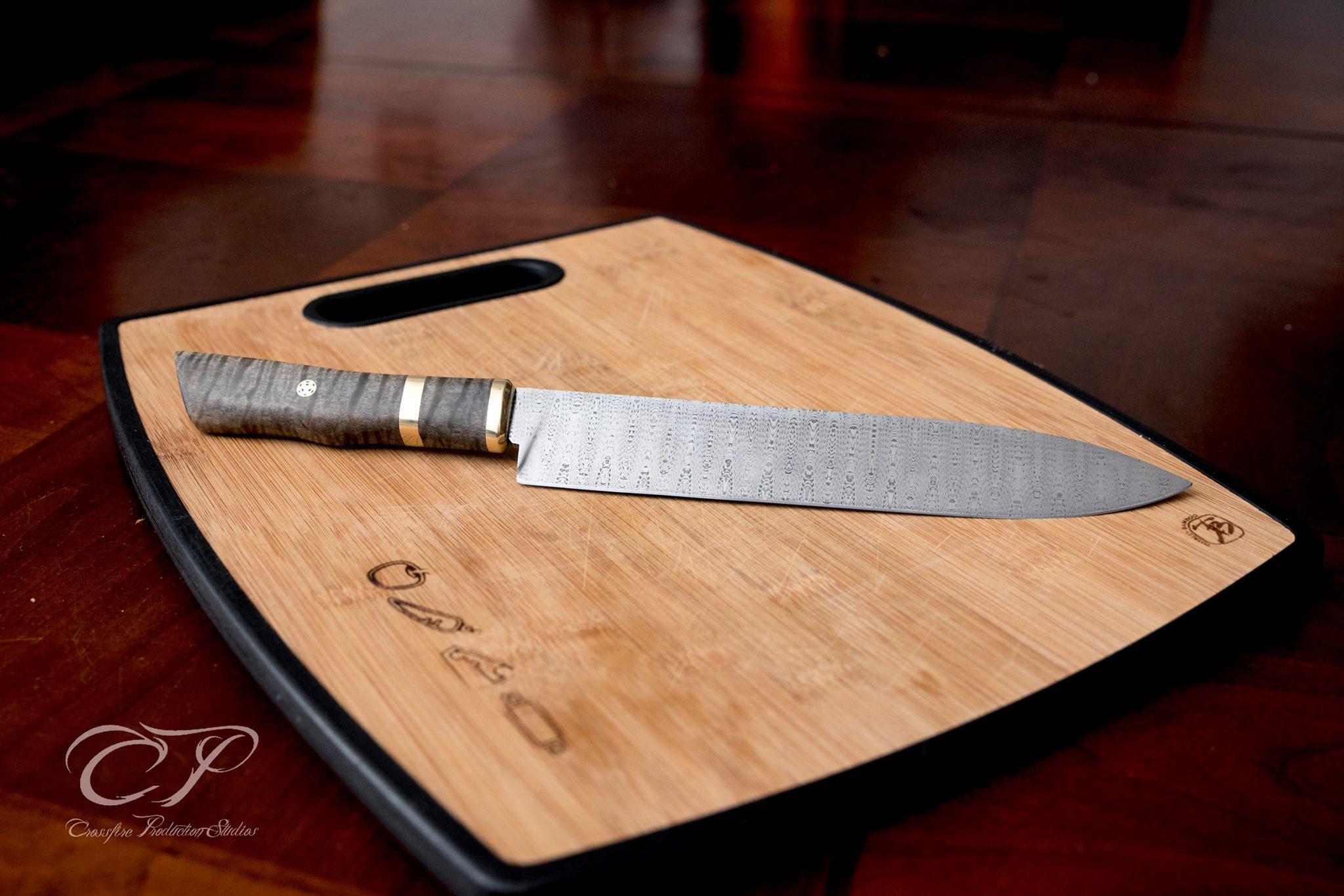

What's your latest blade look like? Post em and let us see.
