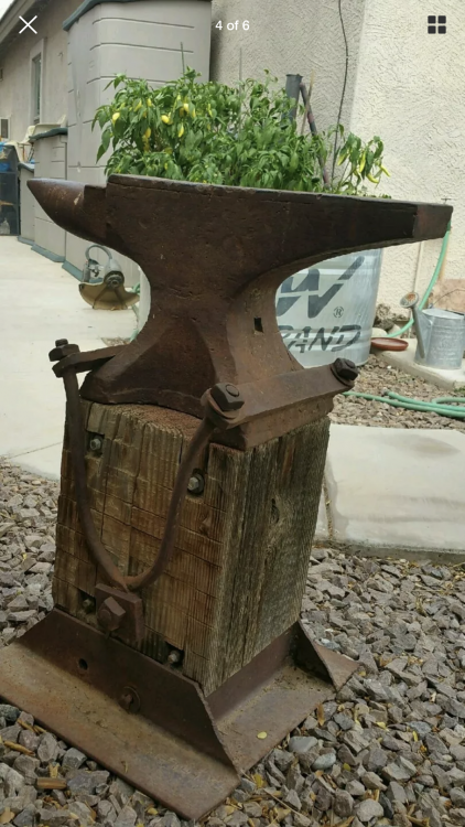

  4. Well, I went ahead and took the chance and bought it. This thing sucked to transport! Haha but I'll be posting my progression in knifesmithing. Thanks to all for your insight!
  5. Wow! That's a great find! Maybe I should just grab this thing and start working steel then. $2.50 a pound isn't too bad. Worst case scenario I get it repaired.
  6. It's not a linear crack it's more like a wave going through the corner. I'm all about it if it's serviceable, I guess either way it's a great starter anvil. The rebound and weight is what's got me semi sold on it. Thank you for your insight btw!
  7. It's still available to me. I also noticed a crack in the waist of the anvil (look close at 3rd picture back of the waist half way up) can't tell how deep it is. Is this of concern?
  8. Thanks my friend! I'm working on updating my profile. I'm in Peoria, AZ. Anyway, I think I'm going to pass on it. It rang on all spots hit but kind of a muffled ring. Not sure if it's normal for that anvil or not and $500 is a lot of scratch to be unsure about something. I think I'll save a little more and go with the 110lb Kanca, found one shipped to my doorstep for $709. Or the 100lb TFS for $579 shipped. Any feedback would be greatly appreciated!
  9. I will, we did take a ball bearing to the entire face and it had great rebound dropped from around 18", around 85-90%. I need to hammer test it and listen for buzzing. I couldn't find any real gaps around the face seam.
  10. Hey all! Brand new here and new to blacksmithing as well. I have been making knives using the stock removal method for a while now but I have the itch to start hammering them out. I have a line on a 195lb anvil for $500. It's believed to be late 1800's to early 1900's, unknown maker. The face seems pretty flat in person. It has around 85-90% rebound still on the entire face. Attached are some pictures. I know there's a lot to look for but it seems "ok" for the price... The other option is to buy a 110lb Kanca but I'll need to save more money to get one. Thoughts? Thanks in advance for any help!
