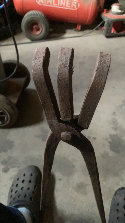

Hi. Someone asked me if i knew what this tong is used for and i dont know. It's a very special pair of tongs with three jaws from sweden. The middle jaw is apparently loose and there are many more in sweden in different sizes and shapes. The only thing i can think of is that it is used for forge welding or maybe some farriers work. Can anyone in here help me out?
