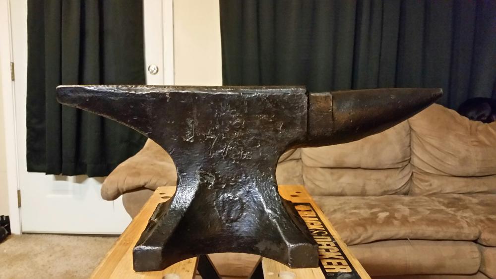

  1. IT passed well was a 100%+ on rebound from one end to the other.

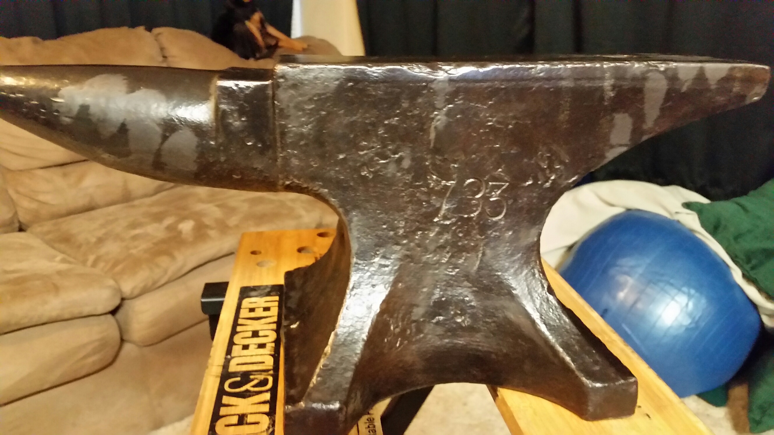

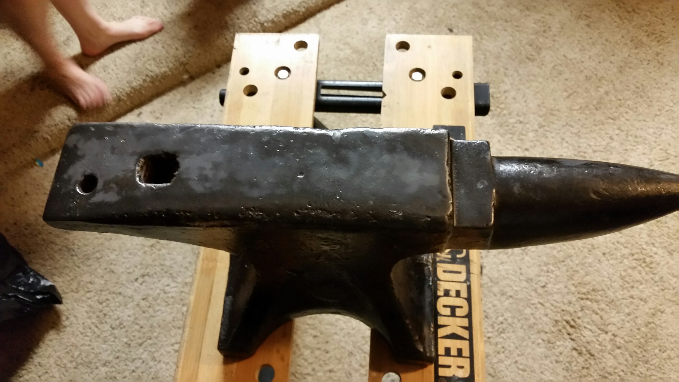

  2. Here it is just picked it up today, fresh from the wire wheel with a coat of oil brought it inside for some pics better lighting.
  3. HAHA yeah better lighting in here for pics it is in my game room so she did not care help me turn the table for better pics of the other side..

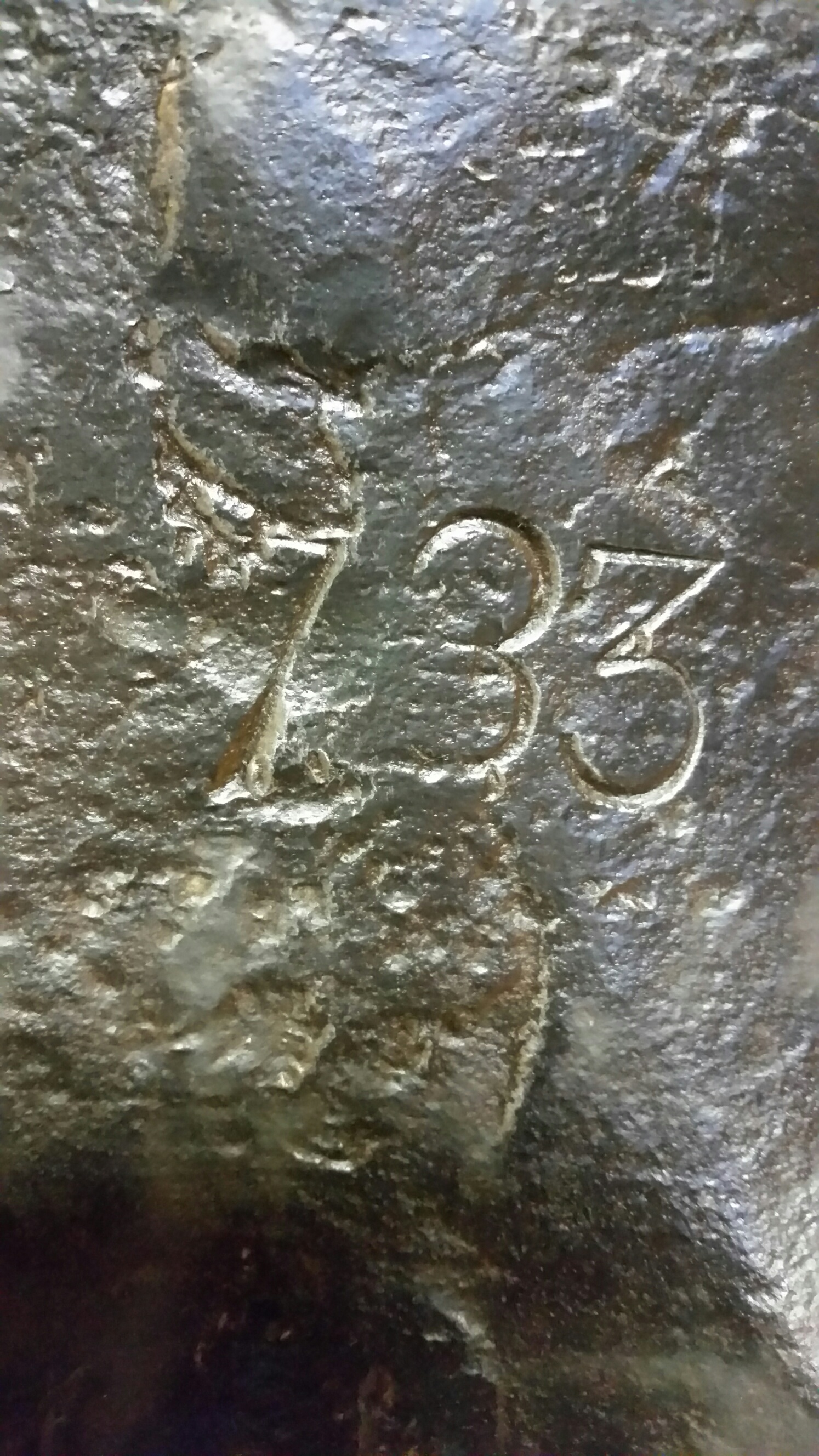

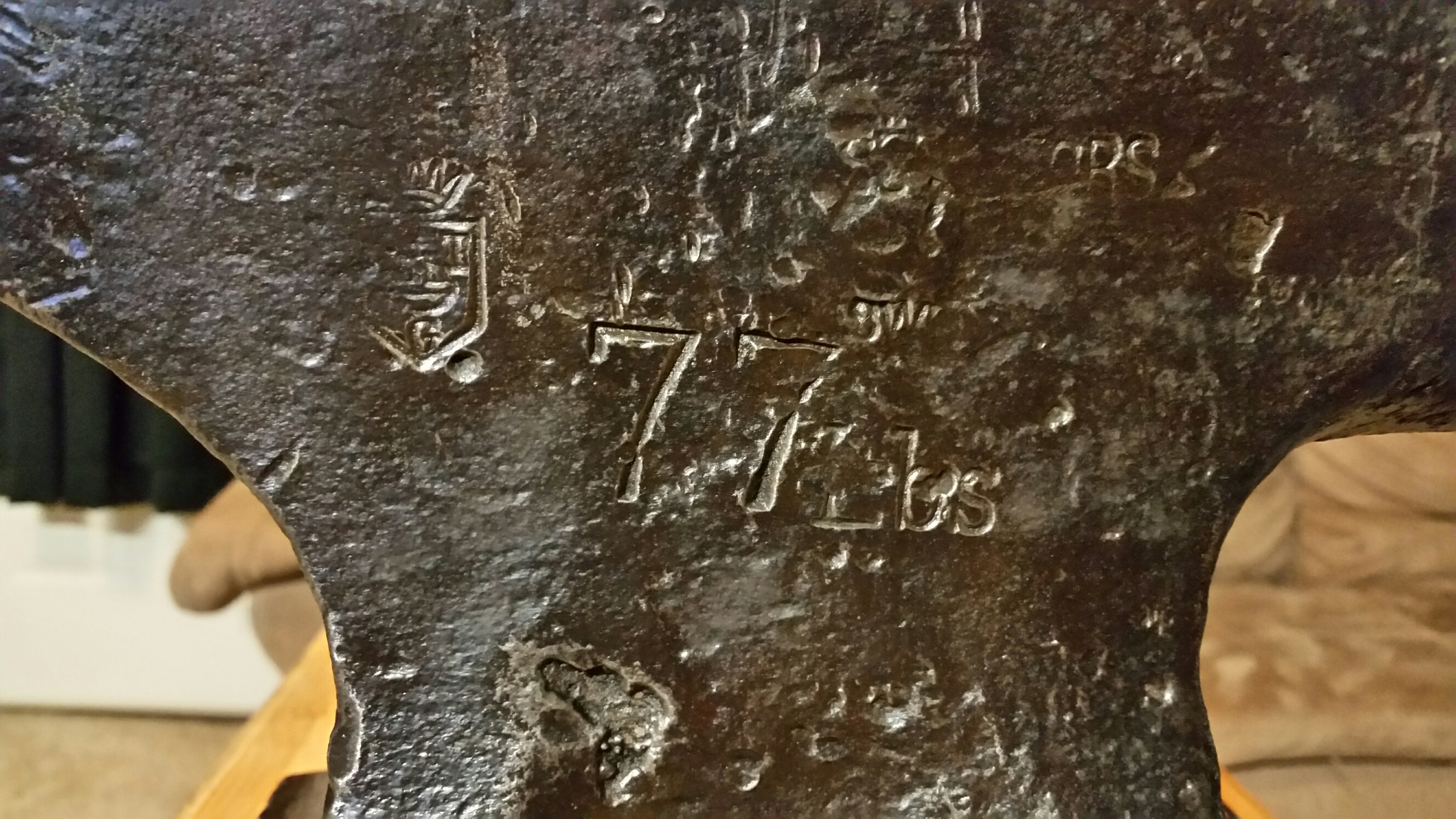

  4. Yes I did, the Trenton though was covered with mud and rust could not make out a serial number. Here are some pics of the Soderfors cleaned up.

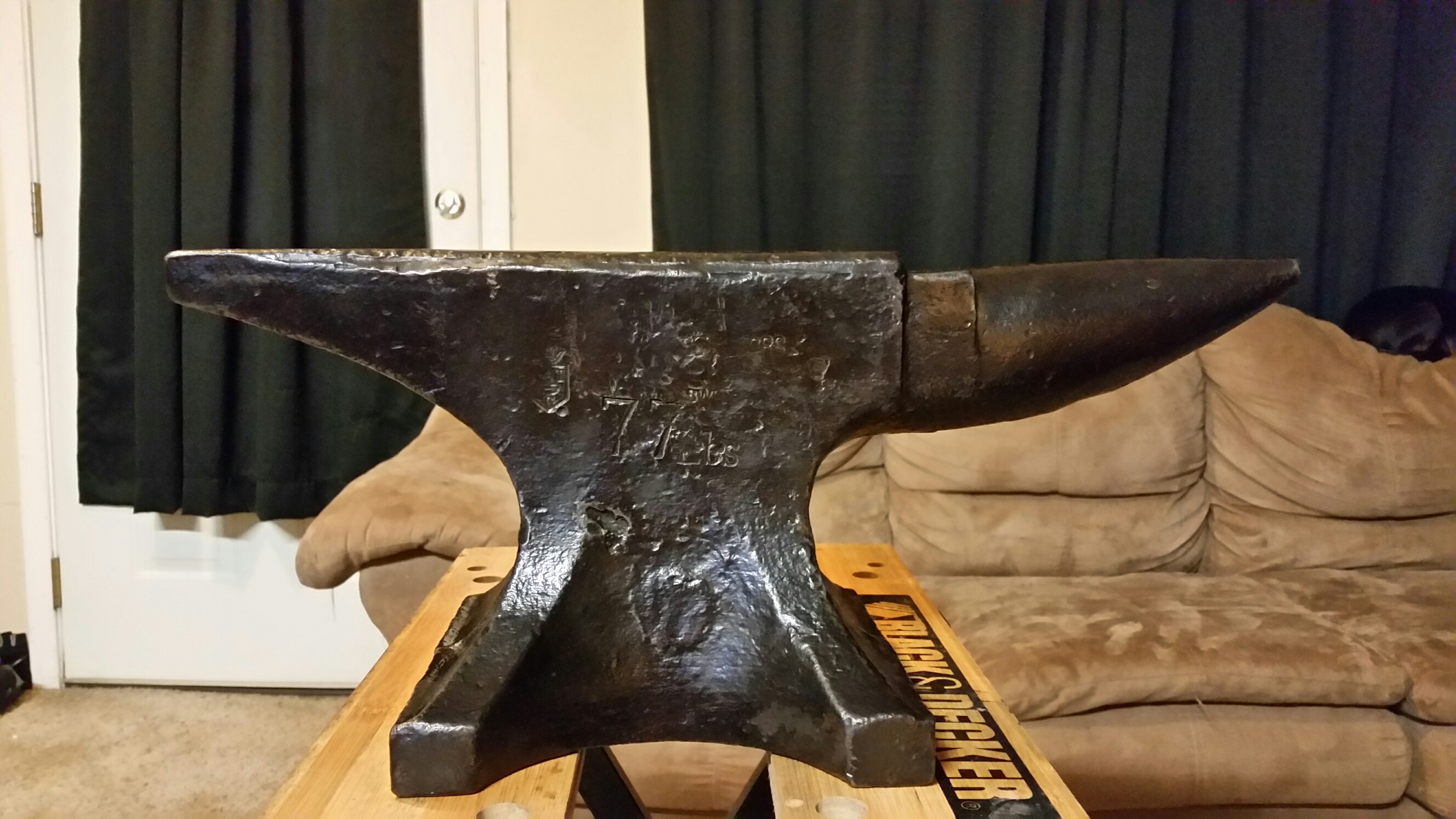

  5. Well I am the proud new owner of the Soderfors Anvil, the ball baring would bounce back 100+ % from one end of the Anvil to the other. And the small pall peen did the same, decent ring and reflected back to the same height I would drop the hammer from with light strokes. Little deeper ring in the center with a high pitch ring toward the ends like a bell.
