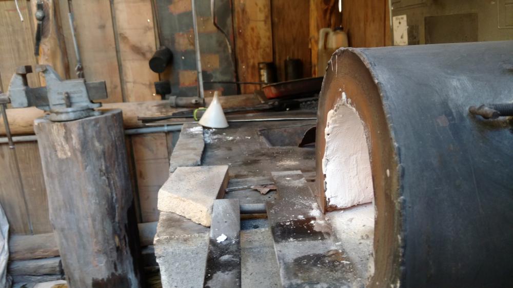

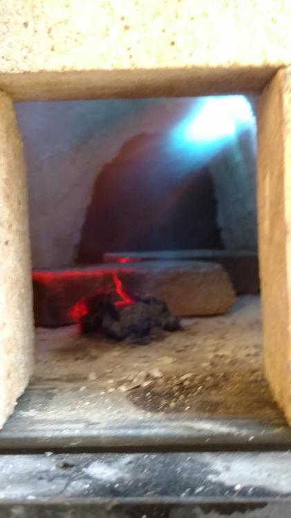

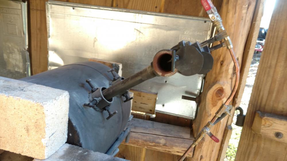

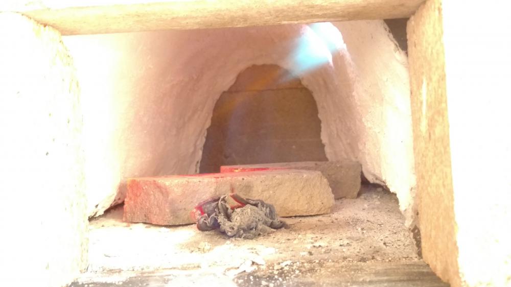

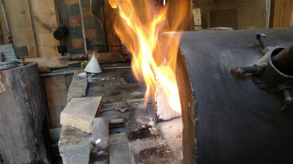

The volume of the chamber is less than 577 cu in. I say less than because it is d shaped. I measured the radius with a approximate center between the base and top. The burners are 3/4 and are 2 of them. The first pic is choke closed the second is choke wide open across the front. The third is when first started Fourth is after 15 min. The one thing I have figure out is that the ambient temperature outside would have an overall effect on flame temp. But the day I tried welding with it it was 70 deg out. -

Nah I am using .035 tips and am getting a good flame. With the choke I am able to go from dragons breath to an oxidising flame. One question though, what are you using on the bottom to set your steel on so you can grab it with tongs? Frosty I am not sure what more I can say. 1 in. Kaowool on the bottom 2 in the top. Topped off with Refractory cement and metrikote IR sealant. I have tried all pressures from about 3 to 20 psi. -
I have built a propane forge based on Wayne Coe's design using a propane cylinder except I used 2/3 of a forklift tank. http://www.waynecoeartistblacksmith.com/site/mobile?url=http%3A%2F%2Fwww.waynecoeartistblacksmith.com%2FForge_Supplies.html#3002 I also used 2 modified sidearm burners http://www.zoellerforge.com/sidearm.html Yesterday I tried working with it for the first time besides to heat treat. I could not get the steel past a medium orange. What could be some factors causing it not to heat to welding temp?

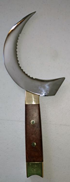

Thanks for the link Steve. Most of my knives have been utility, hunters and skinners, most are along that line. I have even done a commissioned crescent boline. I find that 5160 (probable coil spring)is workable but tough. It would be easier with something not as tough. Looking at specs 1095 looks pretty good. Any thoughts
