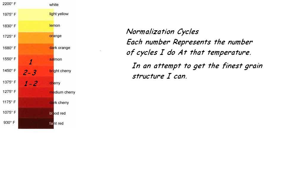

  3. The grain does look a bit large, especially in the third picture. If you do your first normalization at a higher temp say just under 1600 degrees just to make sure you get everything into solution and without really trying to reduce the grain size as much as trying to get it all equal size with this heat, then drop the temperature of the next one to 1500 then drop to 1400 and do a couple at as low of a temperature as the magnet will not stick to you might get finer grain structures that are more equal in size. Make sure you ramp up your heat slowly so you do not overheat the tip or edge. I like to do it in the shade to make sure The colors are not too hot. I attached a picture of a color/temp chart showing the number of cycles I do at each heat. sometimes i will do extra, just depending on if I feel like doing more than usual, and intuition. I tried to take a picture of the grain size i get doing this, but an ipod camera seems to not want to focus very well. I will tell you it is comparable to a broken nicholson file, though somtimes slightly larger but I am very happy with the results .
