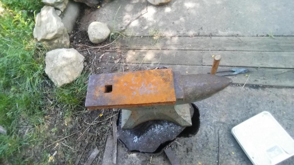

  2. So a few years ago we picked up this 155 pound anvil for around $80. It's performed well for us. It doesn't really seem to ring like some forged anvils I've seen on YouTube, but it doesn't have a dull sound when you hit it with a hammer. Hitting with a hammer results in a pretty good rebound, too. So I'm thinking it may be cast steel, or maybe cast iron with a forge-welded steel plate? The only marking it has at all, is a "70" cast into the side. 155 pounds converts almost perfectly to 70 KG, so I'm assuming that's what the 70 stands for. I'm guessing it's possibly Taiwanese or European? I have no complaints regardless of it's origin. It's done us very well, and the face isn't coming apart/chipping despite a lot of edge and corner work.
