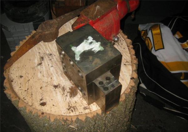

I understand the need for an anchored support for hammering and I'm on the lookout for one but are they actually more effective at holding material more tightly? Do they hold better than a regular bench vise?
I was always told by my father not to force things too hard or too tight so I'm always a little afraid to overtighten my vise when I need to hammer something in it. It's an old cast iron thing that weighs about 75 lbs (with a tiny anvil attached, which I don't use for forging). I've seen videos where users will actually hit the handle of the vise with a hammer to tighetn it as far as they can but just because someone does it doesn't always mean it's right. Is there something I can do to keep my material in the vise so tight that when I hit it it doesn't slide down into the it? Does the "squeeziness" of a vise deteriorate over time? Is this a case where I should just pound on it until it holds my material? The red vise is pictured here (although not very well since I was actually taking pictures of the blocks of steel):
