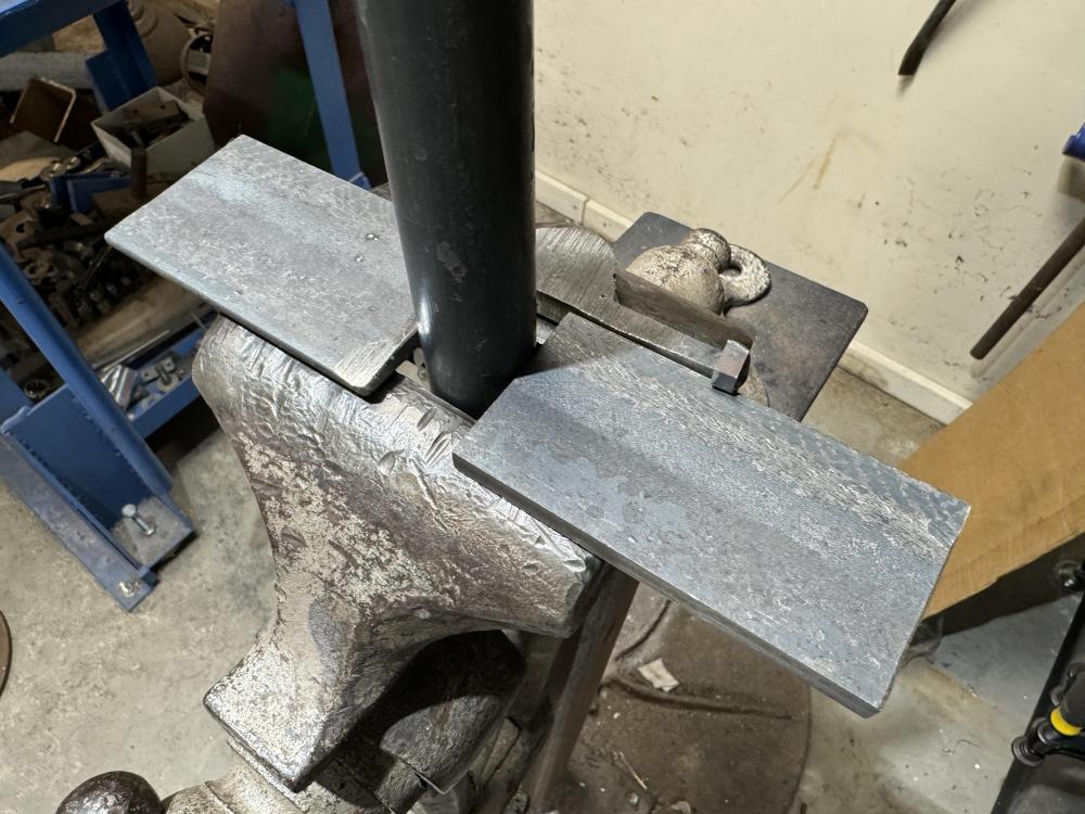

  5. I recently got an induction heater and was wrapping tubing around a round bar. When wrapping the coil in the direction of the vise jaws, the round bar would tilt. I made the device to hold the round bar perpendicular to the vise and to keep the bar from tilting when the force is parallel to the vise jaws. I recently forged a pair of box jaw tongs. The reins needed tweaking in the direction perpendicular to the plane of the vise jaws and in the direction of the jaws. The device let me make both corrections without the work tilting.

  7. Here is a video. You will notice for heavy hitting the two halves of the device separate causing the work to tilt. My Movie.mov The video doesn't seem to work. I put it on YouTube. Here is a link.
  8. When hammering on hot metal in a vise the work shifts if it is struck from the side. The jig pictured and discussed in the video link keeps the work secure when struck from any direction (except upsetting blows).
