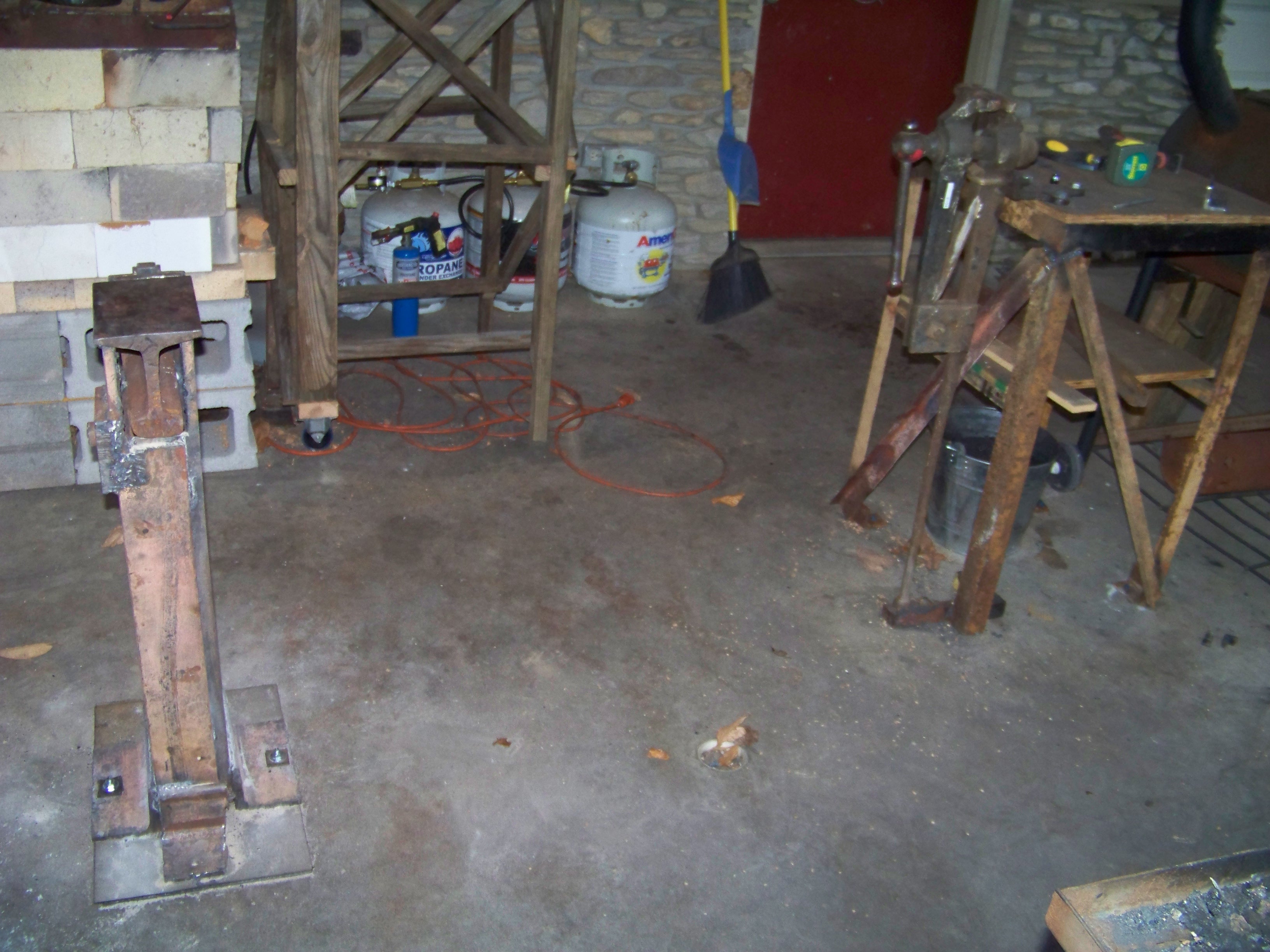

Railroad track anvil anchored
Anchoring this anvil really reduced the ringing. I set it on a couple shingles to isolate it some from the concrete floor. The thing this anvil is missing is tool holders. I may end up going around it and welding on pieces of pipe and such to hold punches and hammers. It is shown next to my leg vise that I really appreciate since I went over a year before getting one!
