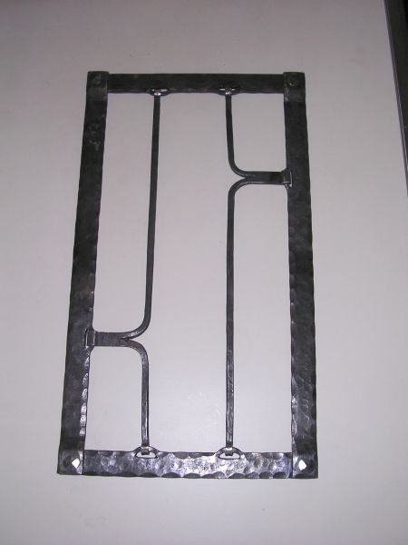

This is a window grille I made for a Public TV Video (a blacksmithing profile). - JK

Nice! I like it for it's simplicity. You split one piece then cut it in two different places to get the offset, didn't you?
- Yes Brian - On the middle parts - I started with 18" of 1/4 x 3/4" stock - hot split for 16" then trimmed off approximtely 9-1/4" on the 1 leg and shaped as seen. The size of the grille is for a entry door window, the grille is 13" x 23" O.D. The outside frame is 1/4" x 1-1/4" flat stock. - JK
