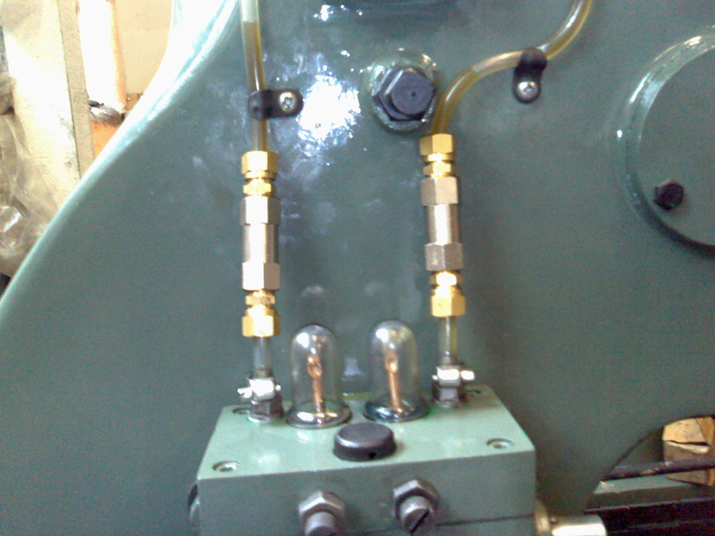

Lube rods Share https://www.iforgeiron.com/gallery/image/24221-lube-rods/ Share on LinkedIn Share on X Share on Facebook {lang="reddit_text" Share via email Share on Pinterest More sharing options... Followers This photo shows the modification I do to the lubrication system on the Anyang hammers, The 15kg (33lb) Anyang hammer only has one oil feed pipe, but the principle is the same,
