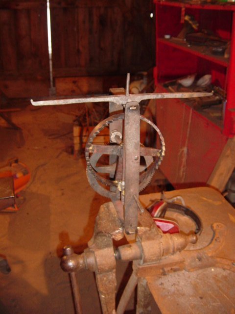

Clock progress
Nick
This is just a progress shot of my clock. I've since gone a little farther, brazed the escapement wheel to the arbor, added the pallets to the verge, and added the lower verge brace. I've also forged the verge and foliot balance, but haven't fitted it to the frame.
