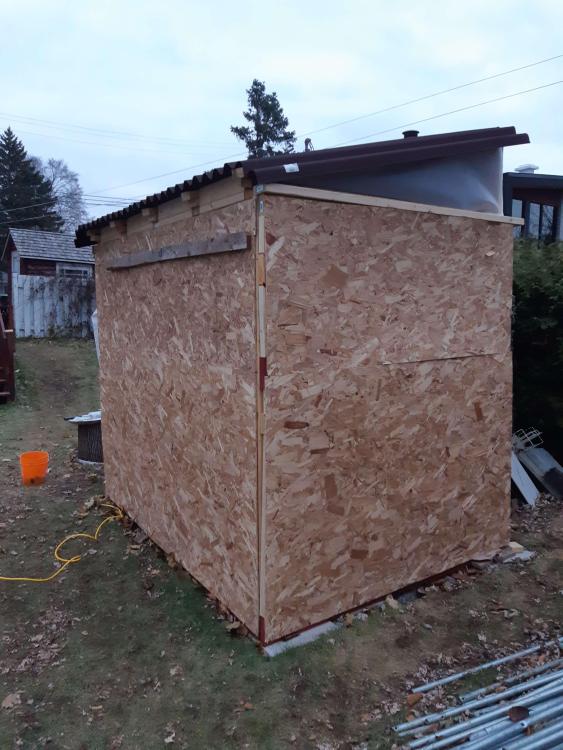

  3. After many months and recovering from a bunch of unrelated injuries later... I finally have this. It isn't perfect, but it'll keep the elements off of my equipment for the winter and let me actually use a belt grinder without too much issue.
