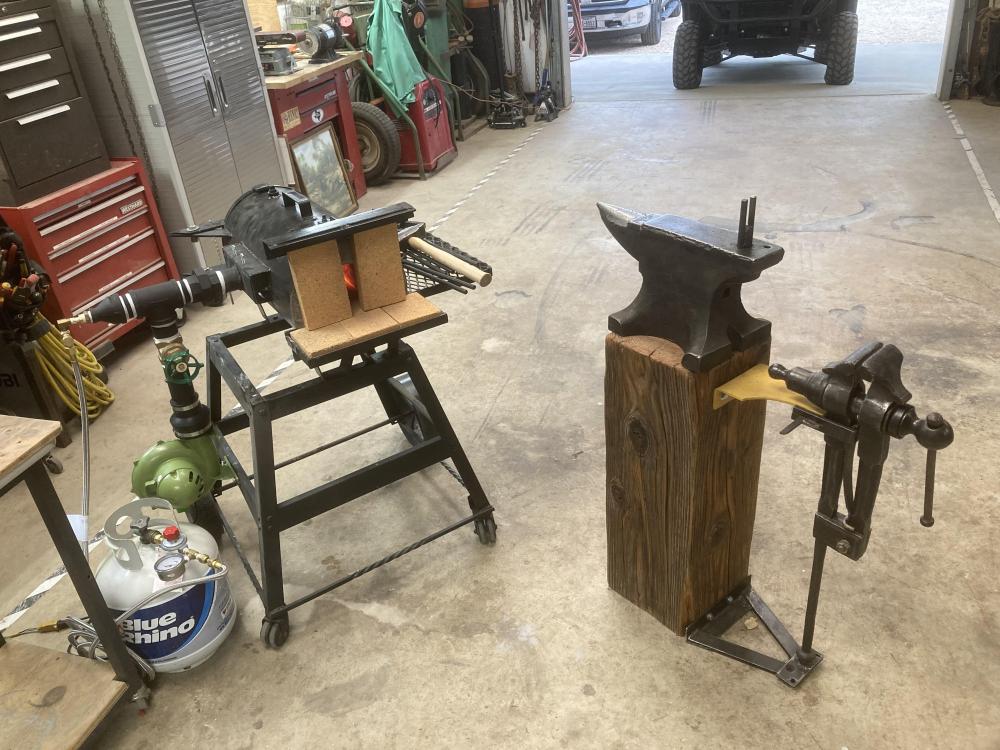

  2. Thanks, I'm sure your right on it being too long. The more research I keep doing, albeit a little late, the more it's becoming apparent that is probably the situation. I wonder if I could cast a removable "plug" out of Mizzou to take up some cu in. In my previous life I would hit BBQ cook offs and ended up building a rather big trailer smoker. The fellers on the BBQ forums had, through years of trial and error, created a formula that would kick out the size of your firebox, air intake, exhaust flue, etc. based off the size of cooking area you needed. I'm sure a similar formula could be created, or probably already has been and I just haven't ran across it yet, for these forges based on the size / cu inches you need.

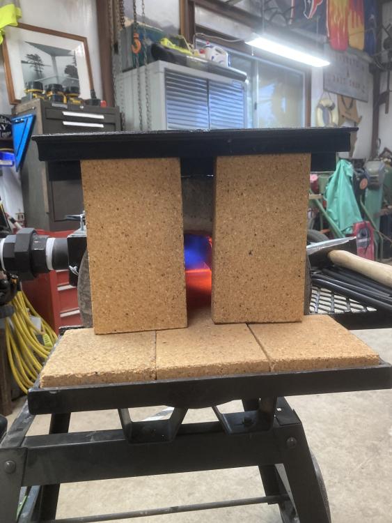

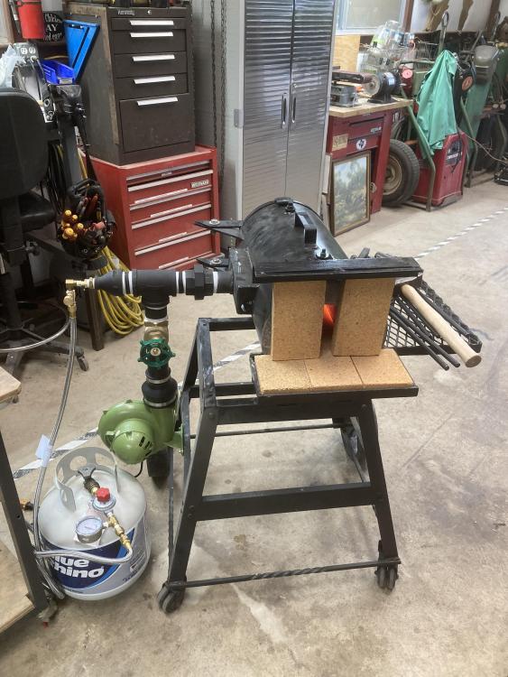

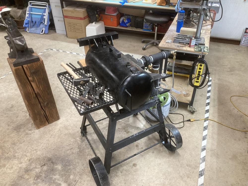

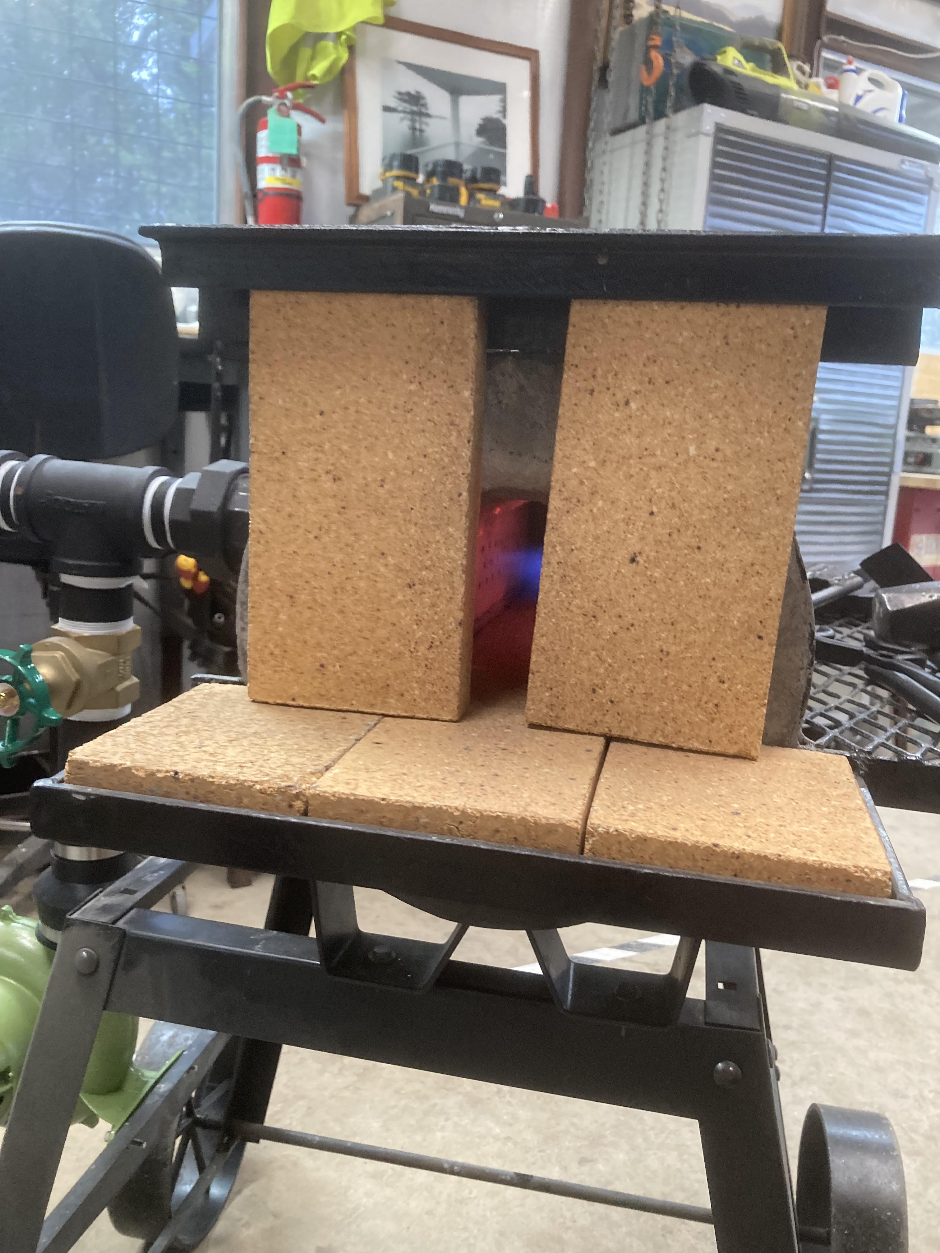

  3. Got my forge completed finally. Over the last two nights been slowly bringing it up to temp. First night let it run at low temp for about ten minutes, last night for roughly thirty minutes at half mass. Gonna crank it up a little more tonight over some drinks. No cracks yet, holding up well. Made out of an thirteen gallon compressor tank, 12" OD and 24" long. Lined with 2" of Kao Wool and 1-2" of Mizzou. I figure I'm setting at about 500 cu in. Ribbon burner is 9" x 3" with twenty five ~1/4" orifices (I used drinking straws). I cast it using Mizzou which seems like a good robust product. Had it running at 1 PSI last night which seemed like I could potentially drop it a little more once up to temp (forging temp not welding temp). We'll see, I'm still learning, fun times.
  4. Thank you all for the welcomes! I've got a pretty decent shop with a pretty large amount of tools and equipment and a hobby of mine is collecting old tools so I'm off to a real good start in that regard. And can see myself welding up hardy's as I need them. There is always a scrap metal pile and welder ready to go at moments notice. I'm getting close to finishing my Ribbon Burner forge (at the risk of this thread getting off topic, I've attached pictures below), that is my first hurdle at the moment. I could pull out the torch, weed burner or get the fire pit going to get some metal hot, but that would only distract me from getting the forge completed. Just need to get the refractory placed and some plumbing done and it should be good to go. Thanks for pointing out the medium carbon items, this is something I'll need to educate myself on. Point taken on the "fixing" the Anvil. Don't plan on grinding on it to make it "better", I'll let the hot iron do the work for me. I put a wire wheel to it and hosed it down with some cowboy cologne (WD-40). I'll check out Balcones Forge. I'm planning on taking a couple classes in a few weeks and in the wee hours when I can't sleep, I'm on youtube trying to learn what I can. Not having much knowledge in the subject though, it can be difficult to weed through some of the "experts" out there. Thanks for the tips. David
