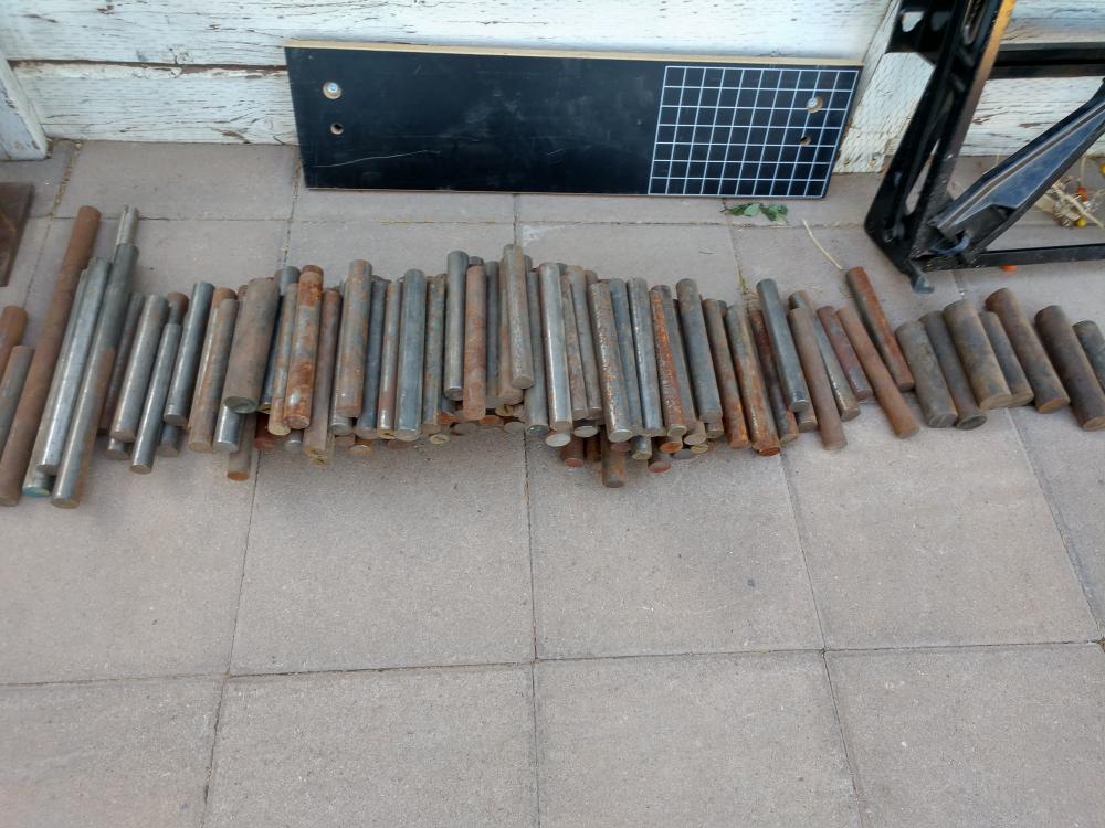

Hey everyone, Today I picked up a bunch of steel. Plate of various thickness and width, mild steel stock for making things, some other odds and ends. All for $90. Mostly, I got a crate full of round stock. A lot of it. I did a spark test, and it looks like high carbon steel to me but I figured I'd would post here to get more eyes on it. What do you think? VID_20201207_192735216.mp4
