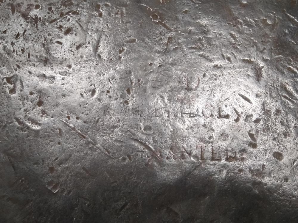

Thank you very much, you are very helpful. I can't even tell you how much I appreciate it, what it costs to view more than 500 pages of a book for a stranger! I also wanted to ask if I can somehow help in finding the manufacturer of the brand resembling the English letter G? (Located on the front sole of the anvil under the horn in the center). I tried to photograph the fragments of the inscriptions, but I noticed something on the back of the sole in the corner. Or do I just see these letters everywhere?))) I have photos of the sizes between the two front legs and the distance between the front and back legs. The size between the two front legs is 39.5 cm (15.35″); Between the front and back legs-41 cm (16.14"). Should I write to Stourbridge to try to identify or narrow the range of manufacturers of my anvil? -

Thank you very much! You said that the postman's book indicated that these anvils had "Stourbridge" on them. On my anvil, I was able to read "bridge". As I understand it, "Stourbridge" or "Sturesbridge" is the city in England where this anvil was produced? I in turn also searched for everything I could in English related to anvils and found an anvil similar in shape to mine. It says "Guaranteed" on it, and mine clearly shows "anted". Can we judge that these 2 anvils were produced by the same manufacturer? In my case, the uppermost letters are very illegible, so it is impossible to tell exactly about the Creator. What does the word "Guaranteed"mean? The book does not specify the years of manufacture of these anvils? Can something be written about the technology of their production? It turns out that the research of your anvil with your huge contribution ends here, because in order to learn more, you need to contact the author of the book? Can it be found in social networks? -

Thank you very much for the detailed answer. I didn't know the book was so new, and I wouldn't want to steal it, but I have a great desire to find out as much information as possible about my anvil. And in my Country, no one has such information, and I have no one to ask. I am very grateful to you that, despite my poor translation, you pay attention to me and spend your time. For me, with the weight of my anvil, everything became clear, and I would also like to find out its manufacturer, year of manufacture (at least approximate) and the text that was written on it. Thank you in advance! I also do not sit still and read all the English-language information about anvils similar to mine. And I found out that they were made not only by casting but also by forging and forging welding. How can I determine this in my case? -

Good afternoon, dear participants of the group. I am writing to you from Belarus, I do not know the language, I am writing through a translator, but I am counting on your help. A few days ago, I came across a large and heavy anvil, the approximate weight of which is more than 250 kg (more than 550 Lb). I can't weigh it for sure, because I don't have such large scales. Dimensions of the anvil: Face width-18 cm (7.09"); Length-101 cm (39.76"), (including a slightly chipped horn); Height-36 cm (14.17″); The size of the square openings 40 mm (1.57″); The size of the round hole is 27 mm (1.06"). The anvil also has square holes under the horn at the front and on the opposite side at the back, most likely for transportation. There is the same square hole at the bottom of the sole. On one side of the anvil, the number 5 and 8 are very clearly distinguishable, which are located on the left and right respectively. In the middle there is something resembling the number 7 inverted to the right (it is less visible). On the second side of the anvil there is a text that has been preserved very poorly, and in which only some letters can be read. Here's what I was able to recognize. Also on the sole of the anvil under the horn in the center there is a brand, presumably resembling the English letter G. The anvil will be used for its intended purpose, but I have a huge interest in finding out what this model is and what it is called, in what year it was released, what factory, how much it weighs, I am interested in the full text that is written on it, in General, any information that relates to it. I am writing to you because I hope that perhaps someone else has the same one, and you can tell me something.
