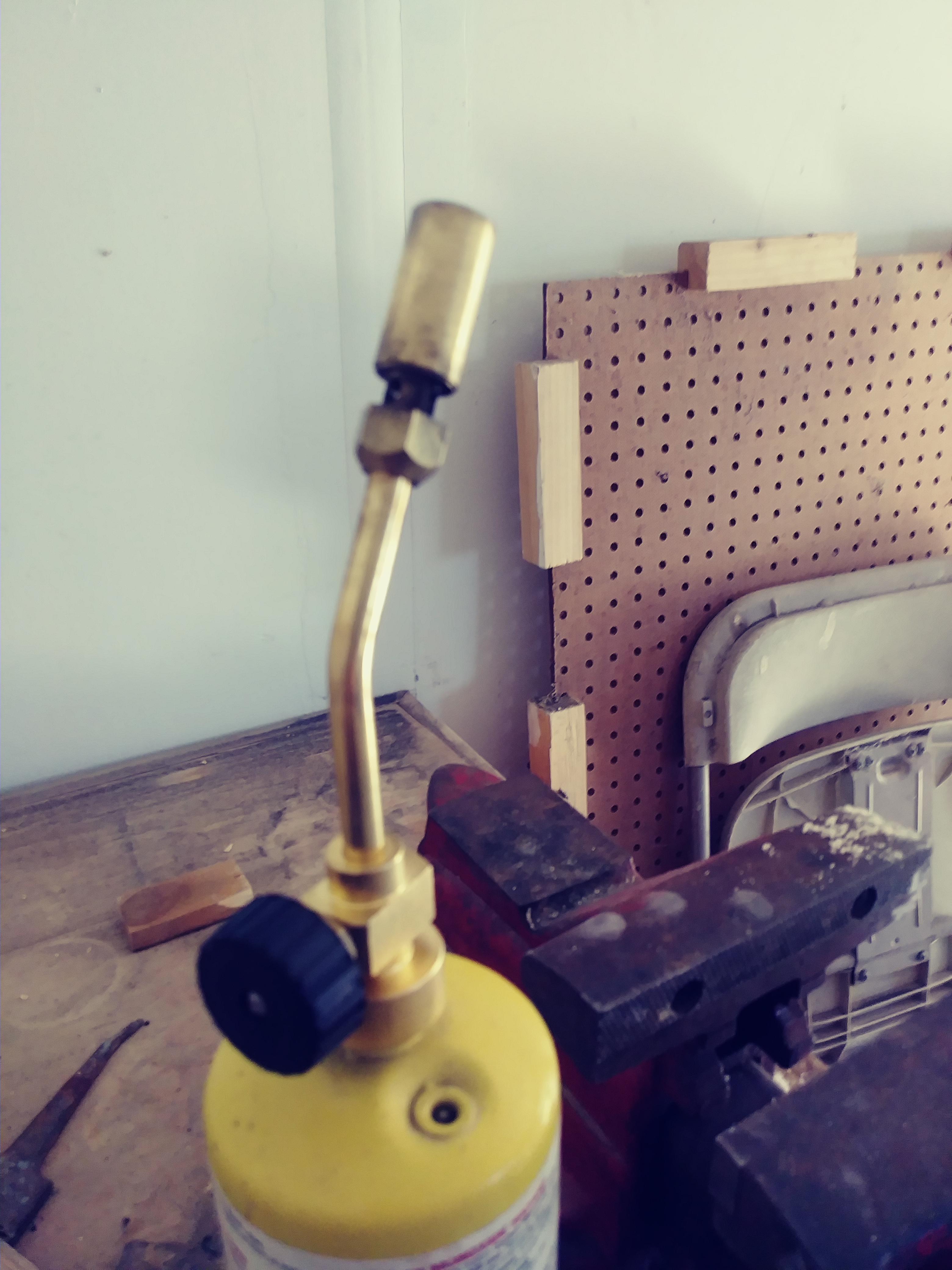

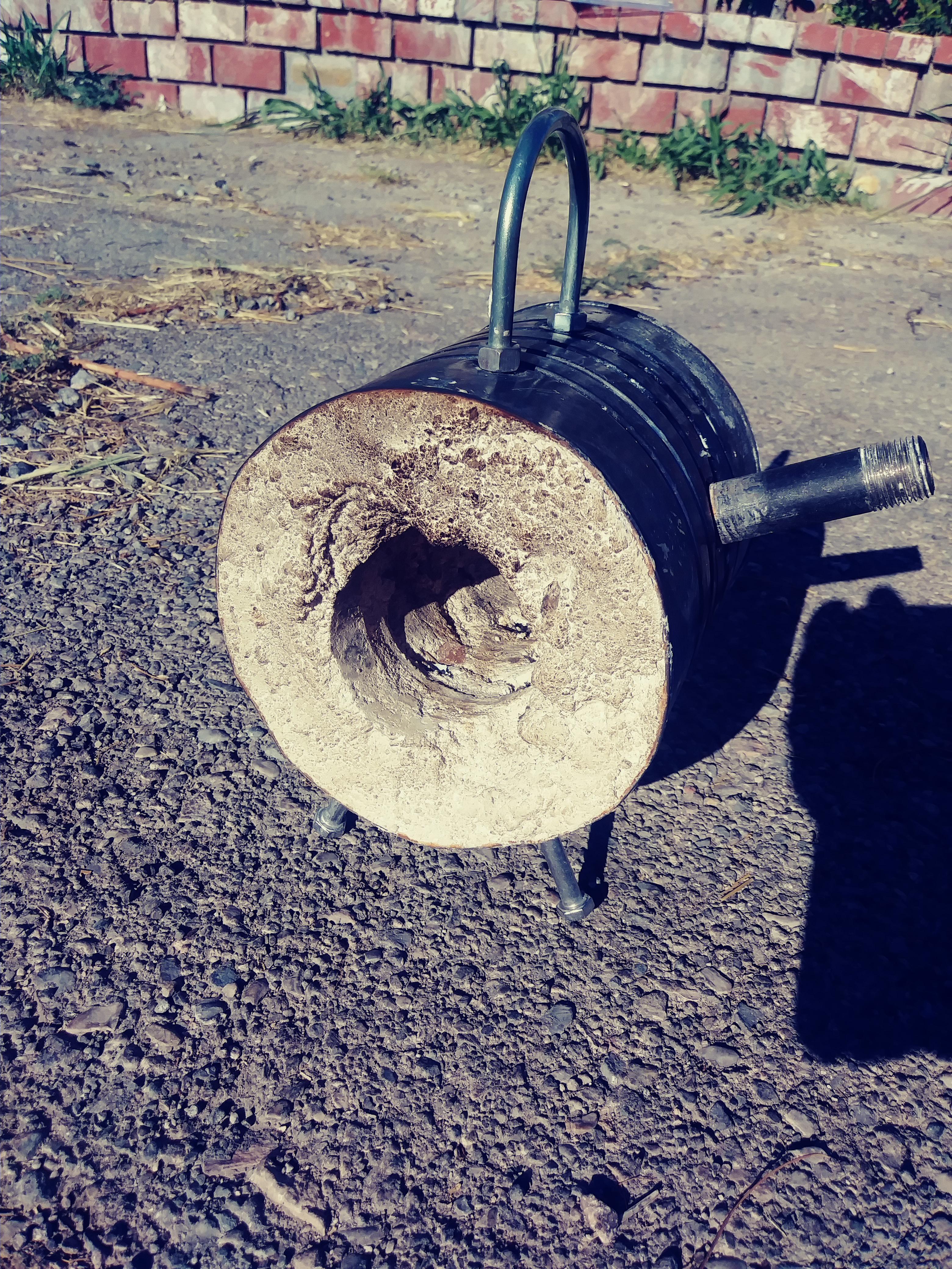

  15. Well now I just feel STUPID!!!!! many, many, many, MANY thanx to you, Frosty. As well as to EVERYONE ELSE who gave me warning. Thank you ALL for responding so quickly, for I might have gotten hurt, or lord forbid... Hurt someone else! So again... Thank you all... Now, I'll start with you, Frosty. I built my beam can put of plaster of Paris, and play sand. It's just shy of 3" thick all the way around. But something tells me that you are about to warn me about using this method of refractory. I was hoping to start small. Using a pencil flame torch, and a 1lb can of gas. But even when I screw the torch head to the 1lb tank, it's like Drogun out there.(the fire breathing dragon from Game of Thrones). So I, of course atopped what I was doing, because there were obviously too many variables for my sake. Here's the photos gentleman. The torch is a brass, pencil flame torch head. And the forge is plaster of Paris, that I let dry in the Nevada heat for just over 8 days before I attempted a test fire. Amd if you havent guessed, I am in Nevada. South western corner of the state (Nye County) to be more precise... Listen everyone... I can't convey how truly grateful I am for your warnings gentlemen. Thank you once again. And I look very forward to more advise, because the last thing I want to do here is give this up! It brings me so much joy! And in not even good at it! HehHeh! -bliziak
  16. I Will work on photos, but it does not matter if torch is firing in or out of forge. (It's a simple coffee can forge) the flames coming from the torch are large and yellow. So big in fact, that I'm not confident firing torch in the shop(indoors).
