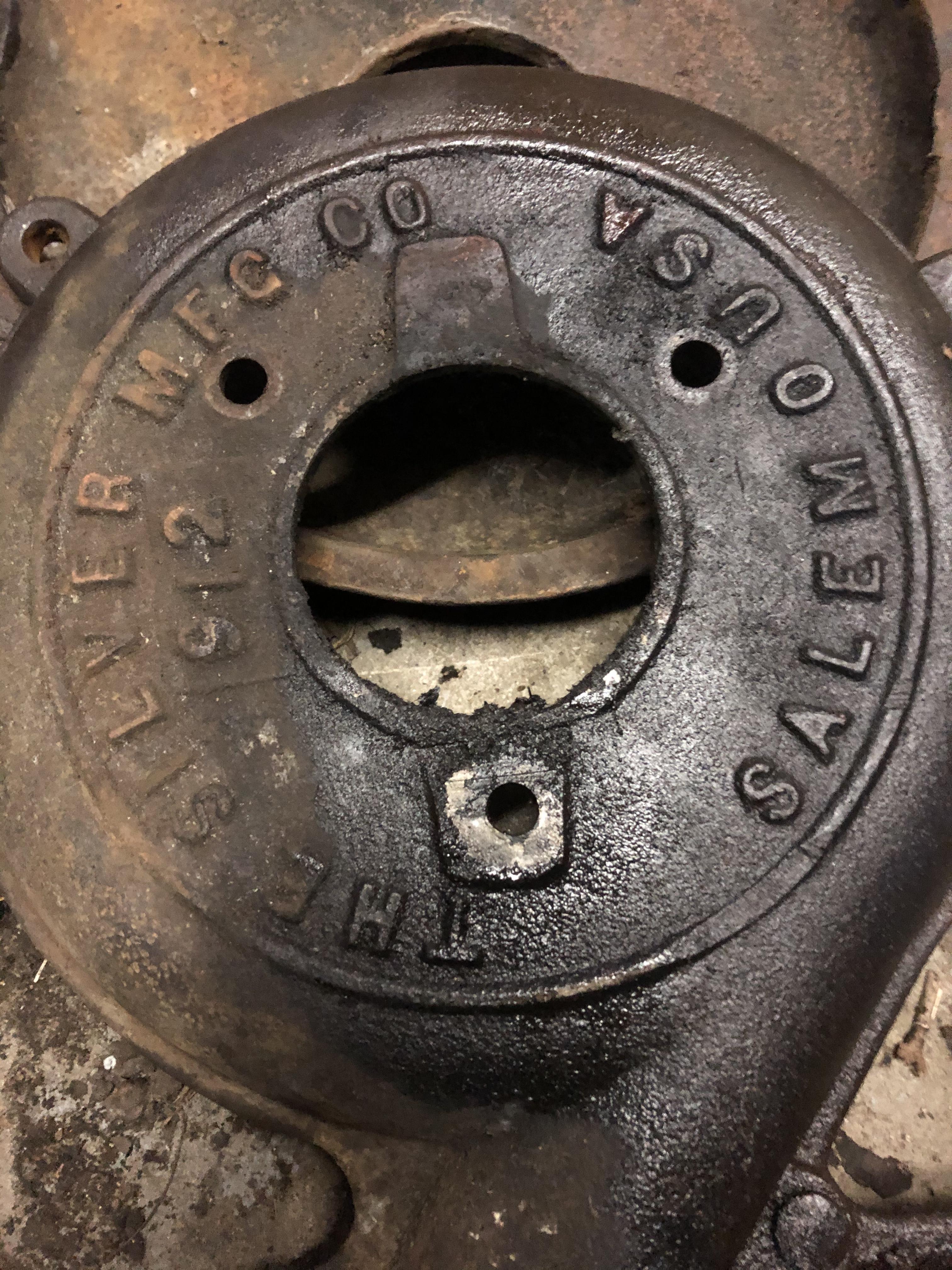

  1. I put the blower back together after I got the creme separator to spin with one finger. Seems to blow like it should. Hopefully put it all together today and give it a whirl.
  2. A couple more pics.
  3. I will give that a try. I am just thawing it out now, as it was in the snow.
  4. Thanks. I will have a read of that. I am going to use the techniques I have read on here to determine my optimal height and then probably mount on a hardwood stump for now. It has been sitting outside for many, many years I think. I have MOST of the debris out from around the gears. Vacuum and compressed air next. I have it turning now. That was half the battle.
  5. Is that bad? I don't think it is the first time. Had to in order to get the gears moving. There was no top on the separator top when I get it.
