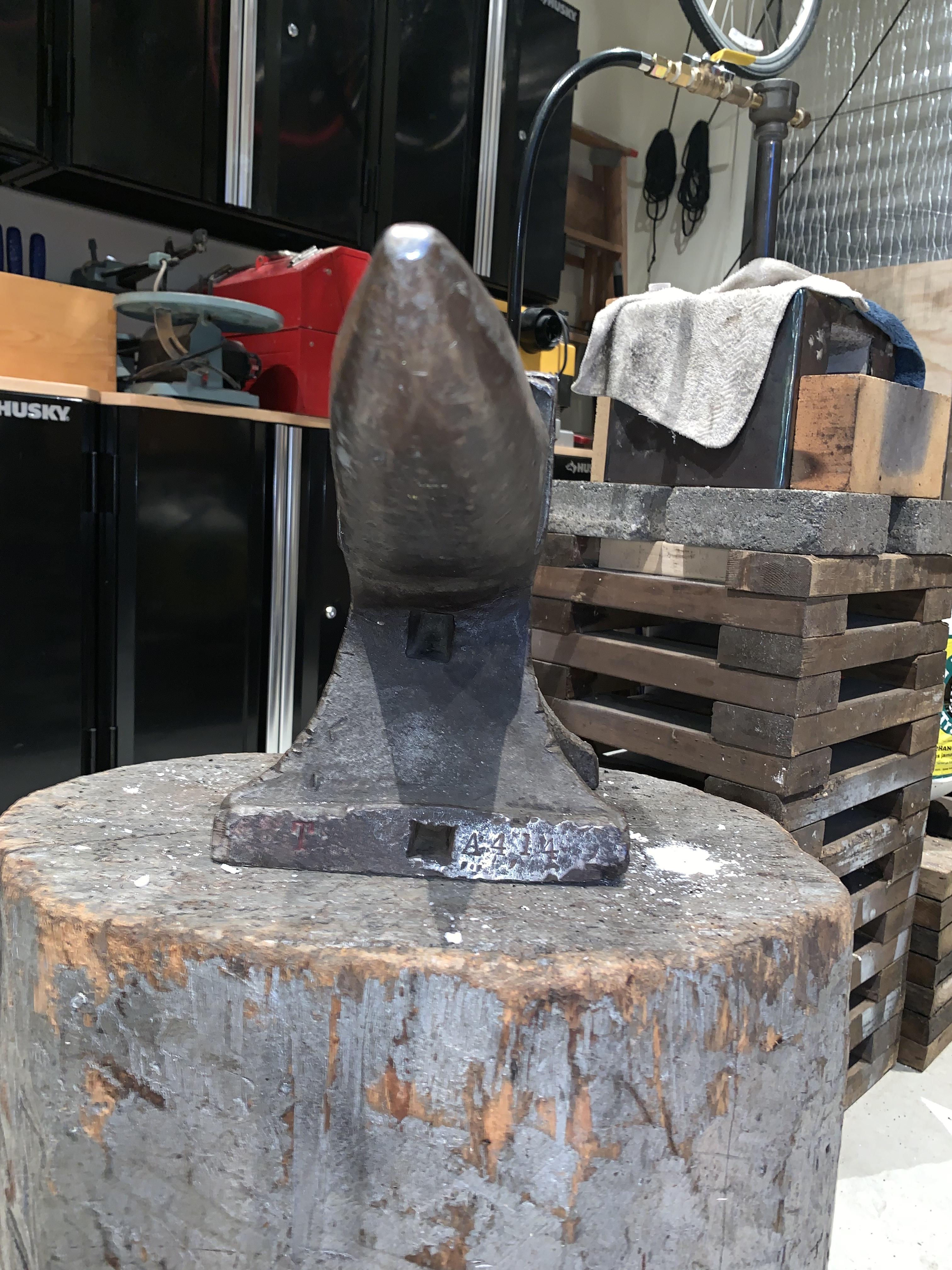

Oh well, not all treasures can be saved. Lucky you for having such a good supply. “Is your anvil good? Does it do what you need it to do without a lot of extra effort? If it's working for you then it's good.” (quoted from previous comment by pnut) yup, it’s a good anvil then! Didn’t know what to think for myself, I was just hoping I didn’t get ripped off. But you’re right, if it works, it works. I’ll make sure to take a look at all the places you suggested. Most of the men in my family have had shoulder/hip issues from sports or weight training, so I’ll downgrade my weight. I am relatively quite strong so I thought ‘big hammer mean more power’, but I need to stop thinking like a caveman! My dad will probably let me have one of his old ball piens to thrash up. “Small face = more pounds per square inch”. I need to start thinking with physics in mind too. Gonna get that hammer control in line now, thank you! xxxx, I hope so! -

I didn’t know the marks on the sides we’re from a chisel or punch, so I learned something new there. But that wasn’t what I was referring to. Below I’ll put a detailed photo of the pock marks on the side of it. It doesn’t ring too loudly but the rebound is around 80%, so it seems to be in good working order. I have done my reading on how to treat the anvil, don’t worry! I won’t be doing anything to ruin the steel face. The guy who sold it to me was just “about to mill the face half a inch down, so it’s flat” for me though, I told him to leave it as is. I almost xxxxxxxxxx when he told me that. Thanks for the info on it, I’ll still be doing more research to confirm, so it helps a ton! -

Sorry, didn’t add enough details of locations, thanks for the suggestion I edited my profile, it should have my location info now. Unfortunately it’s not the anvil you know of. This is from a hospital in the lower mainland of British Columbia, Canada. Sadly, my anvil was being used as a pellet gun target for the past decade. I am in Vancouver, BC, Canada. Money anvil was purchased with is in CAD. So it’d be around $300 USD -
I bought this anvil for around $400 from a guy working in a hospital. They cleared out the old machine and workshop, and decided to sell this anvil. There weren’t many others for a price as good as he offered, so I ended up making the purchase. However, I can’t seem to figure out what the make of this anvil is. I originally thought it was a Trenton, but now I’m leaning more towards it being a cast steel Swedish, but I could be wrong there too. I have only been blacksmithing more seriously for about half a year, and I need an expert’s opinion. The anvil is 135lbs, and was acquired by the hospital in the early 1950’s.
