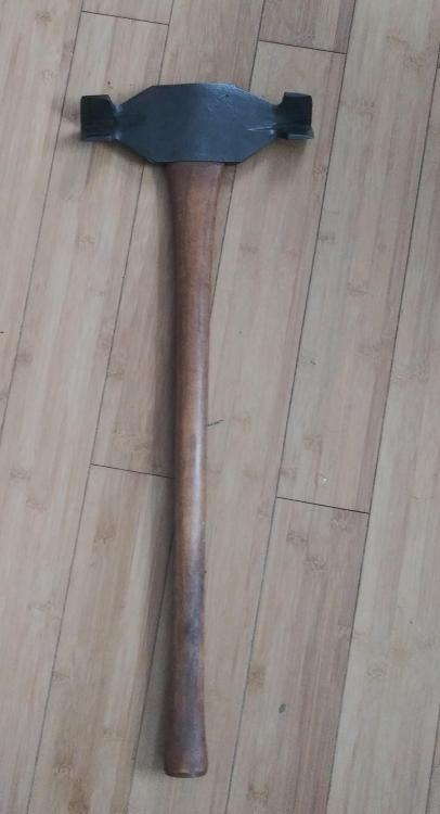

What is this axe????
Matt Scanlan replied to Matt Scanlan's topic in Axes, Hatchets, Hawks, Choppers, etc
Once it gets started I just ride the blade down the groove with a back and forth motion. I'll post a video once I get off at my day job. -
Agreed. From personally testing it, swinging it like an axe or adze is pointless. That long handle lets you get alot of force behind it as you push the blade down the work piece. Also allows for very controlled changes of angle if you want to change direction or widen the groove -

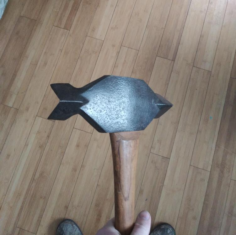

I finally got it in the mail today but didnt get a chance to test it on anything yet. I do want to say its hand made, theres a few "errors" I can only attribute to human hands. For instance the bevel on the right is not a perfect 90 degrees to the handle. If it was machine made I can't see that happening. The body of the tool looks reminiscent of a double bit axe. The head weighs about 8 pounds, the blades are 72 degrees so I guess that rolls out a being used to make a square mortise. Actually holding in my hands didnt bring any light to its use. Also no touch stamp, brand name, or date anywhere on it. The pitting on it also isn't uniform, not sure if my pictures do it justice but there's a varying range of large and small pits, biggest one being about the size of a pea. -
Oh I'm well aware that we have lost more knowledge that we have gained over the century's. That will be curious to test out. And you win a lifetime supply of gratitude lol. When I get fixated on learning something it can drive me nuts. -
Correct me if I'm wrong (happens more than I'll admit) but chinking is filling the gaps between two logs on a log home. With the blades at 90 degrees to the handle it seems like it would be a very awkward way to use the tool. Or are you talking about before the logs are in place.
