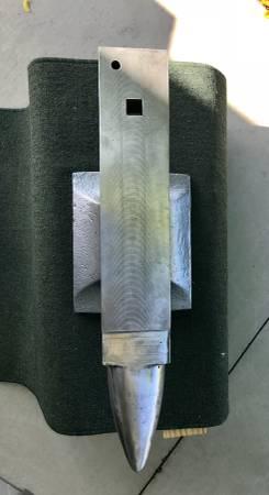

  1. As I said in my original post I have a section of railroad track that I’m using. I have taken a few classes and find working on a stable anvil with a flat face as well as a rounded horn to be more enjoyable and productive.
  2. Based on the provided link it appears most believe it to be too high. The Anvil below was also on my radar. I liked the peter wright for the history and I could not find any information about this anvil. The closest was a post on Bladeforums asking if another anvil may have been made by Doug Noren. This following informstion is provided “158-160 lb. 8640 cast steel anvils. The anvils are hardened and tempered to a Rc hardness of 52-55 and have excellent rebound. The work surface is 4" x 16". The hardy hole is 7/8" square and the pritchel hole is 1/2" diameter.” Based on the top view it appears to have been milled and I know the raised letters in the name indicates it was cast. However that is all the information I can gather. Has anyone heard of this brand of anvil? He is asking $850
