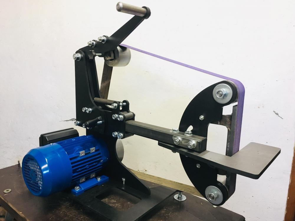

  1. Small upgrade of machine. This time I'll try resize photos And... voila! Enjoy Best regards: Maciej

  3. Polish_Grinders joined the community
