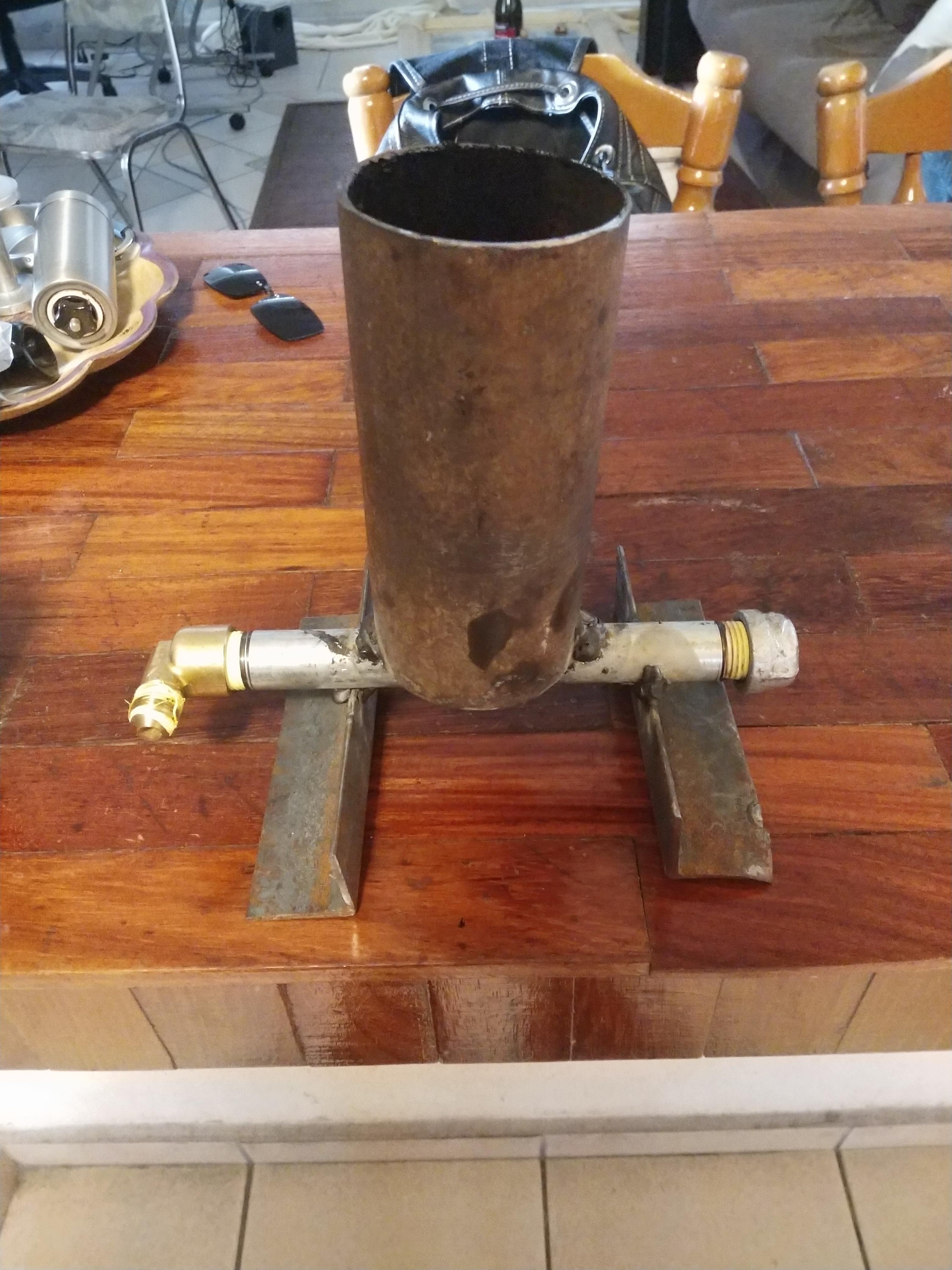

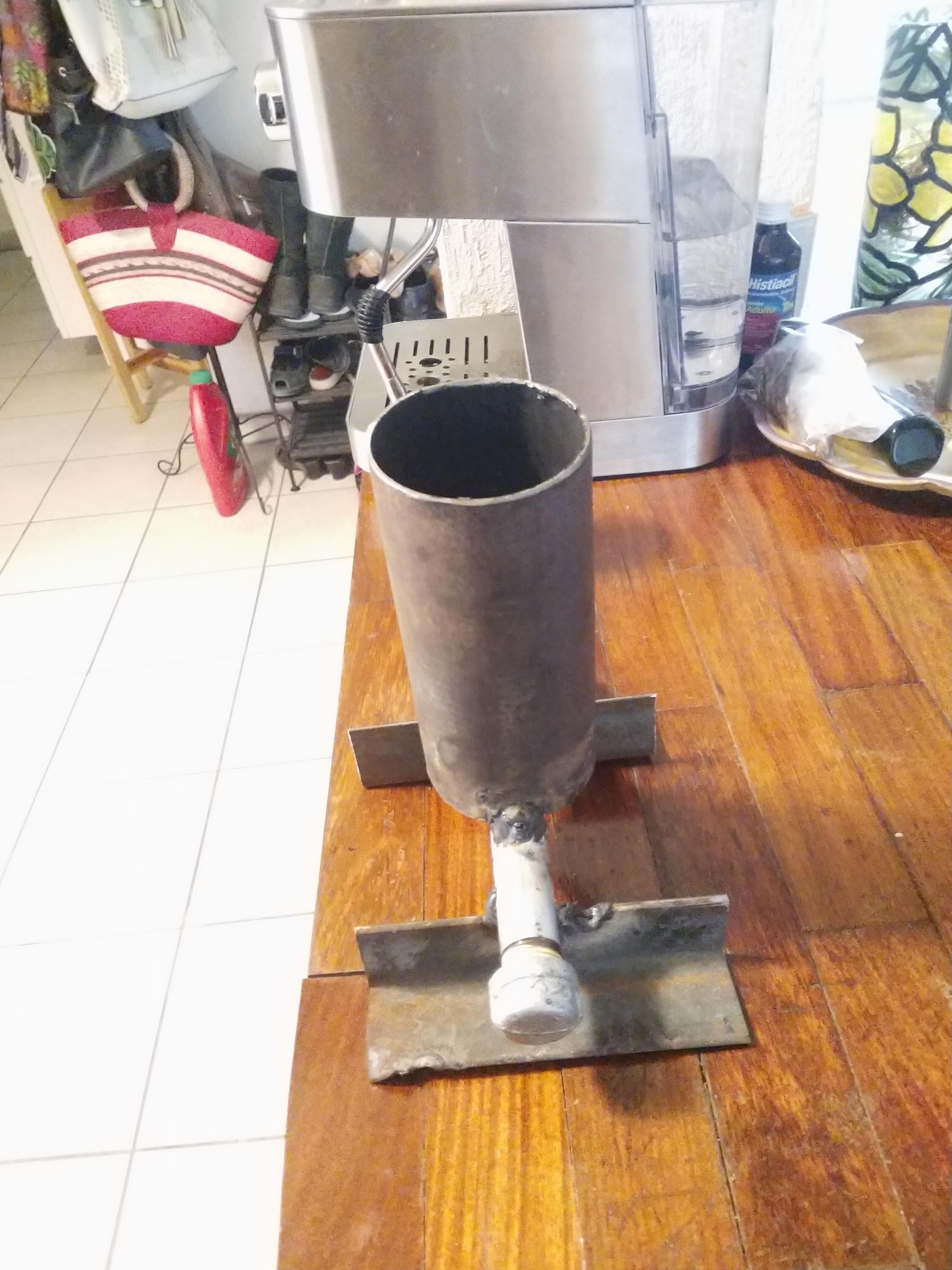

Here's the "finished" product. It doesn't look great, but it's working pretty well. I might get a nicer one made in the future now that I know exactly what's involved. A mechanic friend of mine had the flare end made at a different muffler shop; it's crude but suits my needs well for now. I'll change to a smaller MIG tip if I have a chance tomorrow to try to get rid of that yellow flame and post back tomorrow. VID_20180921_185126.mp4 -

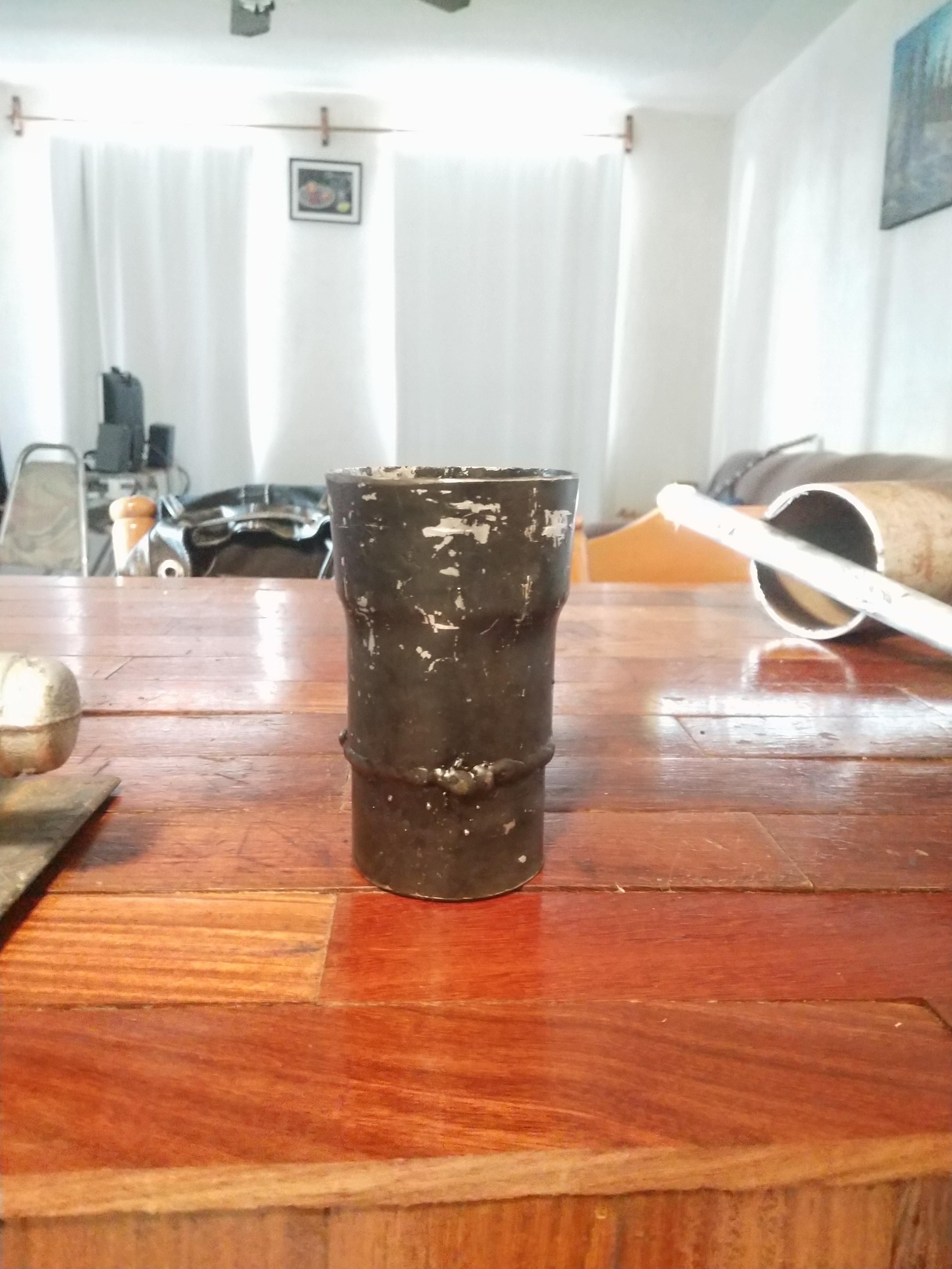

Haha glad to see we've created a new word, now we just have to send it into Webster and see if it makes it into the next edition! Just an update, the muffler shop around the corner had a scrap 2.5" exhaust pipe, it was a piece with a lot of bends but the straight part was enough to get my piece out of it. The old guy that helped me didn't seem to have the best welding skills in the world, so while I wouldn't trust my car to them (good to know...), he was able to get my burner put together. I'll post pictures and a video in the evening (so you can get a better look at the flame). I'm going to change out the MIG tip as well to see what effect that has. Thanks for all your help guys, you're the best! -

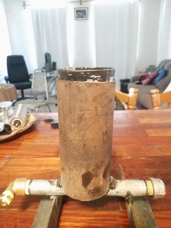

What if I got a 2.5" exhaust pipe welded onto the burner body for the mixing tube? That should be ok, right? It would be a lot easier to find. -

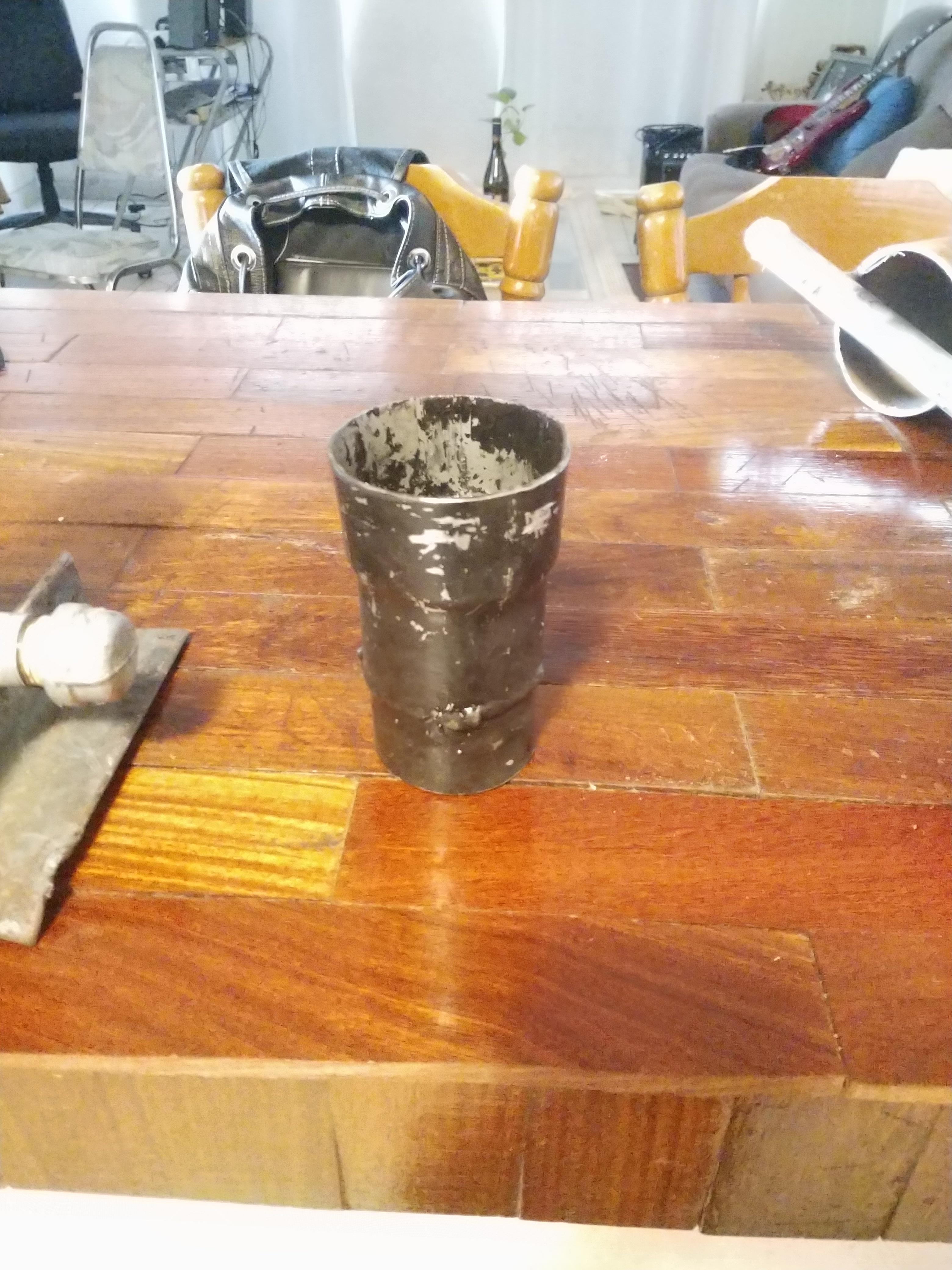

Hey guys, I was sitting at the dinner table finishing the can of Guinness that I drank with my stir fry (that I made on my indoor gas range), and I started thinking that the tall can was almost the right height and diameter for my purposes... so I took a pair of scissors to it, cut off the top and the bottom, and cut open the top to use as a flange as John recommended. Would you believe that it worked?! So know I have a good idea of what size pipe I need and I see that my problem was definitely having the wrong size mixing tube. I'll keep you posted on any further developments, thanks for the tips! VID_20180920_190437.mp4 -

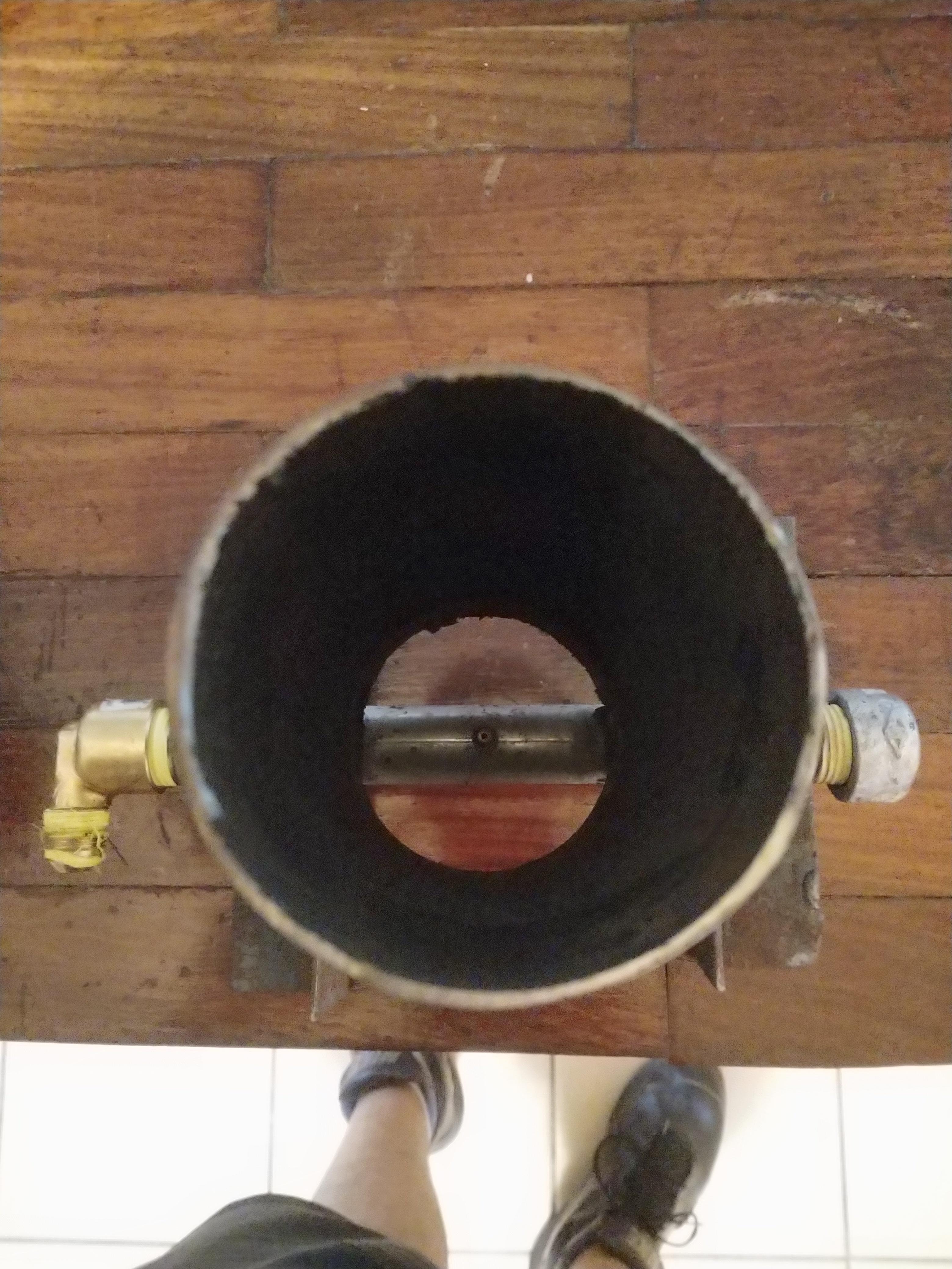

Hi all, thanks for the replies. In the video that I took showing my problem, I had a test shroud on that is 4" ID. I have a welded prototype that has a 3.25" ID shroud made of black pipe, they are both 6" tall as per the plans. It's very hard to find the exact pipe that the original builder used down here, but I will keep looking for something smaller and as Buzzkill and John recommended. John, what do you mean by putting a constrictor inside the mixing tube? Is that something I should consider doing too? And Frosty, thank you very much, I actually do intend to use this burner for wok cooking. -
