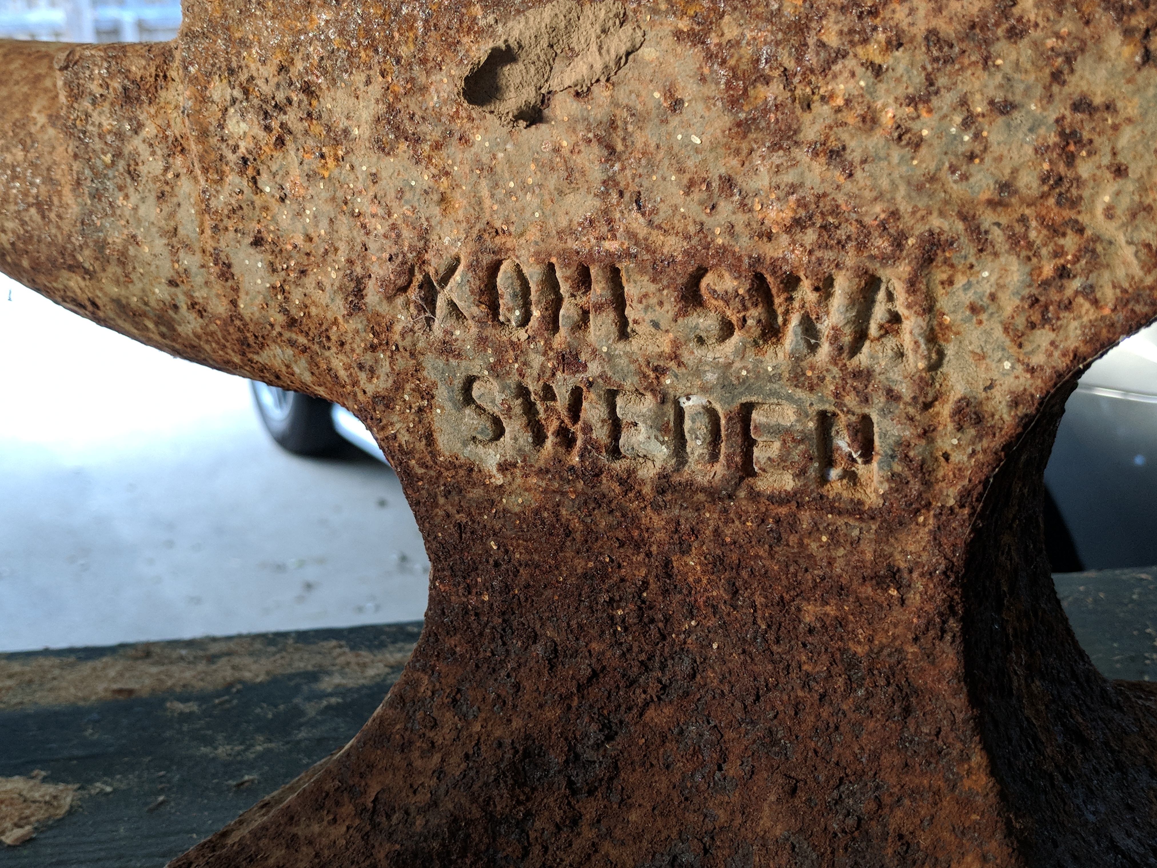

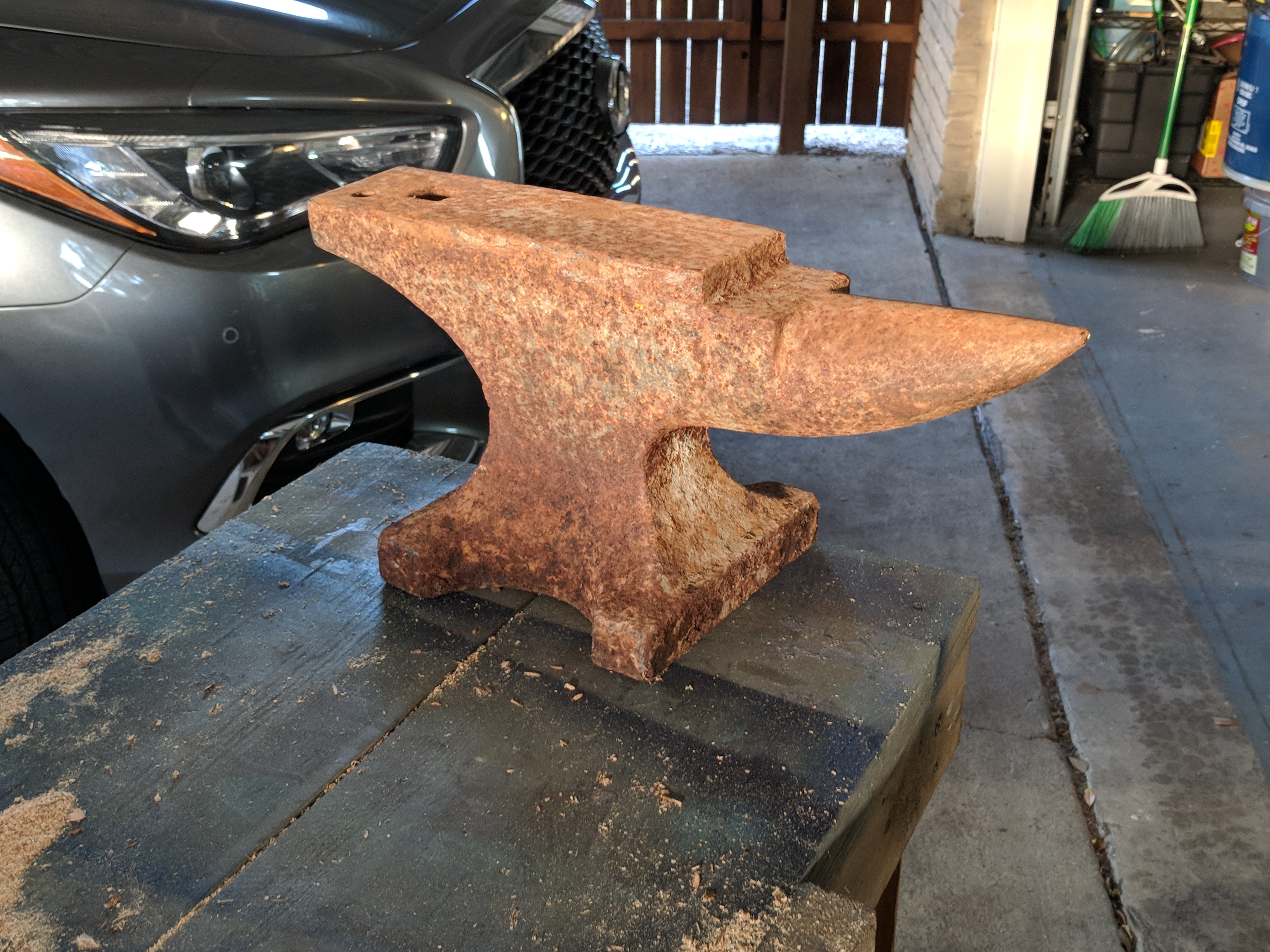

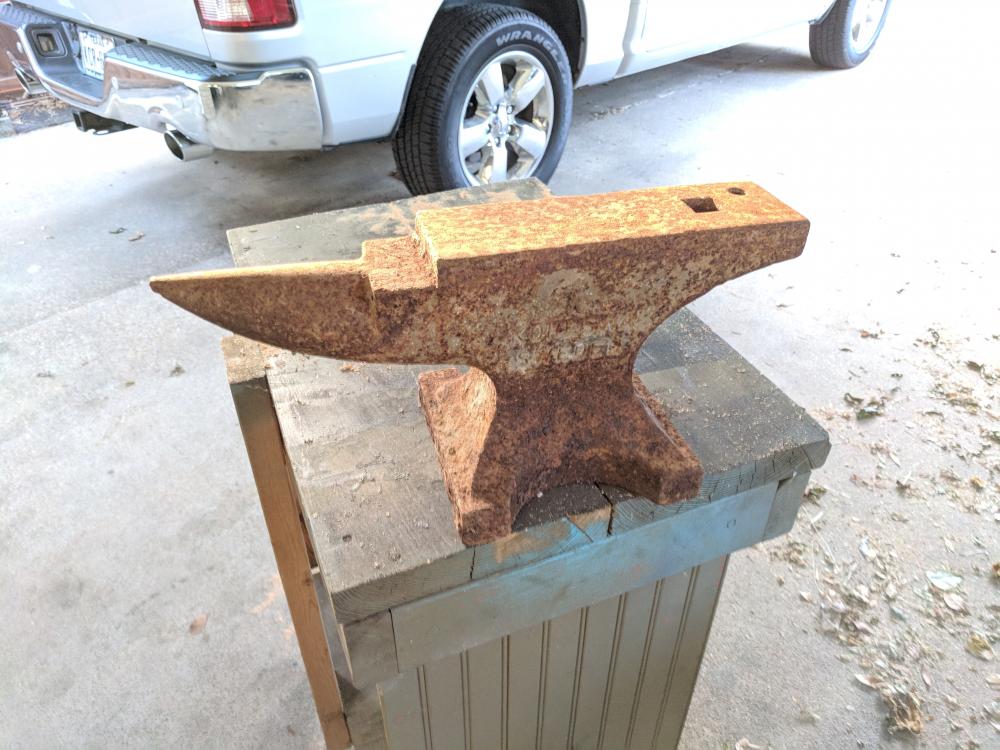

Evening fellas! I thought I'd give everyone a quick update on where I'm at with my Kohlswa! I decided to try something new with de-rusting this fella. Electrolysis. Firstly, I'll say that it's incredibly simple to do. That said, my anvil is still sitting in the tank, so I don't know how it'll end up in the end. Here's was my quick and dirty set-up. My wife walked out in the garage to ask me if I knew where the purple rubbermaid that she had just emptied and left in the living room was and caught me drilling holes in the side red handed. I, of course, denied any knowledge of the whereabouts of it. I don't think it worked, but she turned around and walked away, so I carried on. Wired ten 12'' pieces of rebar together around the edges and put a bolt through the pritchel hole. Mixed up the washing soda (sodium bicarbonate) and added the anvil to the mix after taking a wire brush to it to knock off most of the loose scale. Powered on at near near 6pm sharp. Bubbles started right away...that's a good sign: 30 mins later: Just checked it a few mins ago (now 10pm). It's been in four hours now. Can already tell a big difference: Stay tuned for more updates!

Hey fellas, I'm new to the forum and I should just come out and say it...I'm not a blacksmith...just yet anyway. Right now I'm pretty constrained by my location - I live in a city suburb right now and just don't have the space. That said, I do have a nicely outfitted garage and while I don't smith, I do find having something around that I can hammer my projects on extremely useful. That said, I've been using this cruddy, 55lb (actually, 52lb) Chinese anvil for quite awhile that until recently, always left transfer marks on my work pieces because of the poor quality grind on the face of the anvil. Last weekend, I was doing some work on a project and in my haste I forgot to put down my metal flashing that I used as a shield to keep the pieces from getting transfer marks. My project was ruined and I was fed up. So I did what I know I'm not supposed to do and took my angle grinder to face and smoothed it out. While I was at it I stripped the paint and smoothed out the casting marks on the horn. After which I coated it with boiled linseed oil and let it cure in the sun for a week. Turned out nice...but I was basically putting lipstick on a pig. Well, all that said, my neighbor and I were talking and I mentioned that I was looking for a better anvil because of the aforementioned issues. He said that he's got one out on his farm that he'll get for me next time he runs out there. It was apparently his dad's and it was old and rusting away and he was just happy to give it to someone that would take care of it. He called me today and told me he had to run out there this week and brought me the anvil. He knew nothing of the brand or the size, but free was free, and knowing it was old, I could only assume it was better than what I am currently using. So it turns out it's a Kohlswa 70lb anvil. I don't know much about anvils, but from what I've briefly read, it seems that this is quite a quality anvil. As you all can see though, it's pretty rusty, but otherwise in pretty darn good shape. How would you fellas go about rehabbing anvil? I'm thinking of taking a wire brush to it to knock off the loose rust, then putting it a tub of Evaporust to remove the rust, and then giving it the same boiled linseed oil treatment. Would this be a suitable thing to do with an anvil of this quality? Additionally, would using the same anvil stand that I've been using for my crappy anvil suffice? Or should I look for a large stump? What is the best method of affixing this anvil to the stand or stump? I friction fit the Chinese anvil into the stand to secure it. It was in there and didn't move, but I don't know if that is proper? Thanks fellas, I appreciate your assistance! S/F, -Matt
