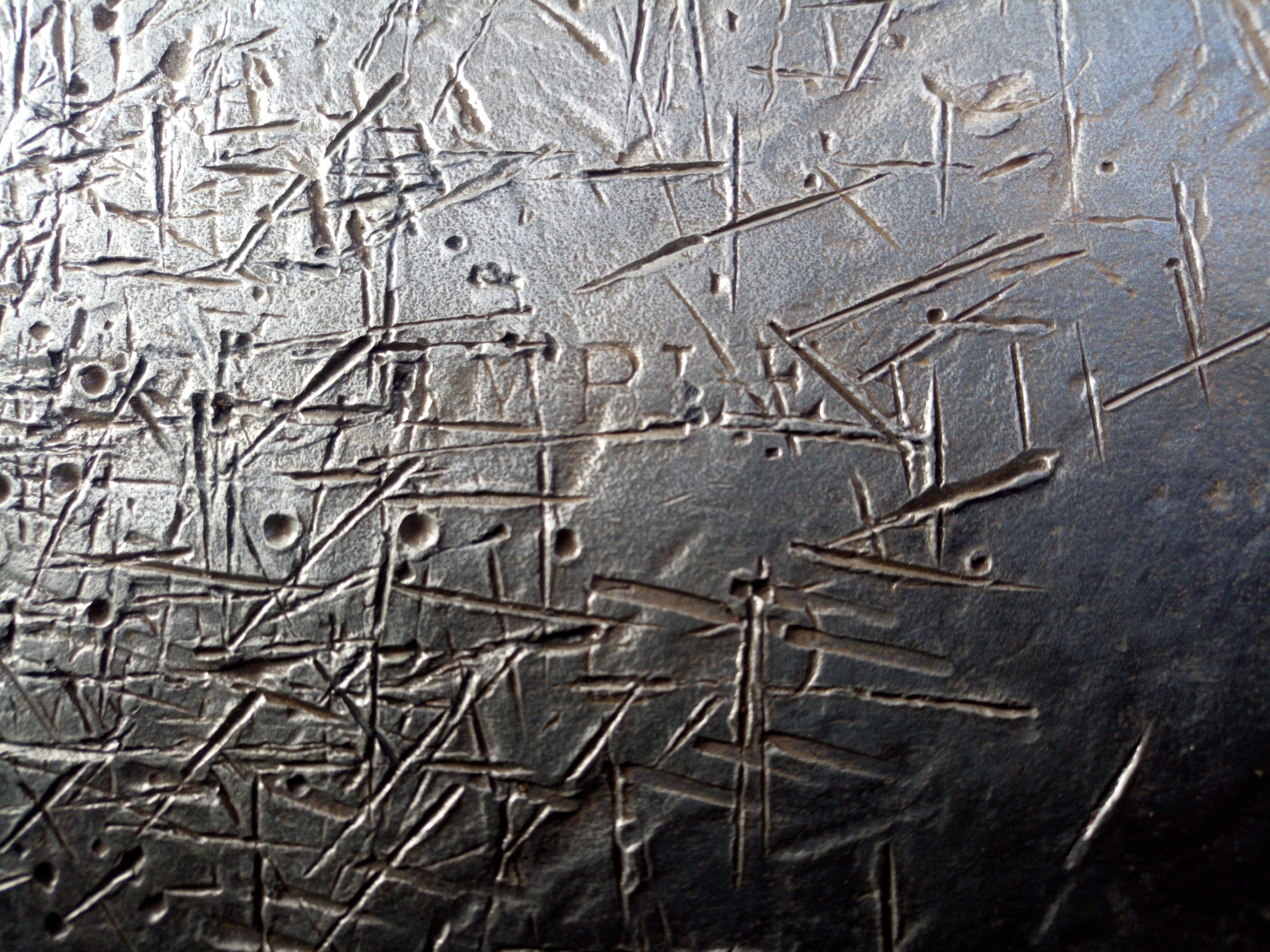

  2. Guys I finally found it! It is another forging company in sheffield called MOSS & GAMBLE BROS MOSS & GAMBLES SHEFFIELD that took somework! definately the spitting image of a later mousehole though Im thinking it was made around 1910 or afterish?! how do the serial numbers work?anyone know it isnt the 32nd thousandth one they have knocked up?!! the early ones are just like the early mousehole anvils too! seems they have been copying or vice versa. Well I know you will all cry about sanding into that face of hers but I cleaned it her up a bit earlier and sanded the welds off but still heavilly dinged up in the main worked area. I then did a ball bearing test and guess what the "work hardened"area is the worst section maybe 50 to 70% but that could be becuase its so dinged up the ball doesnt connect quite as good,whereas the areas that are not really worked and not "work hardened" like around the heel rebounds at 90% or so basicly I drop the ball and it comes right back into my hand at the non worked areas. also all the weld beads when ground off have hair line cracks around them, so might have to go a bit deeper sorry! might heat and fill some of the dents up too you guys are gonna hate me! I mean the plate is a good 10mm thick and when hardened from new they must have heated more than 1mm deep of the face ,in fact not to do so would be nigh on impoosible! this anvil rings so loud! I dont think ive heard one as noisy to be fair ! thin waist and solid I guess. Frozen forge thanks for the tip I will look into pexto tooling! And Im glad you can see what I mean with the weld globs, some people eh! Thanks for the input you guys!
  3. just scuffed her up a goodun! cant see any more letters other than its surely MBLES, however there is some pretty clear serial numbers on the front left foot #32707 and a sideways 0 I think on the right.the hardie hole near the bick is massive and tapered making me think its some other kind of tooling hole, if only it wasnt chiseled to death on the side where all the writing was oh well!

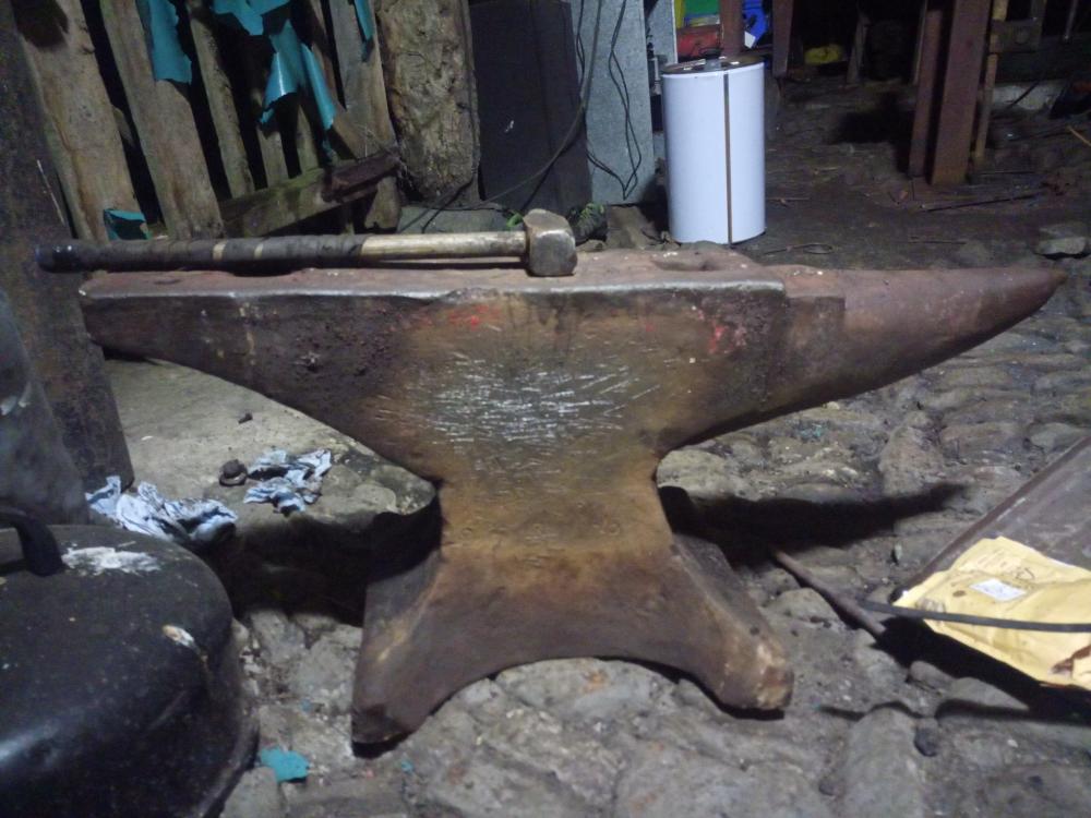

  7. thanks for the input there tom, apologies for not using the word "hole" after the word hardie! I know there are many unbranded anvil makers that sprung up in the uk and I also know thatmany unbranded anvils were made by the big brands for certain companies who sometimes wouldnt want the anvil manufacturers logo and name on them and often wanted their own. perhaps why there are so many brooks anvils knocking about with the word brooks ground off them I dont know, and as this is a twin hardie "hole" anvil it is most likely made for a specific industrial company. I agree she is thin in the waist and got them curves tom compared to most mouse holes out there and over there too but I have found examples of what looklike identical twins apart from the additional hardie hole like in this youtube vid from eastern europe somewhere, and the later mouseholes seem to me to get longer and thinner in the waist like like on this thread with images from the book the later one at the bottom has the same tall thin waist and angles looks pretty close to me but obviously could be someone who ripped mousehole off and set upon their own next door and copied them who knows ! here is another example of a large mousehole that seems to be the spit with the thin waist pattern let me know what you think ebay link removed
  8. Hey , Ive gone a bit anvil crazy the last few weeks and picked up one today,was hoping you guys would be able to identify it. the pictures i saw before i bought it didnt have any marks, and was only a picture of the side and I was convinced it was a later 1903 mouse hole anvil by the shape of the waist however now ive got it, it has two hardies and the area with markings is all chiselled up but I can clearly see the letters "MBLE" but thats all ive got, anyone have any ideas? as it has two hardies is it likely it was made at mouse hole for some firm ending in mble ?! I can also see the weight clearly which is 2 .3 .15 making it 323lbs or 147kgs on this side of the pond nowadays! also seems to have a few blobs of weld on the face from some careless owner but still rebounds ace in between the weld beads, Im definately going to shave that off and clean it up it rings like a bell too, more so than my cast steel anvil. If anyone can tell me what they think it is would be great , much appreciated, Matt thanks
