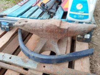

  6. Hey guys, I had this picture sent to me from my brother in law who is going to a farm auction in a few days and stopped by the place yesterday to check out what was there. He saw this anvil which he said had a "75" marked on the opposite side then what's in the picture. Just wondering if anyone could tell me if they think it would be worth the $50 I told him to bid on it for me or if it's too far gone even for that price. Also if anyone happens to know if there is someone in the central Alberta area that can repair an anvil properly. I've been checking it out on this site and it doesn't seem to be something I would want to attempt. Thanks in advance
