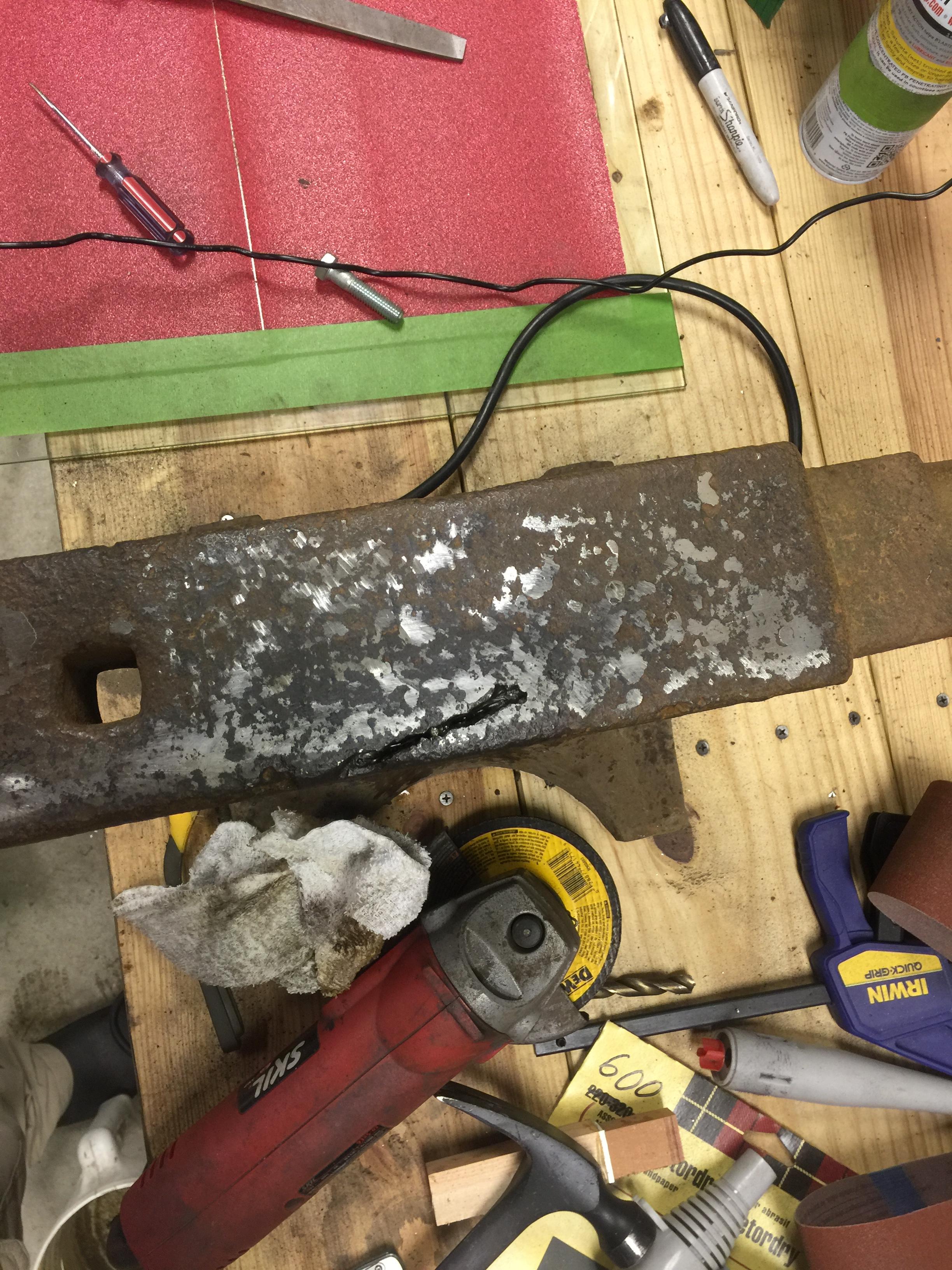

  1. WNC Goater: that's a good question. I know your not gonna believe me when I say this but the anvil was pretty much a barn find and the owner said throw out a number for it. I told him $100 (just to start low on the price) and he said na it's not worth that much, I'll take $75 for it. Of course with me being new to smithing I didn't really know what I had till I got it home and started researching on it.
  2. Scrambler82- yes I've done the rebound test with a ball bearing and it rebounds right around 75-80 percent of the height in which I drop it. ThomasPowers- yes I'm in the USA, central Arkansas. the anvil other than the cut is in mostly great shape. The corners are mostly all there and has a beautiful ring when tapped with a hammer
  3. Thank you for the quick response. I wasn't sure if it had a welded on top or not but I'm glad to hear that it's not. I will definitely take your advice and start pounding some metal.
