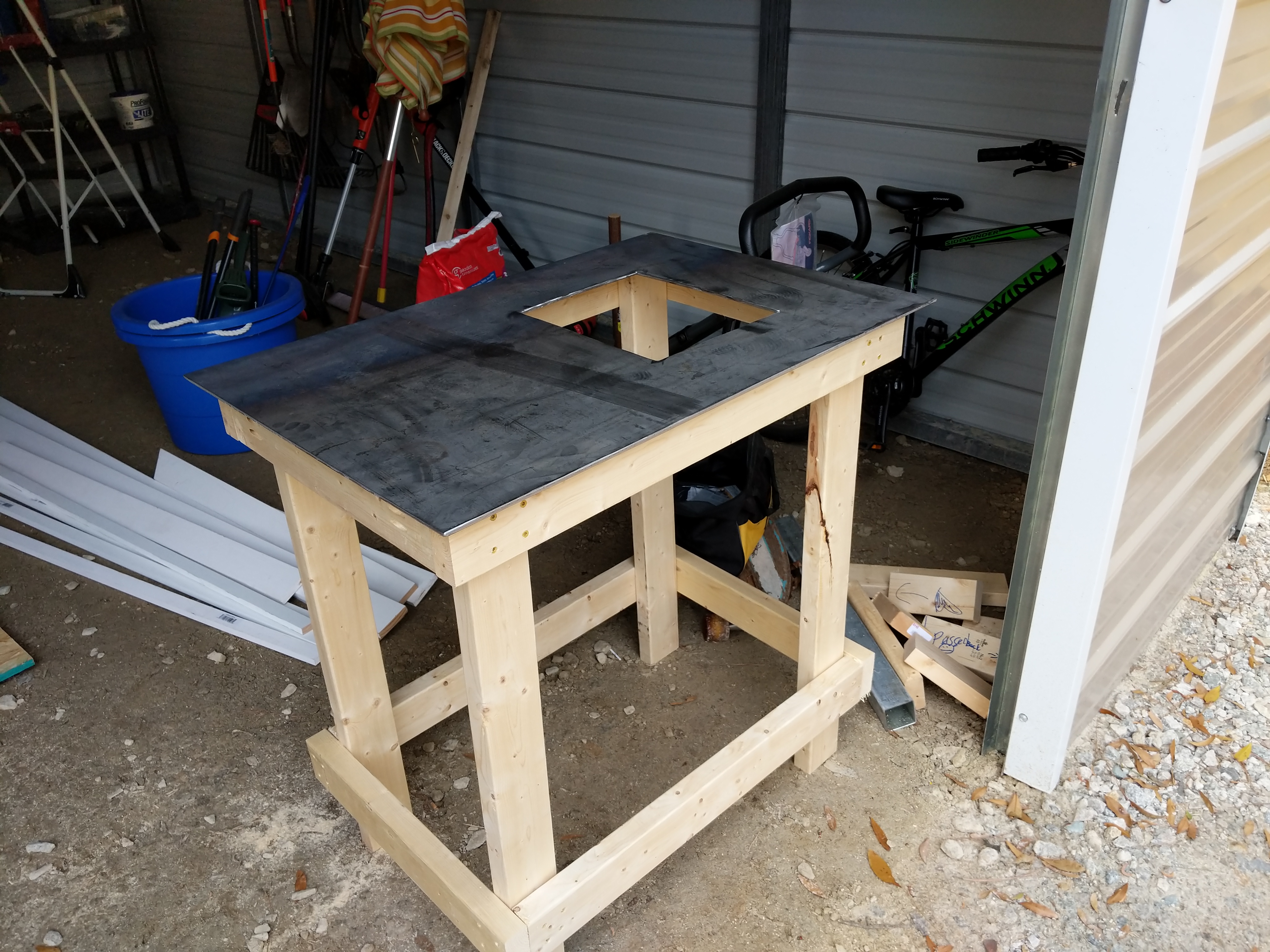

  1. Well I just bought the 1/4" before I read this ha ha! Oh well. Better too much than too little, right? Now I just need to wait for the firepot to come in. I probably could have made it a bit bigger, but I think 24"x36" should be good for my first forge. I don't think I will be making anything too big to start out.
  2. Thank you all for your ideas and insight. For the sake of my sanity (and pocket book), I will probably just go with the 1/4" steel hearth and 2x4's idea to get started. Eventually I can fabricate a more permanent solution for the stand itself. Too true!
  3. I have just purchased a fabricated steel firepot from a gentleman online. I am waiting for it to arrive and I am hoping to have the forge base completed soon. The problem? I don't have a welder and I am not looking to purchase one (at this time). I know I could find someone i know who welds, but I was curious if anyone had any ideas for possibly using angle iron/square tubing/ sheet metal to create a base for my firepot to sit in. I have an angle grinder for cutting, I am just unsure if a bolt together forge would hold up to the abuse that a forge goes through. If anyone has any ideas or opinions on the matter, I am all ears. Thank you!
