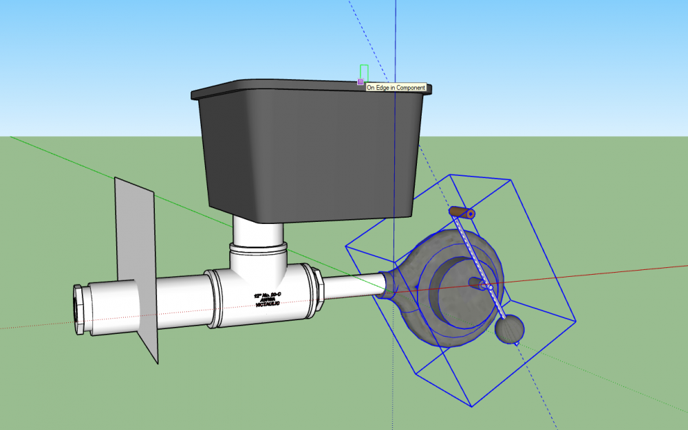

  3. Cheers Frosty. I hope we are on the same page, just done a quick sketchup model of what i was thinking. Using it's own fluid dynamics to exchange hot and cold water circulation, hopefully. But the size of the water tank is the next question, i've heard by the end of a forging session people have said it's been boiling, i don't want to run to waste from a garden hose, but also i don't mind topping up every hour either, just don't want it to be too big or heavy, so was thinking 2 litres?
  4. Thanks frosty, yeah i've done a bit of arc welding and know the dangers of the coatings they put on and yes always where a respirator when grinding any metal. Maybe thats why i haven't seen that fella carrying on with his SS tuyere then, i knew when welding the fumes are not good, but i thought that was due to the metal actually being molten and not just really hot, great advice. So then the KISS method then, maybe malleable iron pipe 2" with a 3/4" reducing bush, and 3/4" pipe running through the middle for the air, a T fitting at the other end with another 3/4" bush for the air pipe to come out of attached to a small water tank sounds doable then? Over here in the UK you type in black pipe and it's more malleable iron or galvanised that comes up in the searches so just double checking. Iron Dwarf, once again i thank you for your kindness with inviting me to see you in action, i really appreciate that. I had my daughter today, and i think if i was building something other than a small forge to get started out on, that's portable and will only be used once or twice a month i would defiantly take you up on your offer. It has been a lovely day for it, i hope the event went down well. Many thanks again.
