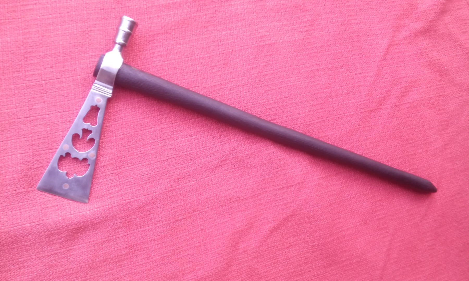

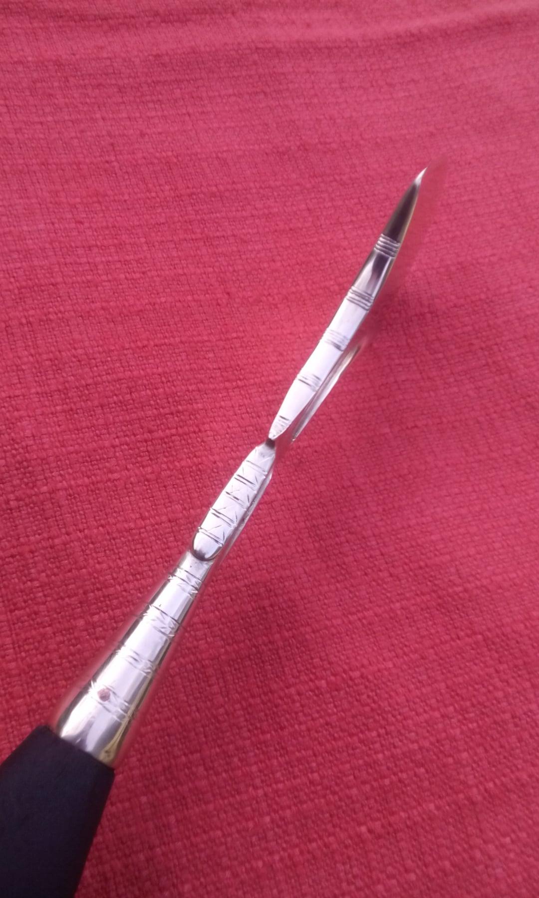

  1. My reconstruction. Iron length 23.5 cm, blade width 6 cm, weight 235 grams. Total length 53 cm, total weight 500 grams. Copper inlay.

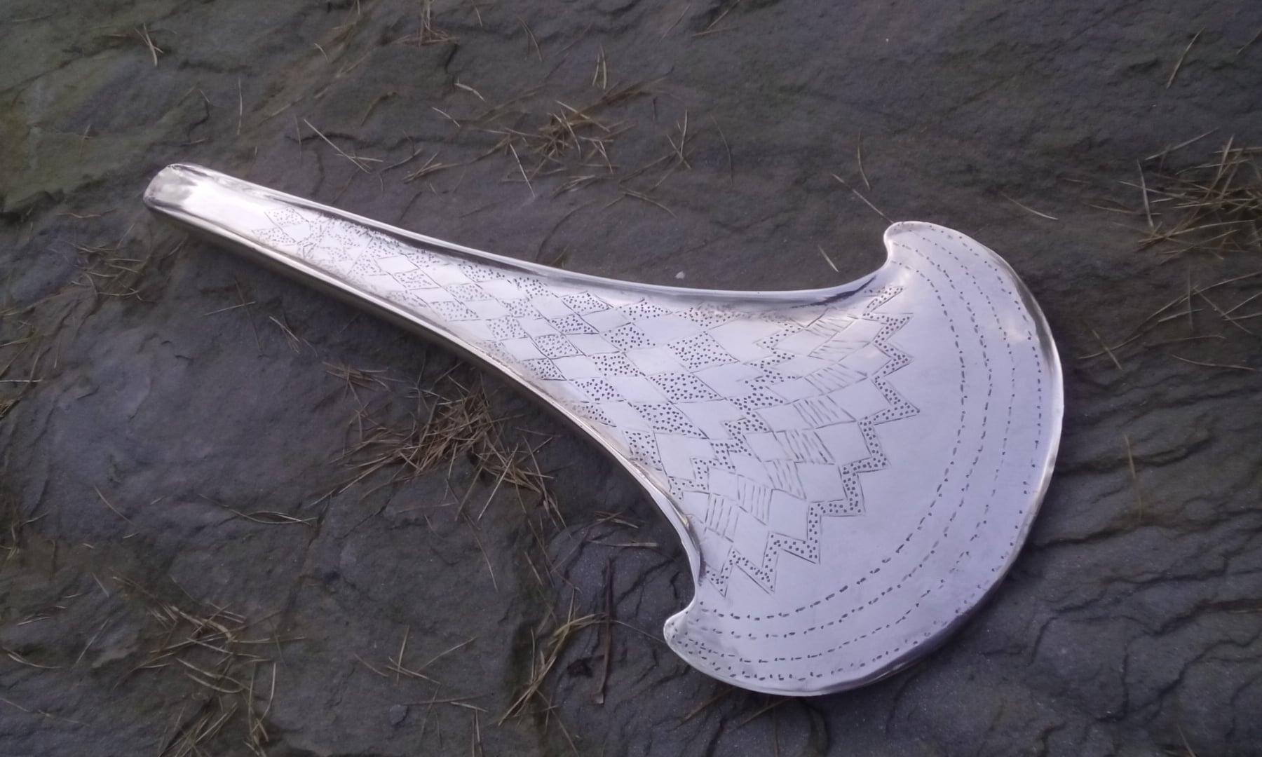

  2. Thank you gentlemen, George N.M. is tin bronze with a small amount of silicon,that's right, I do everything by hand with files, punches and whetstones, large grinding stones.
  3. Several new bronze blades. The Bronze Age in the Carpathians....Poland, Ukraine, Slovakia, Romania, Hungary. Dating ... wide ... between 1700 B.C. and 1100 B.C
  4. Thanks Gentlemen. George, this pattern, as well as all others made on bronze or iron, engraves by hand a sharpened piece of iron wire with a stylus. I deal with experimental archeology, so I naturally use tools, both stone and bronze. In the case of bronze stocked axes, in my opinion, they fulfill their tasks very well, both as a tool and a weapon. Of course, the technique of using them for e.g. processing hard wood (oak, beech, ash, etc.) is completely different than that of a modern ax.

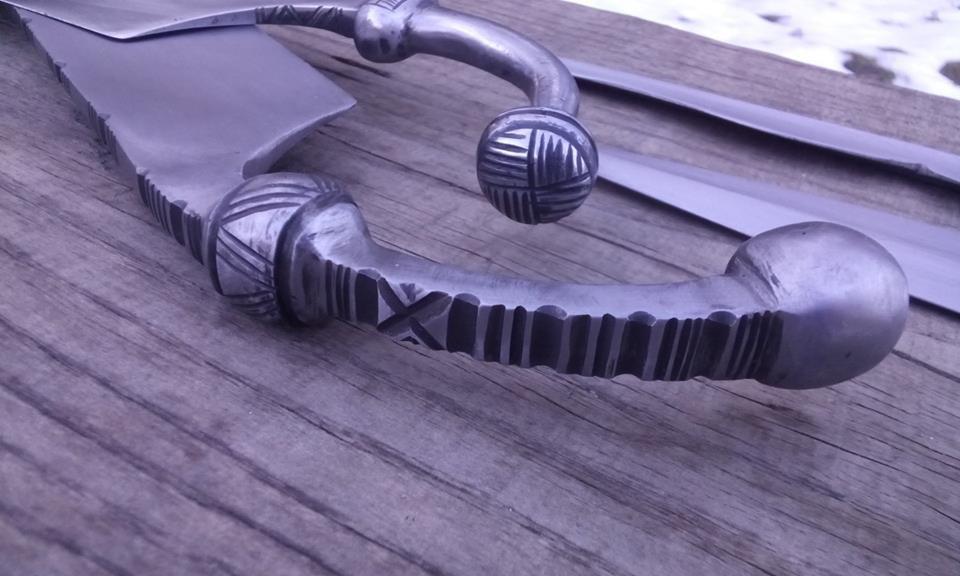

  14. Thanks Frosty! These knives were used in the period of La Tene, mainly in the Eastern Celts, although they are also found in Germany. In many books they are described as "ritual knives for cutting meat" ..... I strongly disagree with that! The way the handpiece is made proves it! The handles are very short and have two balls, they are adapted to hold them in two fingers and ask for cut punches, from above in a large or opposite way. To cut the meat you need a much better grip, with all your hand !!

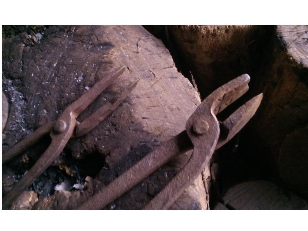

  18. Frosty, I have two small pliers, one small, the other big.

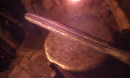

  20. The entire forging process. Thickness of the rod 20mm. Initially 27 cm with the sleeve ..... stretched to 40 cm length of the entire spear. ....and here is Celtic iron ... Spears from the left; Asymmetric, 42 cm, width 5 cm, hole 22 mm, weight 390 grams. Wide, 46 cm, width 7.5 cm, hole 19 mm, weight 450 grams. Asymmetric 35,5 cm, width 5 cm, hole 22 mm, weight 300 grams. Long, thin, 51 cm, width 4 cm, hole 20 mm, weight 400 grams. Long, asymmetrical 55,5 cm, width 5 cm, hole 24 mm, weight 460 grams. Last asymmetric 35 cm, width 4 cm, hole 20 mm, weight 290 gram. Knife behind the decorated ridge 52 cm, width 4.5 cm, weight 460 grams. The second knife 50.5 cm, width 5.5 cm, weight 480 grams. ZERO ELECTRIC WELDING! ZERO POWER HAMMER! EVERYTHING HAND FORGED FROM ONE PIECE OF IRON ... and a little more ...
  21. Thanks! If the handle is fitted to your hand, it's great! The balls provide a good grip and secure grip when taking a blow, no matter what, cutting or stabbing.
