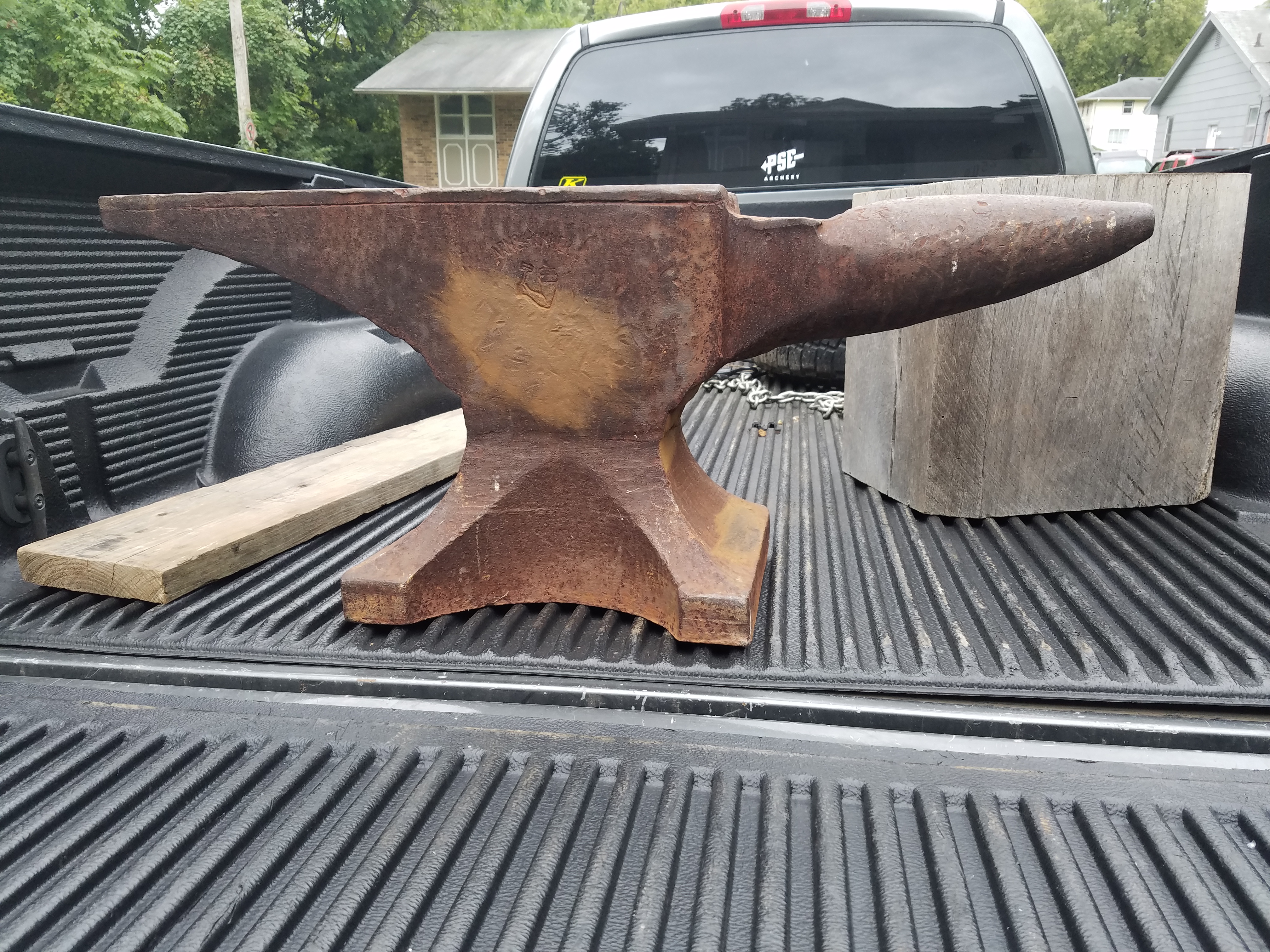

  9. Just the mold is the dipper from what I can tell from the video. The hammer, ladle, and tongs are tools I'll be using on the anvil. so that's not going to be a problem. The mold would tell the story with a visual fit - that's why I'm interested in one.
  10. Agreed, this is long term wear pattern. She came from Granite City Steel in Ill. Would just a ladle be used to take samples? I saw a video from there where they used the RR track running through to knock the sample loose....I was hoping to see my anvil The fella I got this from said it was a loop shaped thing with ceramic tube???? I've got no idea what he's referring to though. I'd love to find one or something similar.
  11. I just purchased a pretty nice anvil. The story is this big girl was rescued from an old open hearth steel mill. Each hearth had one by it which they used to knock the samples out of the tool they used to take samples. I have done a search on any terms I can think of, but no where can I find anything like what I'm looking for. I'd LOVE to have even a worn out one of these to keep with the anvil. Here's a pic of the damage the anvil took over the years doing this job. Does the imprint look familiar? Can you help me decipher exactly what this is from?
  12. Did a little work with the wire wheel tonight, and verified there is a 4 in front....well, half of one anyway. Is the early 40's as close as your informatoin gets for a date?
  13. With the knowledge on here, would anyone know what they were knocking the samples out of on this anvil? I'd love to even find an old one to keep with the anvil. I've seen some old video, but never an example of these.
  14. Assuming that is a 4, what year would you guess this to be?
  15. Took a look at the back side, and nothing but a blank canvas as near as I can tell. I may find something else in the cleaning though.
